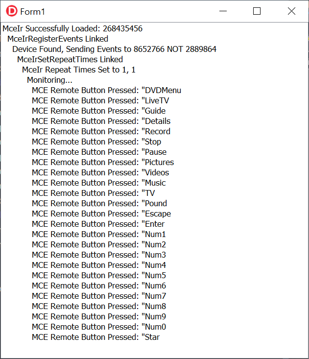

I ended up installing EventGhost plus the source code, and have been playing around with it.
In EventGhost I could install the MCE Remote plugin and monitor for MCE button presses, even those not configured, which is freaking awesome. But this only works if I run EventGhost as Administrator.
I've created a new test app, and I'm hooking it to the MceIr.dll that is used by that plugin, using the EventGhost source code for reference. While it seems to load up and interact with the MceIr.dll okay, I never get any messages from it, even when I run my test app as Administrator. I'm currently troubleshooting this, trying to figure out why it's not working. If I can get this to work, then this would make a great foundation for a MCE remote monitor app.
Re: Considering New App - Hotkey Monitor
Woohoo! I just got it to work! Once I passed the correct Windows Handle to the MceIr.dll, and ran my test app as Administrator, I started receiving all the MCE button presses!
It's working even better than I could have hoped. I was only hoping to get the special media buttons like GUIDE or VIDEOS or RECORD, but it actually gives me every last button pressed on the remote. I always thought the generic buttons, like the numberpad, were treated as regular keyboard input (in fact, that's how CMC sees it). I had not idea I could separate MCE numbers separate from keyboard numbers. When I press keyboard characters, nothing happens, so everything in this screenshot came from the MCE remote.
The downside is that this is now restricted to just MCE Remotes. Jamie recently mentioned he was using a keyboard, and this type of solution may not work for that input method (unless it's an MCE Keyboard... I have one of those somewhere, need to test it.
The other cool thing is that my test app is receiving MCE Remote button presses even after I launch CMC. So it's receiving everything in the background, nice!!!
