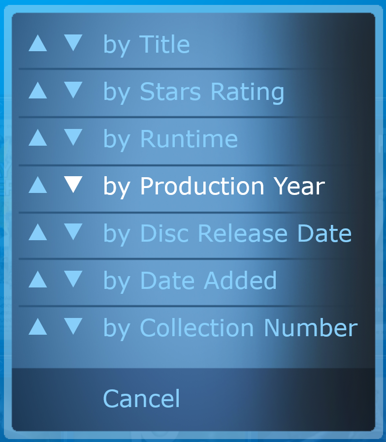

There's also a sort by Production Year, which it sounds like you are manually recreating by putting the production year into the disc release date field, though perhaps you are being more specific and using the exact theatrical release date instead of just a year.

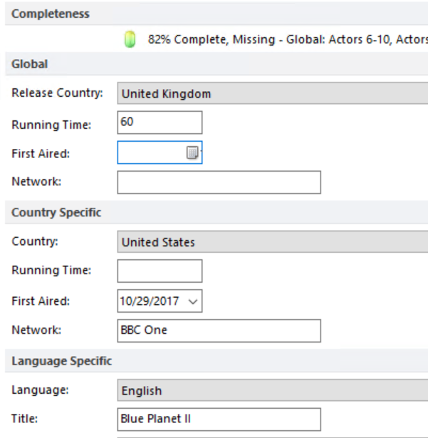

One tip, I noticed that a few of my TV Series were still not sorting correctly. When I checked, I found that the Global First Aired date was blank, and that there was only a Country Specific First Aired date:
You will need to make sure the Global First Aired date is populated, as that is what CMC is using. Update below.

Post by Pauven » Mon Jan 20, 2020 11:13 am
Correction on that last tip: I have fixed CMC to pull the date from the Country Specific section if it is missing in the Global.
But if you don't have any episodes mapped, then MMCM won't display the [+] to expand the Title and show the Series info, and it won't be exported by CME either, so the Release Date will be blank in CMC and sorting won't work.
So mapping episodes (at least 1 episode) is a hard requirement for TV Series to sort by Release Date.
