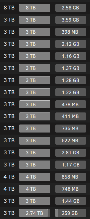

This is why I always try to leave 500 MB to 2 GB free on every disk, so that any movie metadata written to those same directories on the disk don't run out of space.
I keep my Min Free Space limits high enough so I don't have to think about it, but that also means that eventually if I want to fill up a disk I'll have to do it manually. So once I get down to around the 50-60 GB level (which is where my DVD share will get me), I'll grab a stack of discs to rip, and use a spreadsheet and log how big each disc is before I rip them. Then I will rip a combination of movies that gets me into that 500-2000 MB range of space remaining. Sure, it's manual and a bit of a pain, but it's only something I bother with on rare occasions. As you can see, my extra effort has allowed me to get the most out of my disk space.
