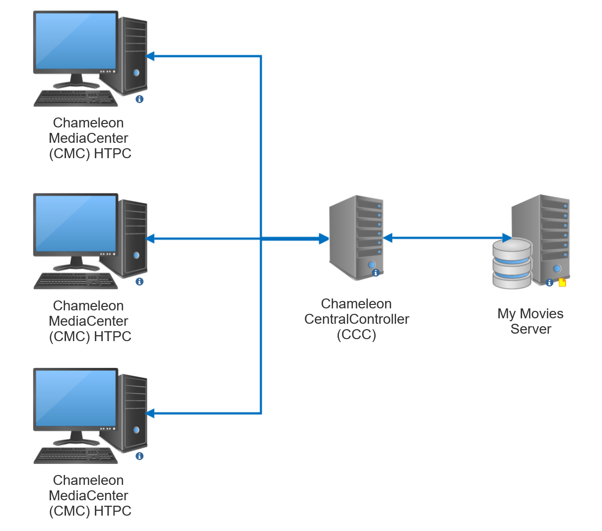

Chameleon CentralController, abbreviated as CCC, is a standalone app that sits between Chameleon MediaCenter (CMC) and My Movies (MM).
The primary purpose of CCC is to extract your My Movies collection, pre-format it for CMC, and share the exported data with all of your CMC PC's.

CCC only has to process the exported metadata once for all CMC HTPC's in your home
CMC directly connects to CCC to bi-directionally sync all data (movies data, watched history, user accounts)

The solution is to place a single CCC instance in the middle, that way only a single client is every communicating with the My Movies API service, eliminating resource contention, and allowing multiple CMC HTPC's to talk to the single CCC instance simultaneously.
