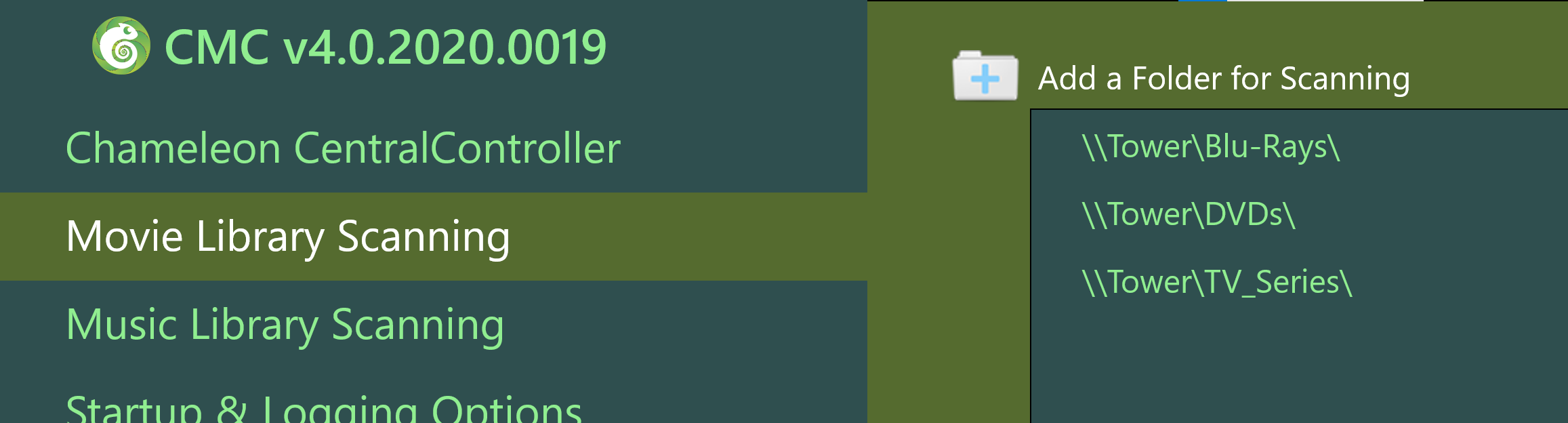

Since v1.0 of CMC, there has only been a single "operational mode", so this will be a new concept for existing users. That sole operating mode was Folder Scanning. You would configure one or more folders for scanning in the "Movie Library Scanning" section in CMC's settings:
You would then run a Sync, and CMC would scan your media folders, one-by-one, finding all your playable media and importing your collection data from the XML metadata files.

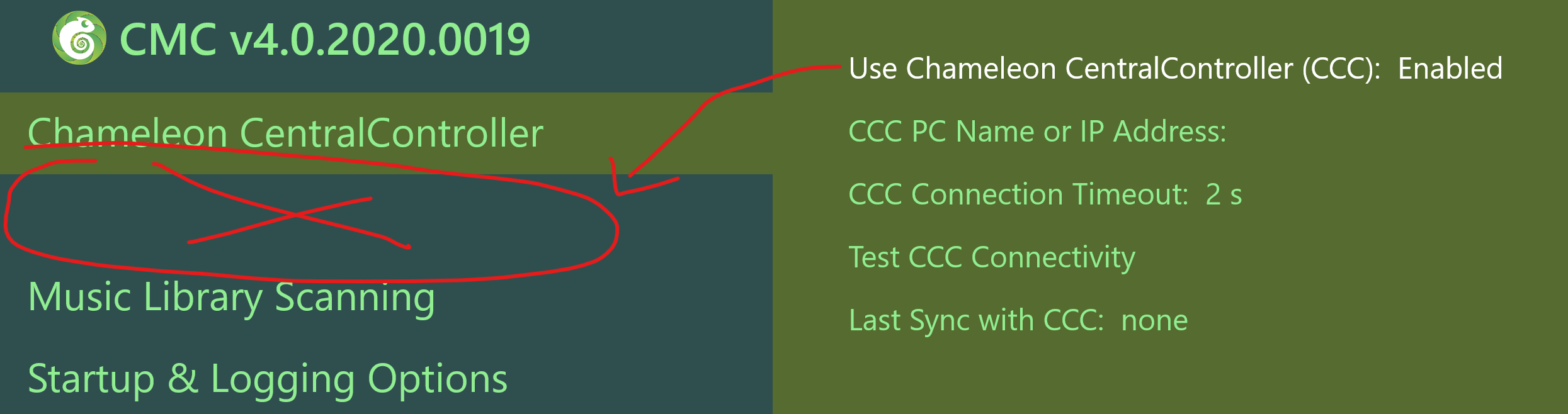

It is extremely easy to configure the CCC connection. In CMC, go to the Settings, and select the new option at the top, Chameleon CentralController:

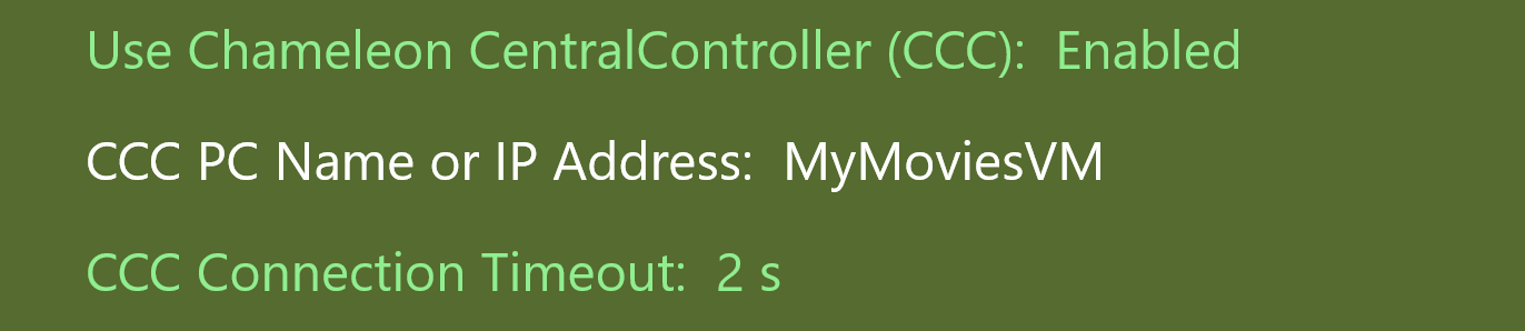

To place CMC in the CCC operational mode, simply Enable the first option, "Use Chameleon CentralController (CCC)". Notice that when Use CCC is enabled, the 2nd menu option on the left, "Movie Library Scanning", disappears.
The next step is to enter the PC name (or IP address) of the PC where CCC is running. If CCC is running on the same PC you are using, enter localhost, otherwise you need to provide the Windows configured name of the remote PC. I have a dedicated Windows virtual machine named "MyMoviesVM" running on my Unraid storage server where I have installed My Movies and CCC, so I will enter that value.
  • TIP: Be sure to press ENTER after typing in the name or IP address!

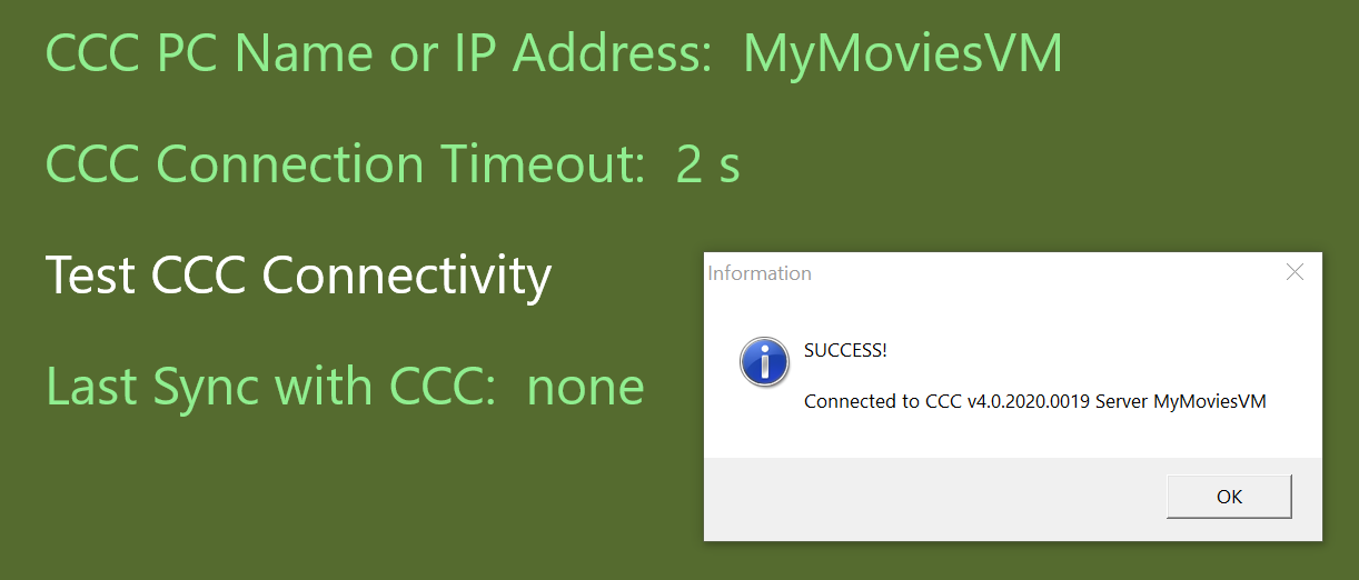

The next option is the "CCC Connection Timeout", which by default is set to 2 seconds. This is probably fine for most home networks, but if you get occasional random timeouts you may want to try increasing this value, 1 second at a time, until the issue is fixed.
The configuration is now done (that was pretty easy, right!?), but you should test it to make sure it is working. Click the "Test CCC Connectivity" button, and CMC will check if it is able to communicate with CCC. Hopefully you get a "SUCCESS!" message like this:
:!: If you get an error, please review the 202 - Troubleshooting Connectivity Issues tutorial, which covers common errors and how to fix them, plus instructions for configuring your PC's firewall rules if needed.
TIP: The last row, "Last Sync with CCC", is not a setting, but just troubleshooting info. It probably reads "none" now, as shown in the screenshots above. Later, it will be a timestamp showing the most recent time CMC successfully synced with CCC. If you think new collection data isn't showing up correctly in CMC, then this date value may provide a valuable clue.
