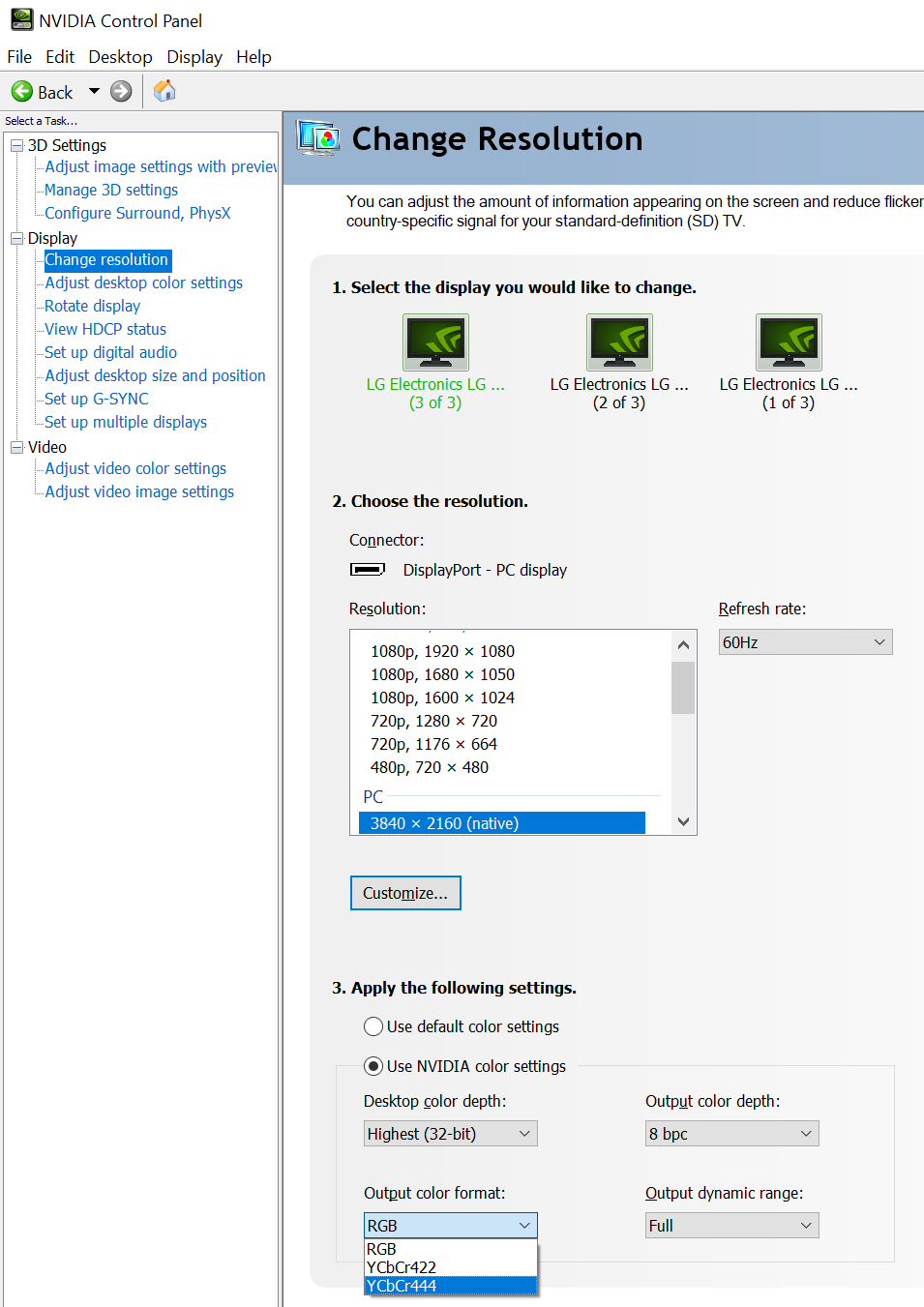

When you mentioned banding, my first thought was the bit-depth settings in the AMD drivers. In some modes, I get horrible banding / posterization. I think there are 4 modes to choose from on AMD, things to look for include settings for 4:2:2, 4:4:4, RGB, 8-bit, 10-bit. I tried all the various combos, and found that certain modes look really good. I think it's related to TV/monitor limitations, if you send them the wrong mode, they can't map the colors right, and you get bad artifacts. Sorry, I don't have an AMD machine at my fingertips at the moment to show a screenshot.
Below is what similar settings look like on nVidia. The Output Color Depth and the Output Color Format will have the biggest impact on banding/posterization. Output Dynamic Range is related to IRE, and you should definitely be using Full range on a modern TV or monitor.
