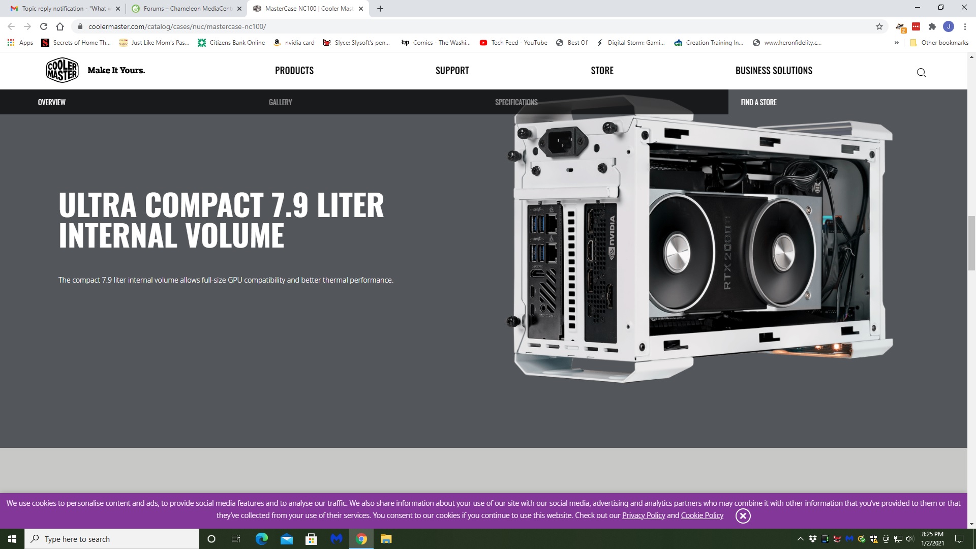

Jamie wrote: Sat Jan 02, 2021 6:41 pm Okay, can a guy change his mind. I like this NUC case.
https://www.coolermaster.com/catalog/ca ... ase-nc100/
Careful, that case does NOT take a motherboard. It takes a NUC Compute Element, which is a mainboard that looks more like a video card, and slots into the case like a video card.
I agree, it's nice, but it's completely different than everything else.
My personal vote is for the Silverstone, even though it is the least sexy, simply because the end result is an all-in-one solution with the Blu-ray drive included. But if that isn't important for you, then everything except # 5 (the special NUC Compute Element case) could be nice.

Yes, the silverstone is on my mind and the modules for the NUC do not appear to be easy to obtain. They came out in 2019 and there hasn't been any upgrade for the series 10 which came out recently.
The Nvidia GPU is on the other side. The GPU is separate and one of the few upgradable parts. I have to order a NUC module to finish the build for the CPU, RAM, and other components. I worried that they don't support ethernet.

These are the final 3 choices. Yes that NUC case still intrigues me but it limits a lot of my options. The only real part that can be changed is the GPU. All the other parts are part of a module.

okay, I have ruled out the NUC case and components. None the the boards and elements for the NUC meet my objectives, do not support an ability to do later upgrades, and are expensive for what you buy.

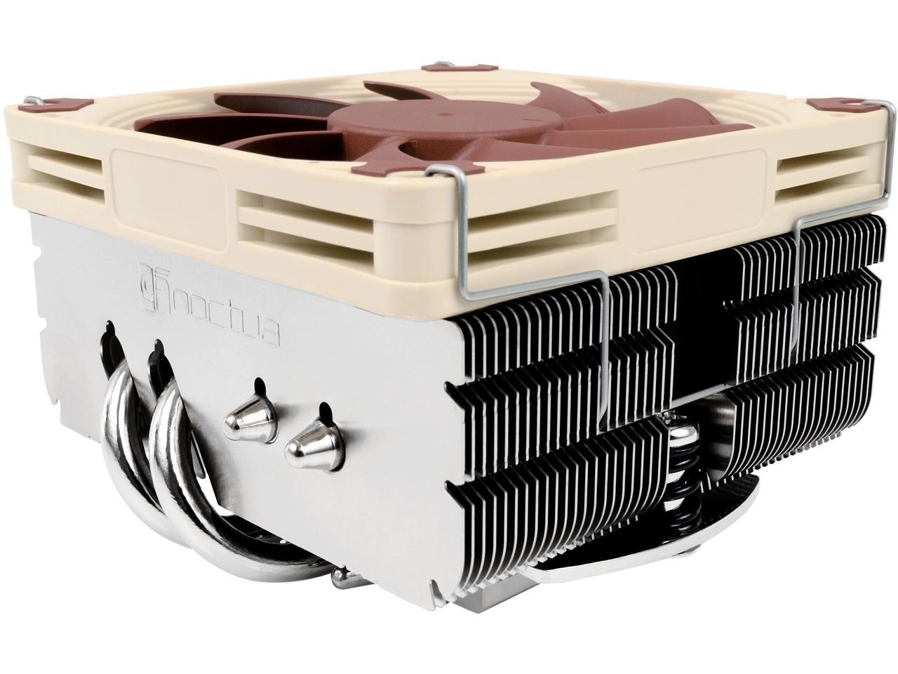

That was a surprisingly helpful video case review. Makes me want to get one too. I disagree with his assessment that 2x 80mm fans for rear exhaust is recommended. 80mm's are quite a bit noisier, and with 3x 120mm fans all configured for intake, you've essentially got a positive pressure case that will naturally exhaust air out the back.
To prevent from having to replace the left side 120mm fan with a smaller 80mm fan, be sure to choose one of the new shorter length ATX power supplies - not all power ATX supplies are the same size!
For cooling, you'll definitely need to plan on a low-height aftermarket cooler. If you go with an Intel CPU, it probably won't come with a cooler, and regardless any cooler that comes with AMD or optionally Intel CPU's is probably going to be higher than 80MM.
If you go to Newegg.com and browse to CPU coolers, you can filter by height (be sure to click that down-arrow next to the 60mm to 89mm for specific options). One thing to keep in mind is that you probably don't want to get a 70mm height cooler, as it may have airflow blocked.
If you asked me for a recommended cooler, I'd probably go with the Noctua NH-L9x65. Noctua makes awesome coolers and some of the best fans:

I will probably go with your advice and get the cooler you recommended. I was wondering what you thought about this cooler recommended by silverstone? They are compatible with Intel or AMD.
https://www.silverstonetek.com/legacy.p ... del=NT01-E
https://www.silverstonetek.com/legacy.p ... AR02&tno=3
Re: What would make a good UHD HTPC
Post by Jamie » Mon Jan 04, 2021 6:09 pm
I'll will go with the nocturna. The Silverstone ones don't even meet the 70mm height requirement

The NT01 appears to be an offset design, and would "probably" be okay, as if correctly position then the fin stack would rise up behind the Blu-ray drive. But it uses 60mm fans, and when it comes to fans, bigger is always better (more airflow & less noise). So for HTPC use where [AMC says] "Silence is Golden", I'd probably avoid the NT01.
The Silverstone AR02 just looks too big.
