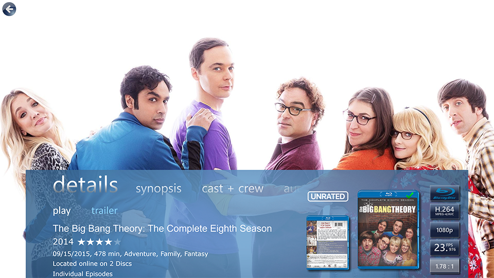

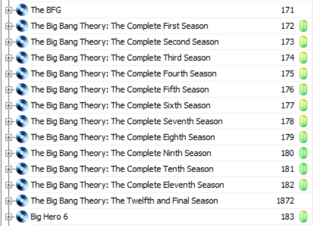

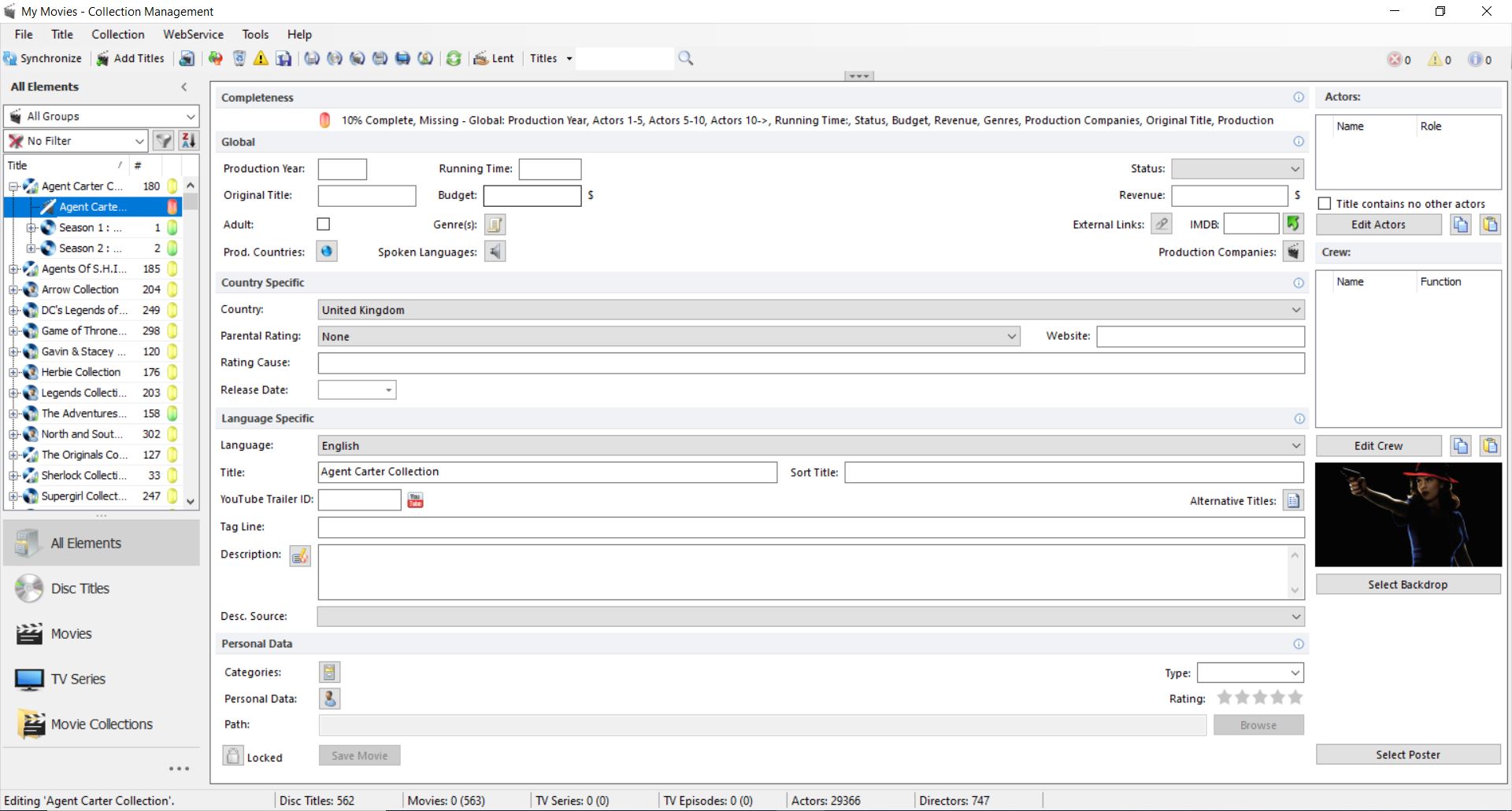

One clue is your screenshot showing Agent of Carter. I see you have created an Agent of Carter Collection, and have it as a parent of Seasons 1 and 2. This looks very unusual:
For contrast, here's all 12 seasons of The Big Bang Theory in my collection - note how each one is just a separate disc title. CMC automatically combines them together for display, so you don't have to do anything special in MM to get them to group.
In fact, as a TV Series, each disc is linked to a common TV Series ID, which is how CMC automatically groups them together. A good example of this is my Game of Thrones collection. I have Seasons 1-7 as a Box Set I purchased, and then separately I bought Season 8 (shame... shame...). Notice that I did nothing special to group Season 8 with the other seasons:
Yet in CMC there is just the single TV Series Box Set Cover:
And opening it with Enhanced TV Series View shows both titles, Season 8 and the Seasons 1-7 Box Set:
I put a lot of work in CMC to make it display the way you wanted (no Enhanced TV Series View), even though this wasn't a feature I really liked. But for this to work correctly, you need to stop trying to trick CMC into working the way you want, and instead just use MM normally as I showed above. You will need to have your TV Series marked as TV Series, and link them to the actual TV Series, so that CMC can group them together for you in the legacy Box Set View.

So I attempted to replicate your actions using my Season 1 disc title of True Detective. When I right-click on the title in the list pane, the "Create Movie" option is disabled:Pauven wrote: Fri Feb 12, 2021 10:40 amI didn't realize this was possible. As it's not there by default, if CCC attempts to retrieve it the API produces an error, so I had disabled that logic.RKEP wrote: Fri Feb 12, 2021 10:31 am I'm a little puzzled with issue 2. I'm not saying your wrong but even with TV series, if page 2 is'nt there you can right click the title in the list pane and "Create Movie" this gives you page 2 and you can add a FanArt of your own as you can see in IMG 001. This is the same as a movie so its a bit odd the artwork is missing when It is clearly in MM database GUI.
I'll look into this.

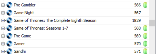

It seems that this is only working because you are not treating your TV Series disc titles as TV Series.
As I wrote in my previous post, for the correct grouping of TV Series as Box Sets, even with Enhanced TV Series View disable, you must still treat these discs as TV Series. Once you start doing this correctly, you will no longer be able to do the "Create Movie" trick, and you won't be able to assign custom FanArt.
All that said, one thing I failed to mention in my earlier post is that I made a change (in v4.0 if I recall correctly) to show the TV Series Backdrop as the FanArt for each disc title in a TV Series. For example, here's my The Big Bang Theory Season 8 disc, and it does show FanArt:
The only downside to this is that since there is only one TV Series Backdrop for the entire series, the same FanArt is shown for all disc titles.
