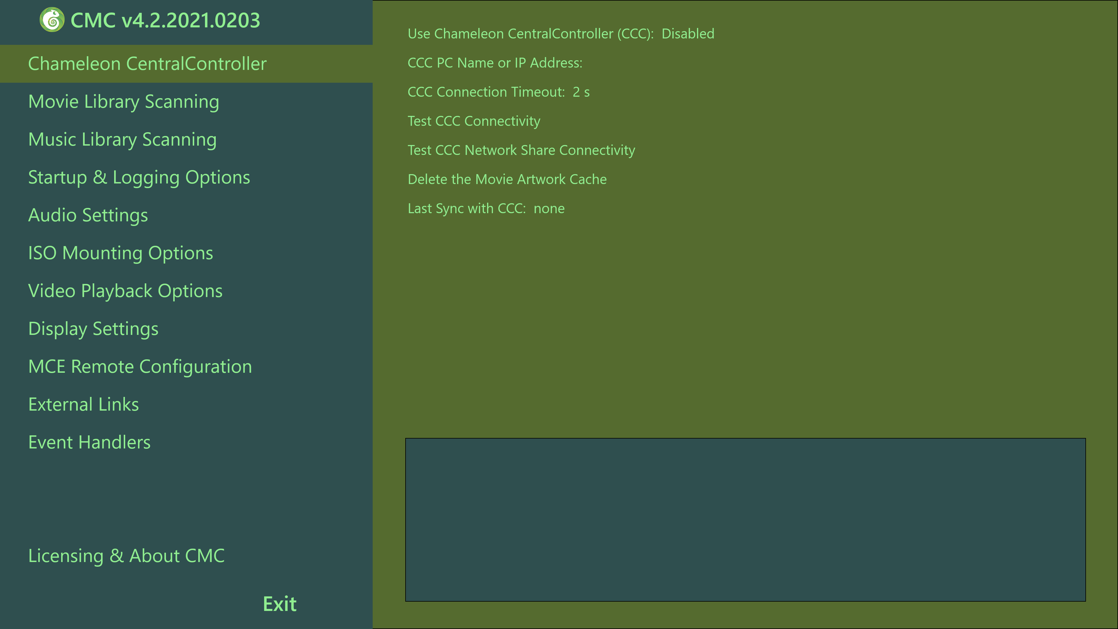

Do you happen to have CMC configured for CCC?

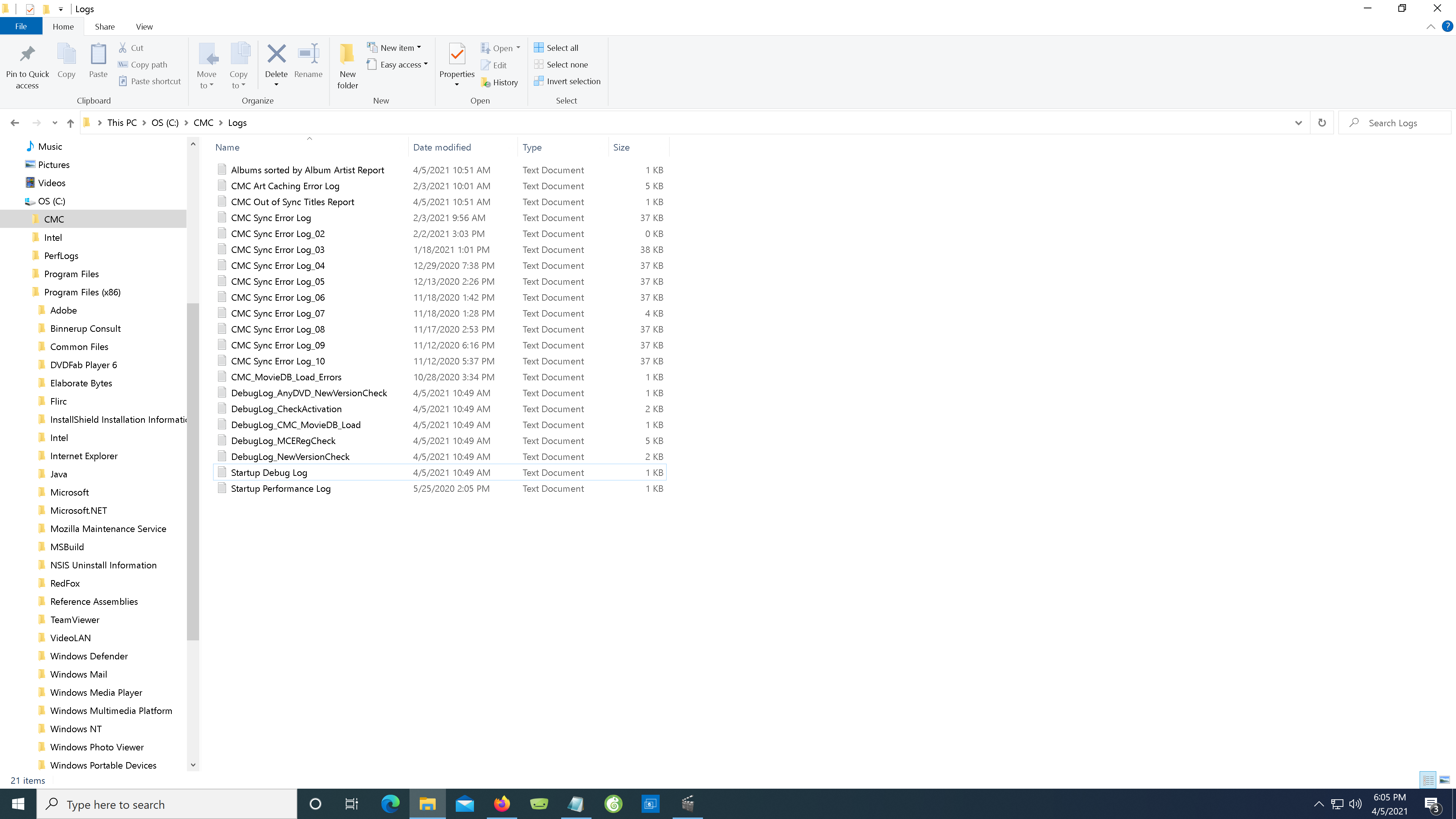

Debug was enabled, in fact I ran two full syncs one with debugging enabled and one without.
I have attached a screenshot of the Logs folder. There is no sync error log for today. If there is another log file you need to see let me know.
CMC is not configured for CCC. See second screenshot.

Re: New movies i MyMovies DB not displaying in CMC
Very odd. Seems like a sync isn't actually running.
How does the Full Sync behave when you run it?

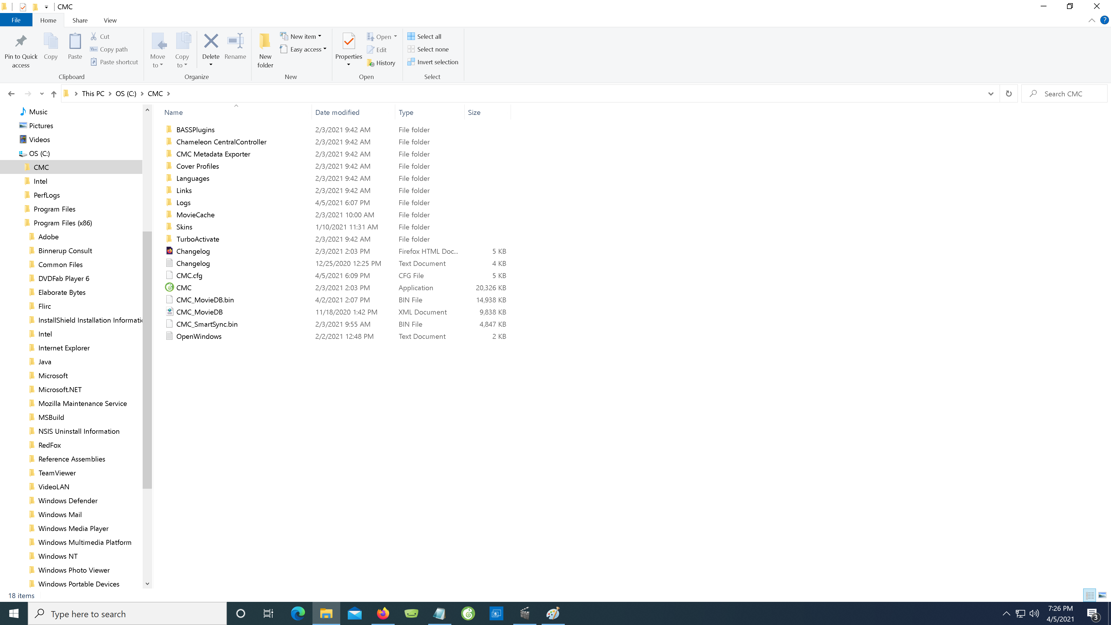

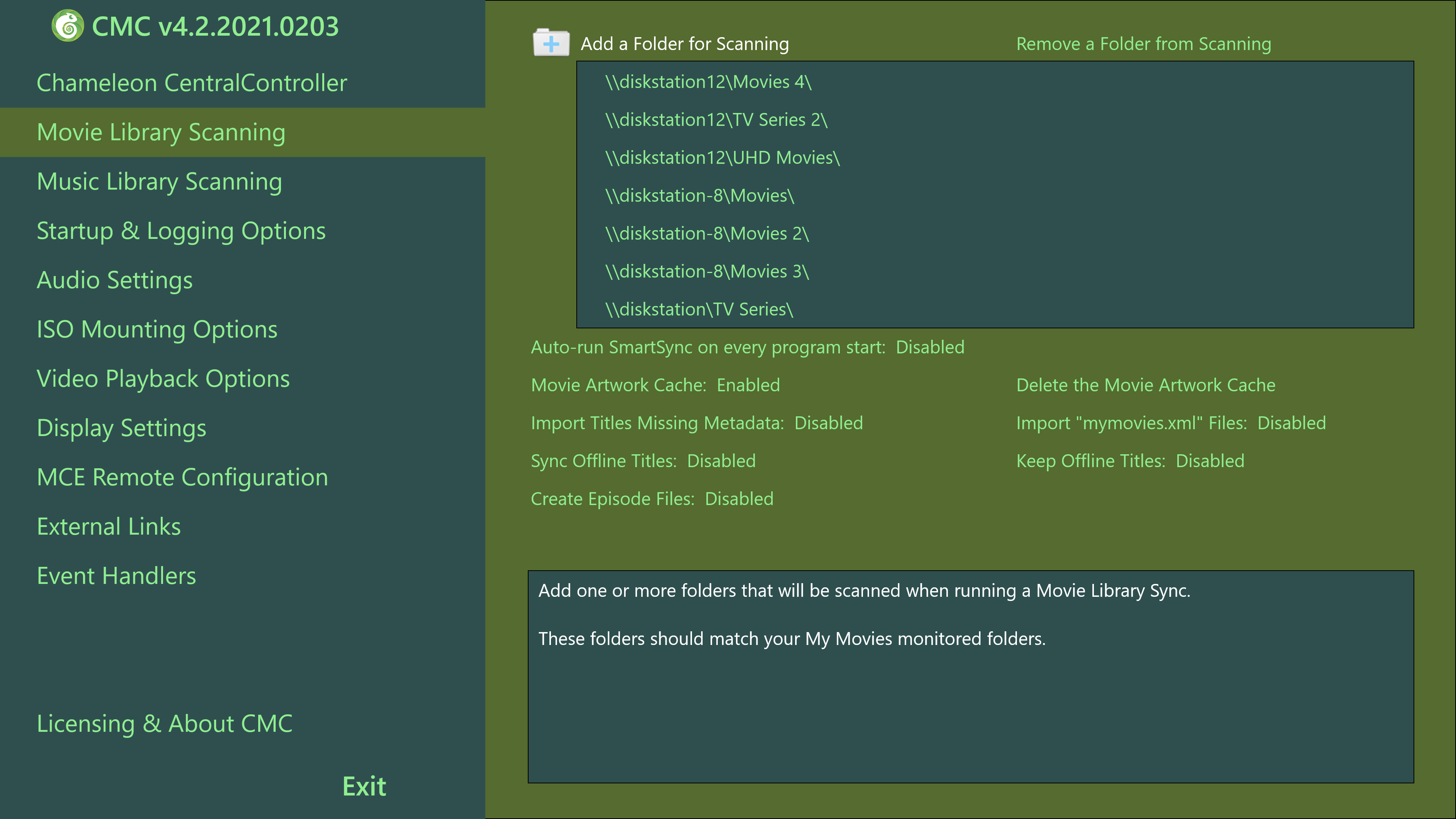

Please provide a screenshot of your Movie Library Scanning configuration page. And a screenshot of your main CMC program folder.

Full sync behavior appears normal. Scans through all the movie and TV folders in the scan configuration. The scan folder configuration has not changed since CMC was installed. A full scan takes about 2 hours.
Interesting. A sync hasn't run since Feb 3, the same day I released v4.2. Did you upgrade immediately?
I'm thinking I broke something in v4.2. I'll have to do some investigation.
