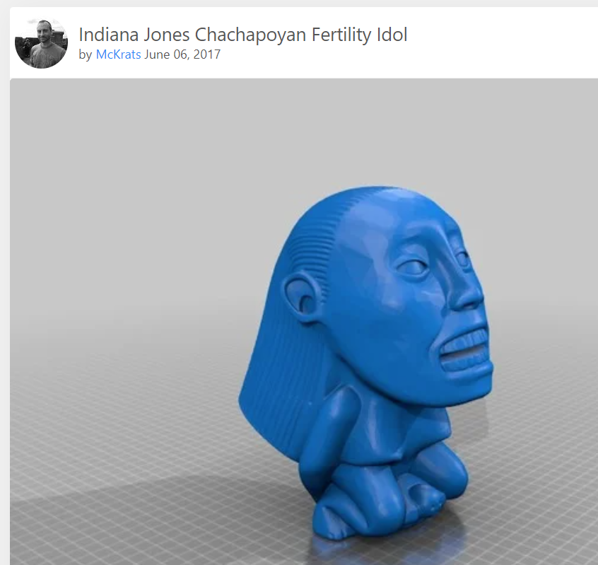

While I won't claim that I chose the best fertility idol 3D model available, I did choose the most accurate one I could find. There are surprising differences in the various models available, many of which look very different than the movie prop. I ended up choosing this Indiana Jones Chachapoyan Fertility Idol modeled by McKrats, as he seemed to have made a very strong effort to recreate the movie prop.
The only downside was that the model ended up having a slightly low polygon appearance, but as I was planning for a ton of post processing sanding to prep for gold leafing, this didn't seem a big issue. Oddly, some of the photos on that model seem to show a high-fidelity version without all the obvious polygons, but if that version exists it certainly wasn't in the downloaded files.

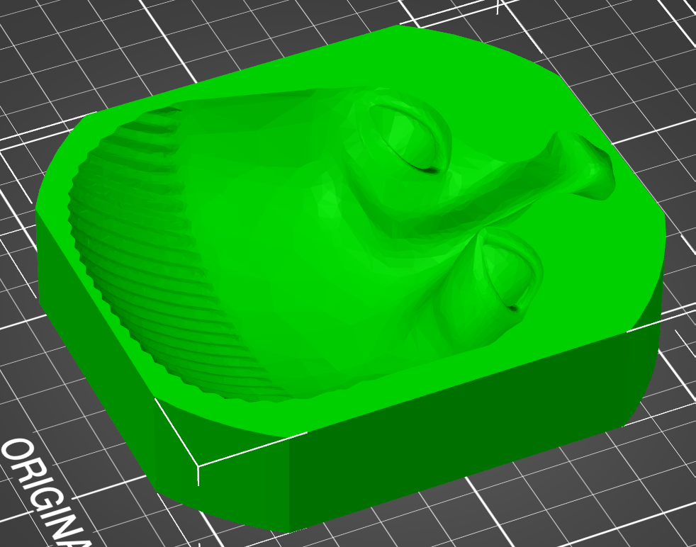

A lot of planning went into printing the statue. The model comes in two versions, one split in half down the center of the face, so that you would print the two halves separately and then glue them together. I actually printed out this version first, and then realized it would be impossible to glue them together accurately and then fill it with lead, so I would have to print the model whole in one shot.

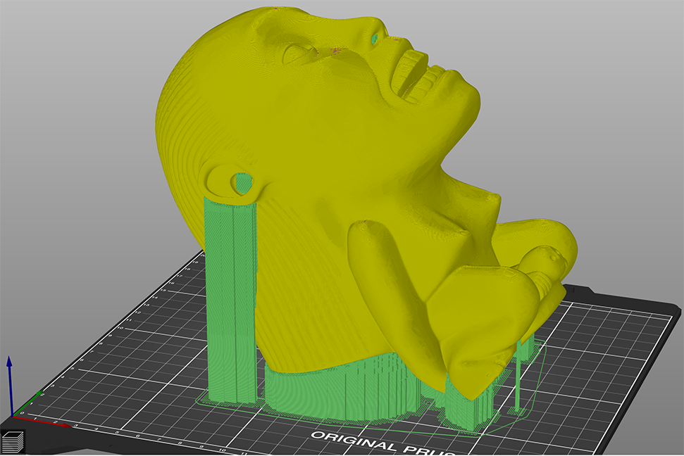

The model has a lot of overhangs, though I found that if I tilted the model backwards, so that the brow ridge and tip of the nose were roughly parallel, that most of the detailed areas would print without the need for supports. This position would require more print supports overall, but they would be focused on the bottom of the model in less visible areas. It was also around this time I began to realize just how explicit the fertility idol depicts child-birth... no wonder we really only see it from behind in the move, haha.
As you can tell, this is a fairly large model on my normal sized printer, though it easily fit within the print zone.

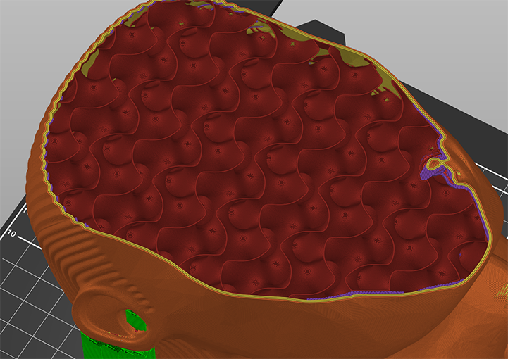

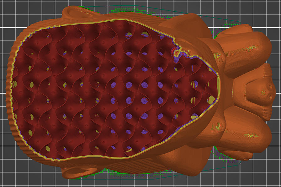

My next concern was how to print it hollow - while my positioning eliminated the need for external supports on all the facial and frontal details, it definitely didn't eliminate the need for them on the inside. I couldn't actually print it hollow at all. Instead, I chose the very special "gyroid" infill pattern, which both provides excellent support in all directions, plus has free flow for liquids in all directions.
Here you can see the gyroid infill looks pretty solid:
But from certain angles, you can see the passageways line up straight through:
Including straight down, top to bottom:
Using the gyroid infill at 5% (as shown in the images above) and 3 outer perimeters, I was able to get a successful print on the first try.

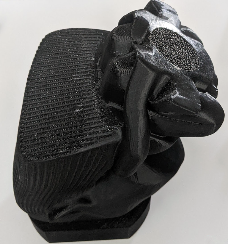

When the lead arrived, I went about doing a test fill. I drilled a 1 7/8" hole (38mm) in the bottom of the statue between the feet, and poured in a bunch of lead shot. It went in easily enough, and with some shaking I was able to fill the nooks and crannies. But it quickly became apparent that the shifting BB's inside had a bean-bag sound to it, and I didn't think I would be able to pack the statue tight enough to prevent it making noise and giving away the illusion. Even worse, I worried what would happen if the statue was dropped and broke open, sending tiny lead bb's everywhere! I decided that a good solution would be to pour in resin, which would have two benefits: gluing the lead bb's together to prevent noise, and further filling in the statue, making it even more solid and heavy.

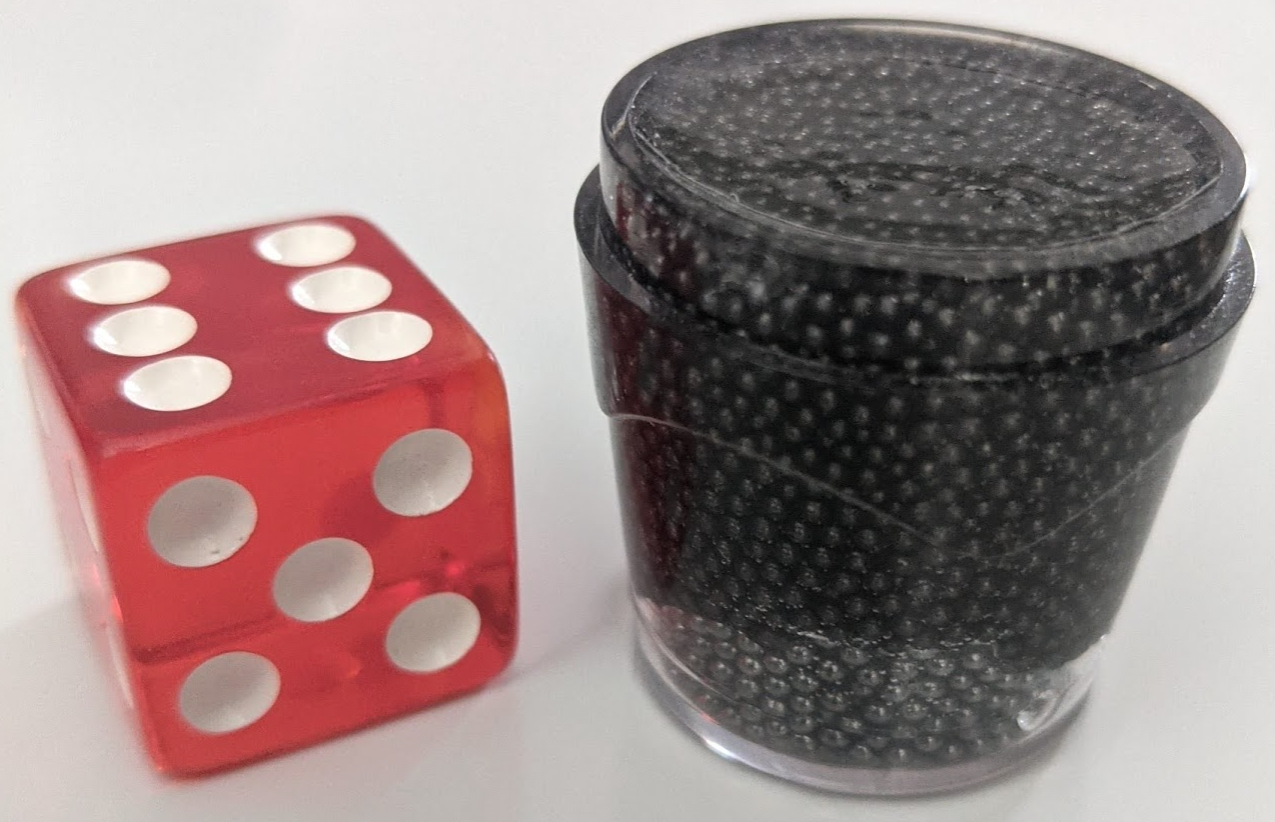

Before committing to filling the model, I decided to do a test pour in a small clear plastic cap I had kicking around. I filled it with lead shot, mixed up some resin (but without heating the resin to improve fluidity), and did a very small pour. As you can see in the picture below, the resin did not penetrate all the way down, so I had a flaw in my plan:
If the resin wasn't even fully penetrating an inch, there was no way it would properly fill in the statue if I put the lead shot in first. Instead, I figured that it would be much smarter to pour in the resin, then pour in the extremely heavy lead shot which would easily sink to the bottom.
Even though I had specially chosen the gyroid infill pattern to permit pouring liquids to all corners of the statue, I had major doubts that it would work well for pouring in lead shot, which required me to shake the statue around a lot to make it setting into the nooks and crannies even without sticky resin in the way. Luckily I discovered a solution. Using a pair of long needle nosed plyers, I was able to grab hold of the infill to twist it apart and rip it out. It was several hours of painful ripping (sharp, pokey plastic), not a pleasant job at all, but eventually I had ripped out over 90% of the infill, and the model was now almost completely hollow.
