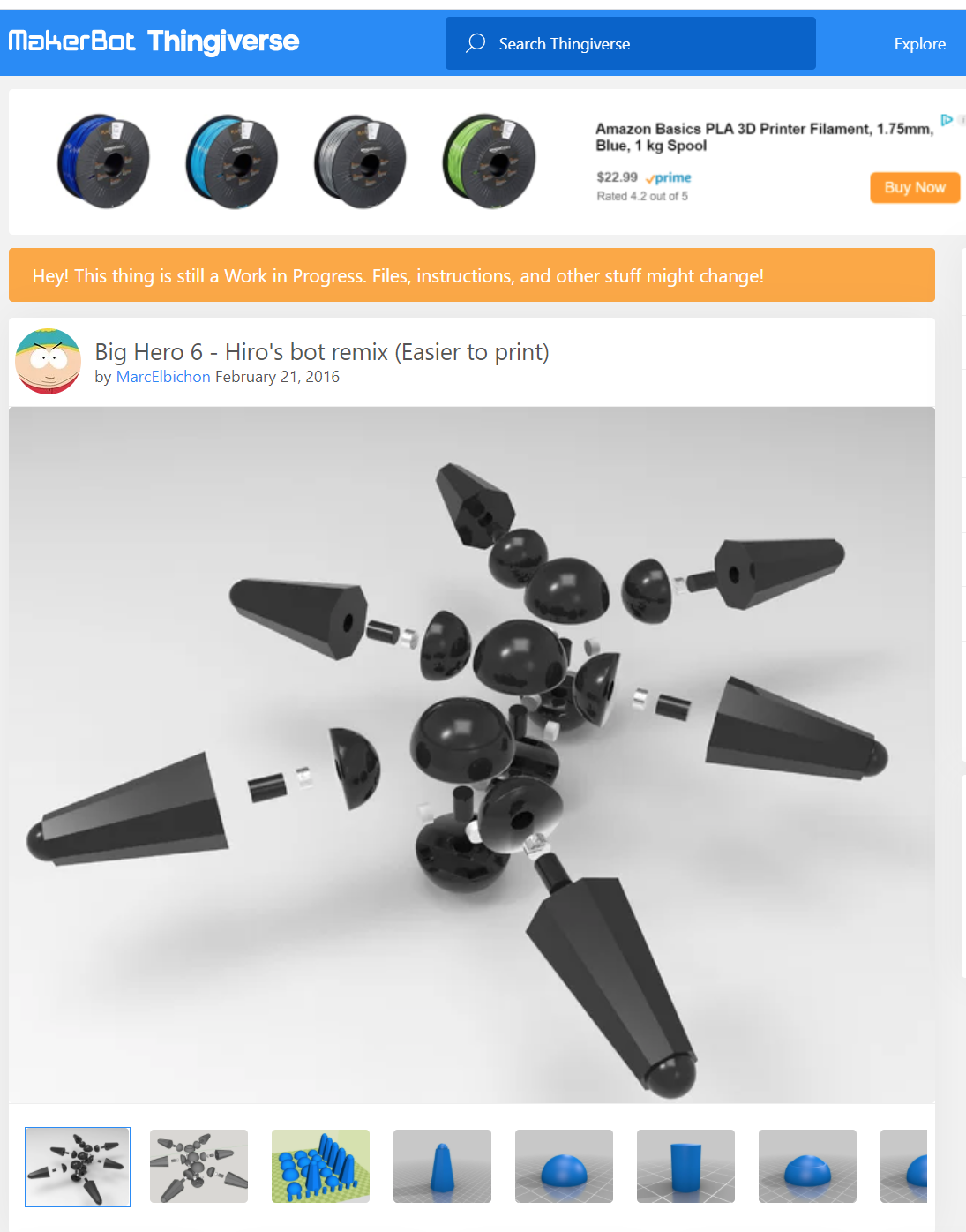

I was browsing Thingiverse for ideas a week ago, and when I saw the Megabot I knew this would make an ideal project, so I promptly downloaded it: https://www.thingiverse.com/thing:1358483

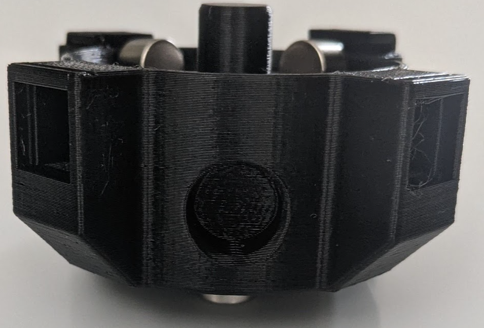

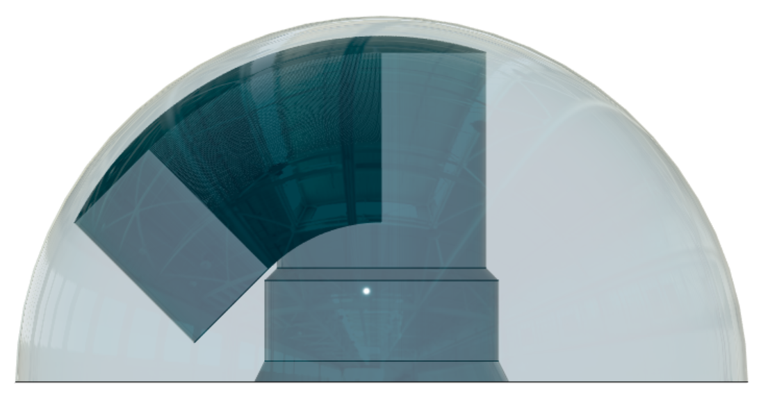

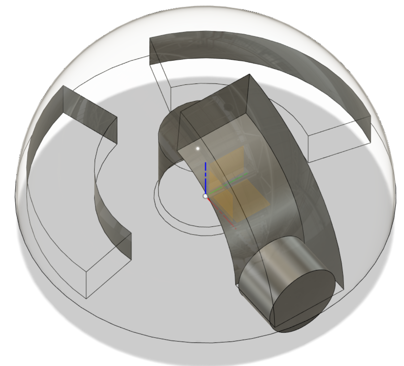

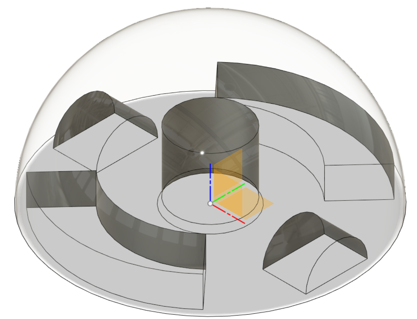

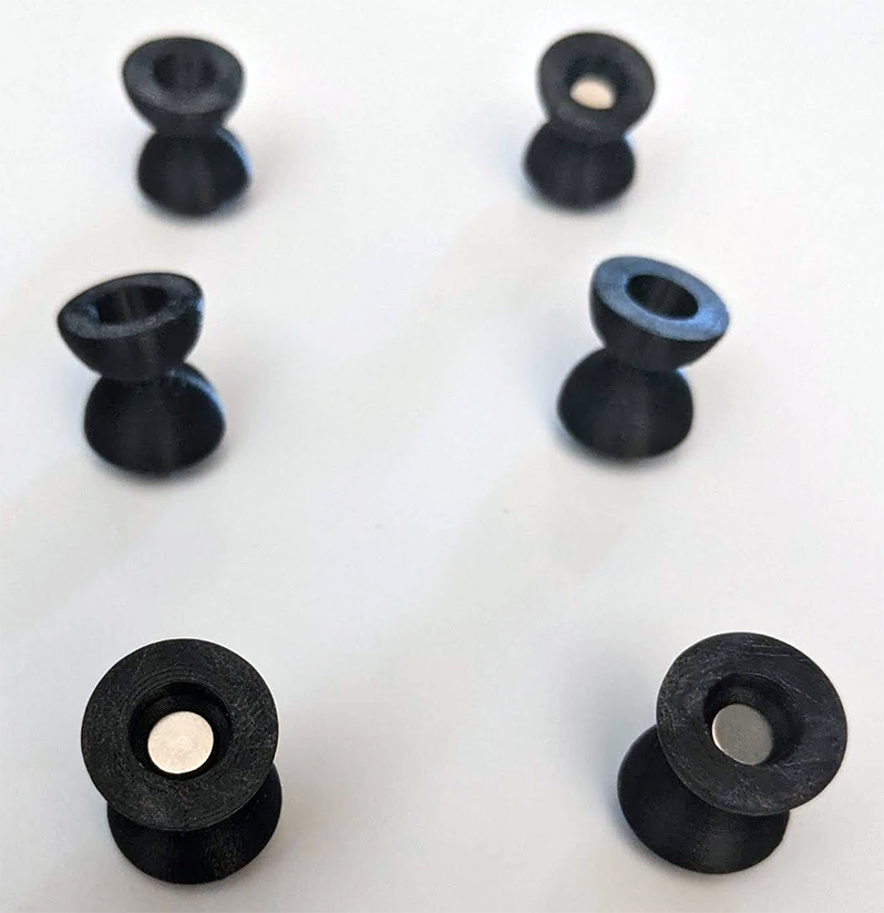

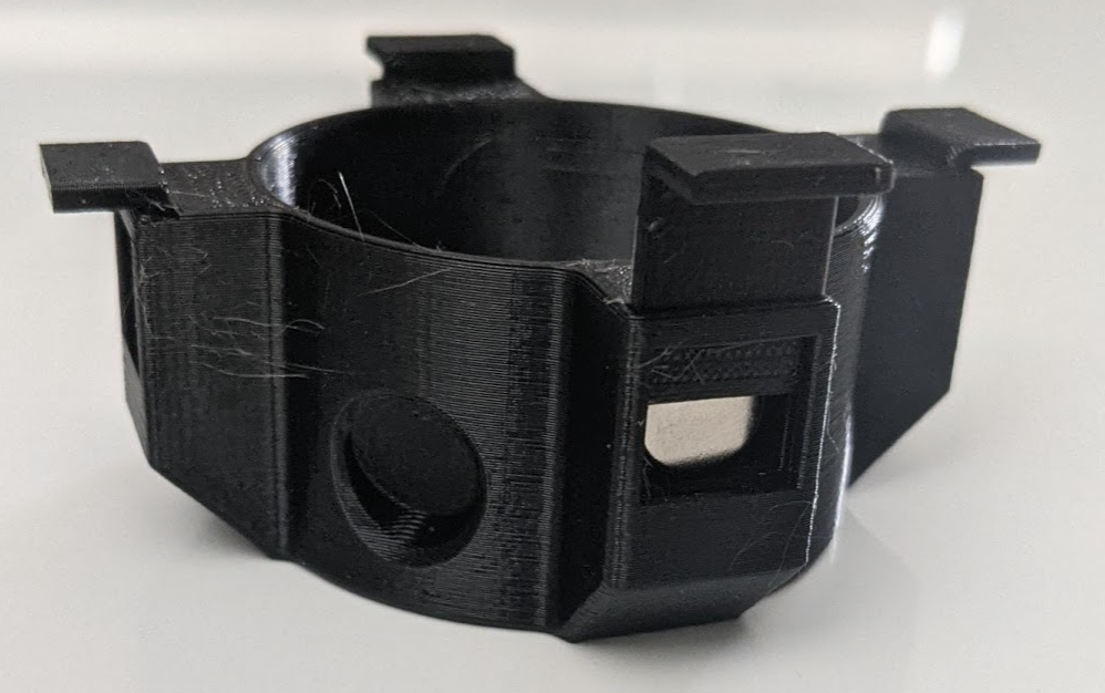

My solution was to create slots for the magnets to slide around inside the model. Here's the middle sphere with slots to allow the arms to position up/down:
The bottom and head spheres are even more complex, allowing the ears/legs to position up/down, as well as rotate back/forth on the torso. Remember that this is just half a sphere, so with two halves joined it will rotate nearly 180 degrees.
I also did something similar for the ear/arm/leg bases, creating a slot for the magnet to move in one direction only, which should allow for the final adjustability to recreate these poses:

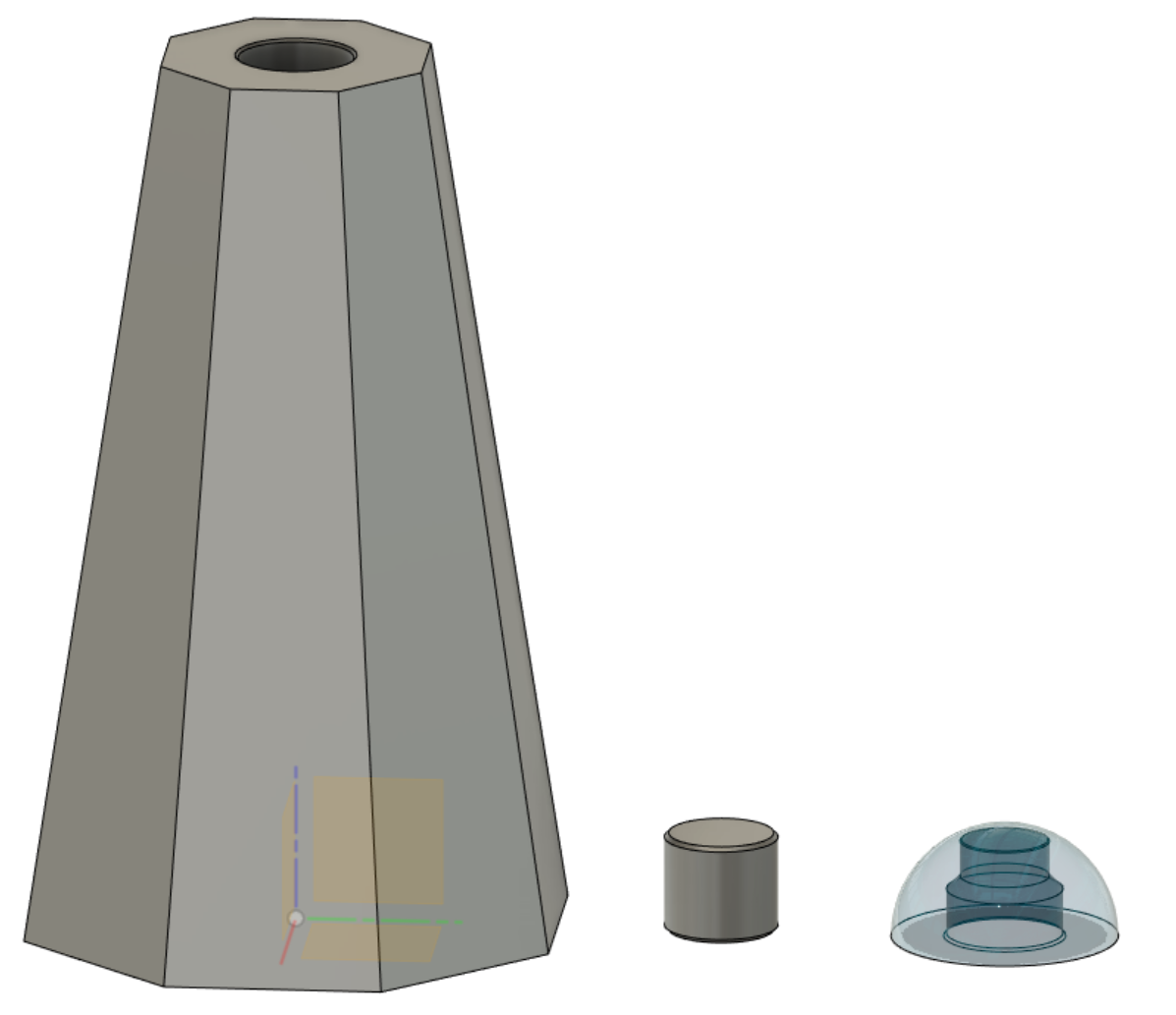

There was one more change I wanted to make related to magnets. Megabot can extend like a snake, connecting arm-tip to arm-tip, like this:
The Thingiverse model didn't have magnets here at all, so this is where I designed in the 6mm x 3mm magnets. These smaller magnets won't provide as much pull force, only about 1/2 pound, but that should be strong enough to hold the snake pose together.
In all of these changes, I've done a lot of trial and error printing to discover how close I can place the magnet to the surface before experiencing printing issues. Too close and it doesn't print well, or is too weak to keep a magnet from breaking the plastic shell.

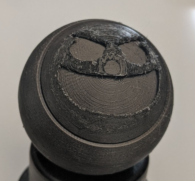

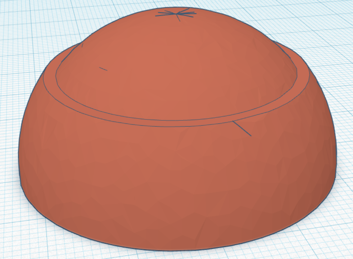

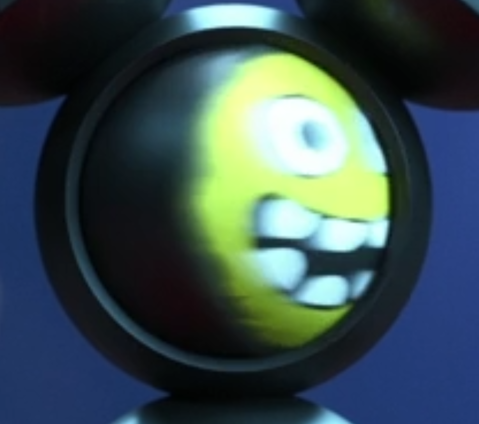

One last change I made is to how the face is shaped. In this shot, you can see that Megabot has an internal sphere that rotates, and there is a slight gap between the inner face sphere and the outer head sphere. Plus the head sphere's opening is chamfered, not flat cut.
The Thingiverse design didn't incorporate either of these elements:
While it would have cool to make the face rotate, this would have required going with much smaller magnets, so I gave up on that idea pretty quickly. Though it may be hard to tell in the screenshot below, I added a small gap between the head and face spheres, plus the chamfer on the head opening:
The printed effect is subtle and hard to see in photos, especially in black, but in person it does give a distinct sphere inside a sphere effect, especially when compared against the original Thingiverse design (please ignore the teeth marks, my dog found it really enjoyable to play with, haha):

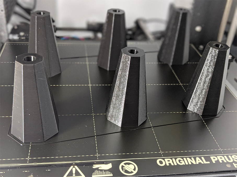

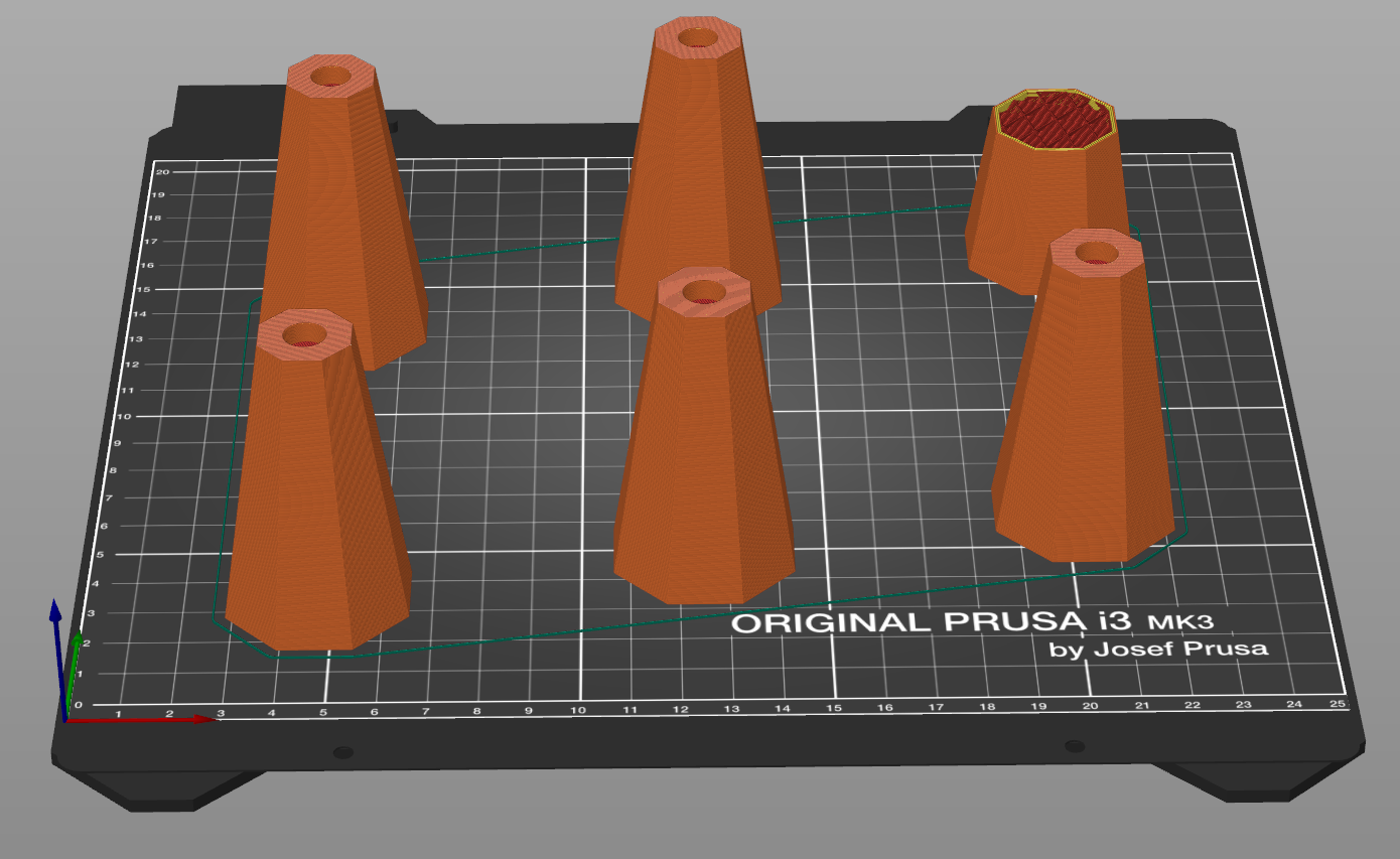

Also, since I needed so many copies of the same parts (6 arms, 3 bottoms, 2 middles, 1 head) and was printing out two complete Megabots, I found it a huge time savings to place multiple part instances on the print bed and print them all together. The problem with this approach is that you get stringing - spiderwebs of melted plastic connecting one part to another, due to the print head jumping between parts on each layer, that increases manual post processing to remove them. The best prints come from printing one part at a time, ensuring that the print head stays within the part's perimeter, eliminating stringing.

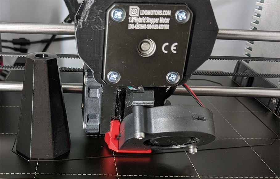

While PrusaSlicer has an option to print each part sequentially, it has very restrictive default settings for part spacing and height, and all of Megabot's parts were too big. With very careful measuring and planning, I determined that I could print 6 parts if I spaced them out far enough, with the print order left to right, front to back. The parts in each row also have to be staggered towards the back. Failure to space everything perfectly will cause the extruder assembly or X-axis slide rod to collide with a previously printed part, which would likely ruin the current part and possibly even damage the printer. Once I knew I had safely spaced all parts out far enough, I overrode PrusaSlicer's restrictions to force it to accept my layout as safe.
In the layout above, there is only 5-10mm of open space between the extruder and each previously printed part, but that's more than enough to successfully print all 6 arms together, one-by-one. Here's a pic I took of the print in process, and you can see just how close the extruder assembly and chrome x-axis support rod comes to the previously completed arm:
By the way, at 0.20mm detail level, these 6 arms take about 10 hours to print. Each entire Megabot takes about 27 hours to print at these high-levels of detail, so it's taking over two full days of round-the-clock printing to get my two Megabots, plus several more days of development and test prints to hone the final design. Fingers crossed the magnets fit okay when they arrive...

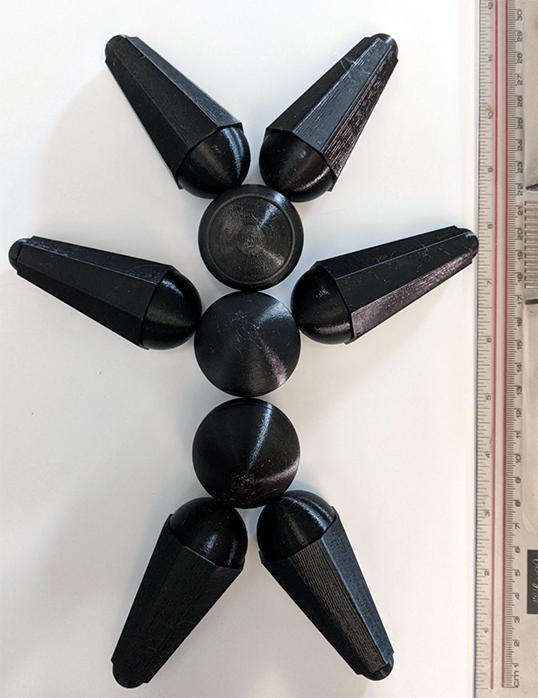

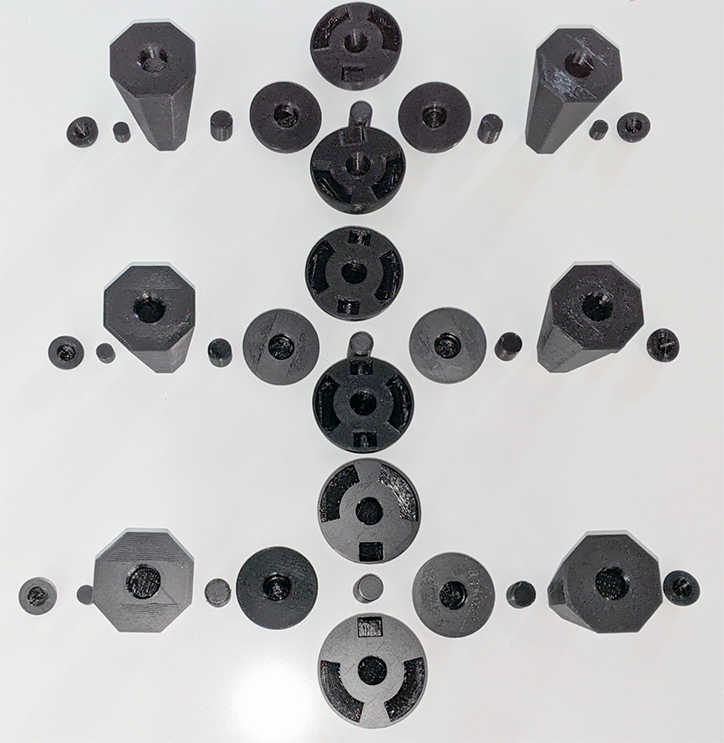

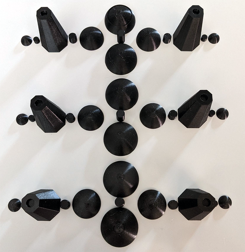

For those who enjoy knolling shots, here's all 39 parts (minus the 22 magnets):
Plus a gratuitous 2nd knolling shot with all the parts flipped so you can see the internal passageways:

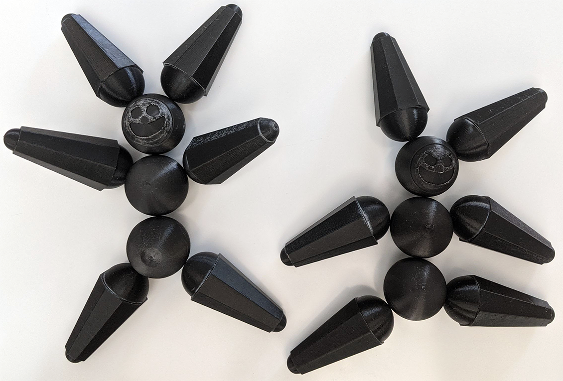

And even though I can't perform final glue-up until the magnets arrive, here's a test fit of all the parts. Overall size is almost 12 inches tall, about 29 centimeters:

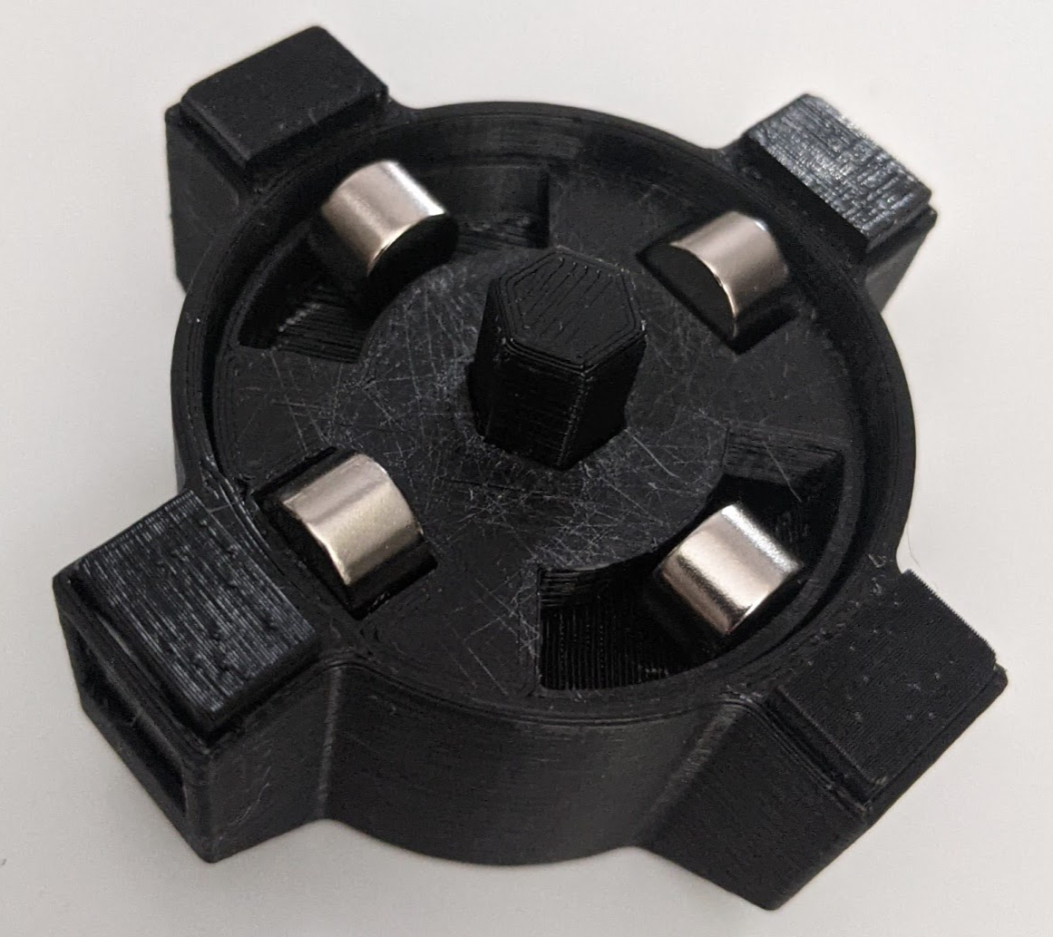

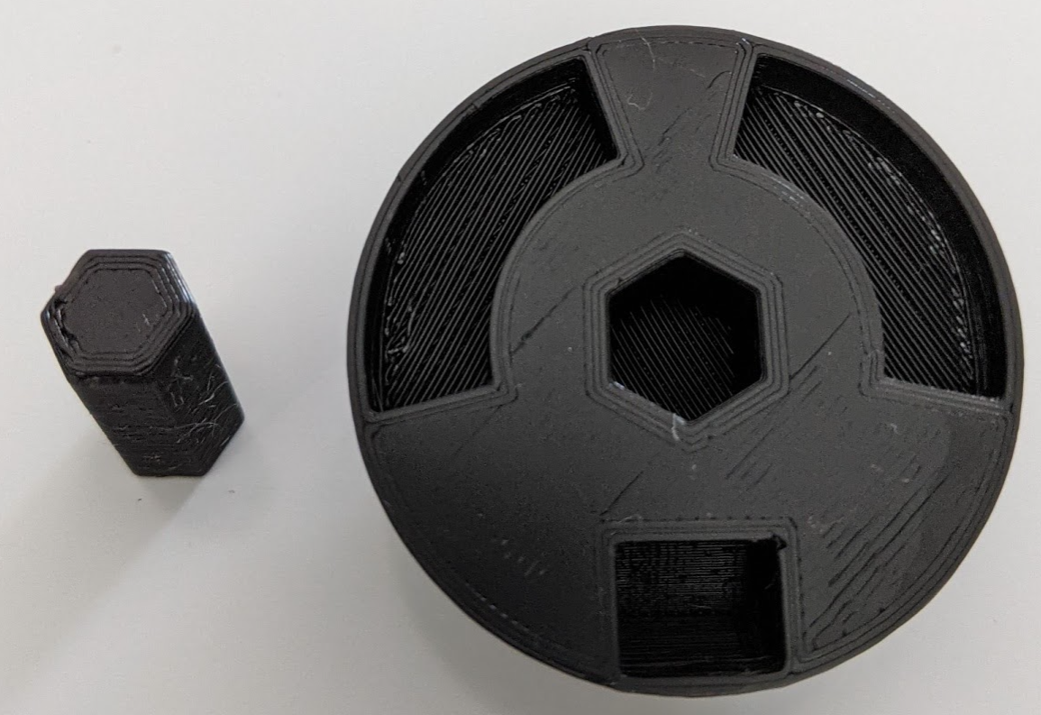

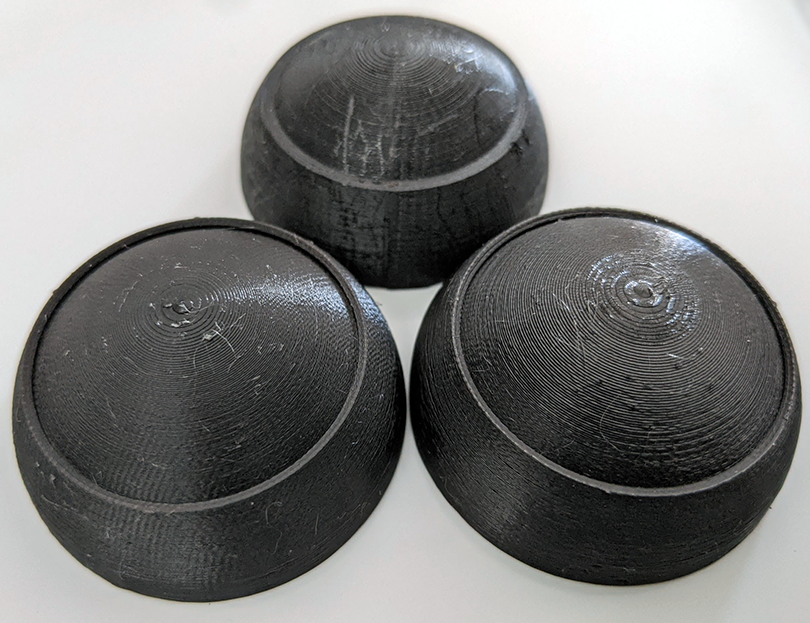

I also discovered that my magnet sliding slots don't have quite enough vertical clearance due to a printing issue. The 3D model has a sliding magnet height of 10mm in the design, which should be plenty for a 9.5mm magnet, but the hot melted plastic droops ever so slightly during this bridging maneuver. It's not a huge sag, only 0.5mm, but because the same sag exists on both sphere halves, the total loss in vertical clearance is a full millimeter. The magnet is just large enough that it is creating a gap between the sphere halves of about 0.5 mm, so if the sag wasn't there then the magnets would actually have about 0.5mm of clearance. I have tweaked this element in the design, adding a full 1.5mm of more clearance, so the two sphere halves will close and the magnet should move freely.
Other Design Tweaks
While I was tweaking the design, I went ahead and changed the center pin to a hexagon, which makes it much easier to align the two sphere halves in the correct orientation.
Lastly I added an addition 0.25mm of gap around the face. That's such a small amount, it's almost hard to notice. In the pic below, the left head is the latest with the ever so slightly larger gap. In person, it's just enough of a tweak to change it from making you wonder if you're seeing a gap or a weird shadow, to knowing for sure you're seeing a gap. The one in back in the original Thingiverse design that has no gap at all.

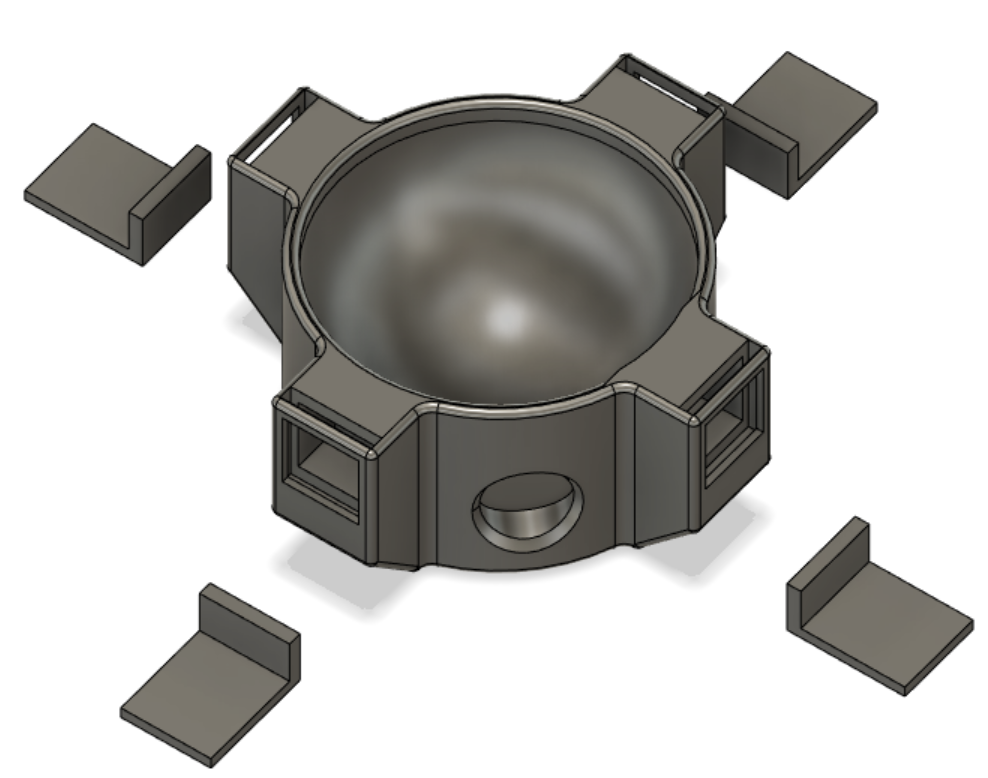

In the mean time, I'll get to work on designing an assembly jig. Should be a fairly simple design, though perhaps I'll get fancy and create a magnet retention solution so I don't have to use glue, as these magnets are expensive...
Re: [DIY] Big Hero 6 Hiro's Fighting Robot - Megabot (Work In Progress)
Post by Pauven » Fri Apr 16, 2021 1:11 pm

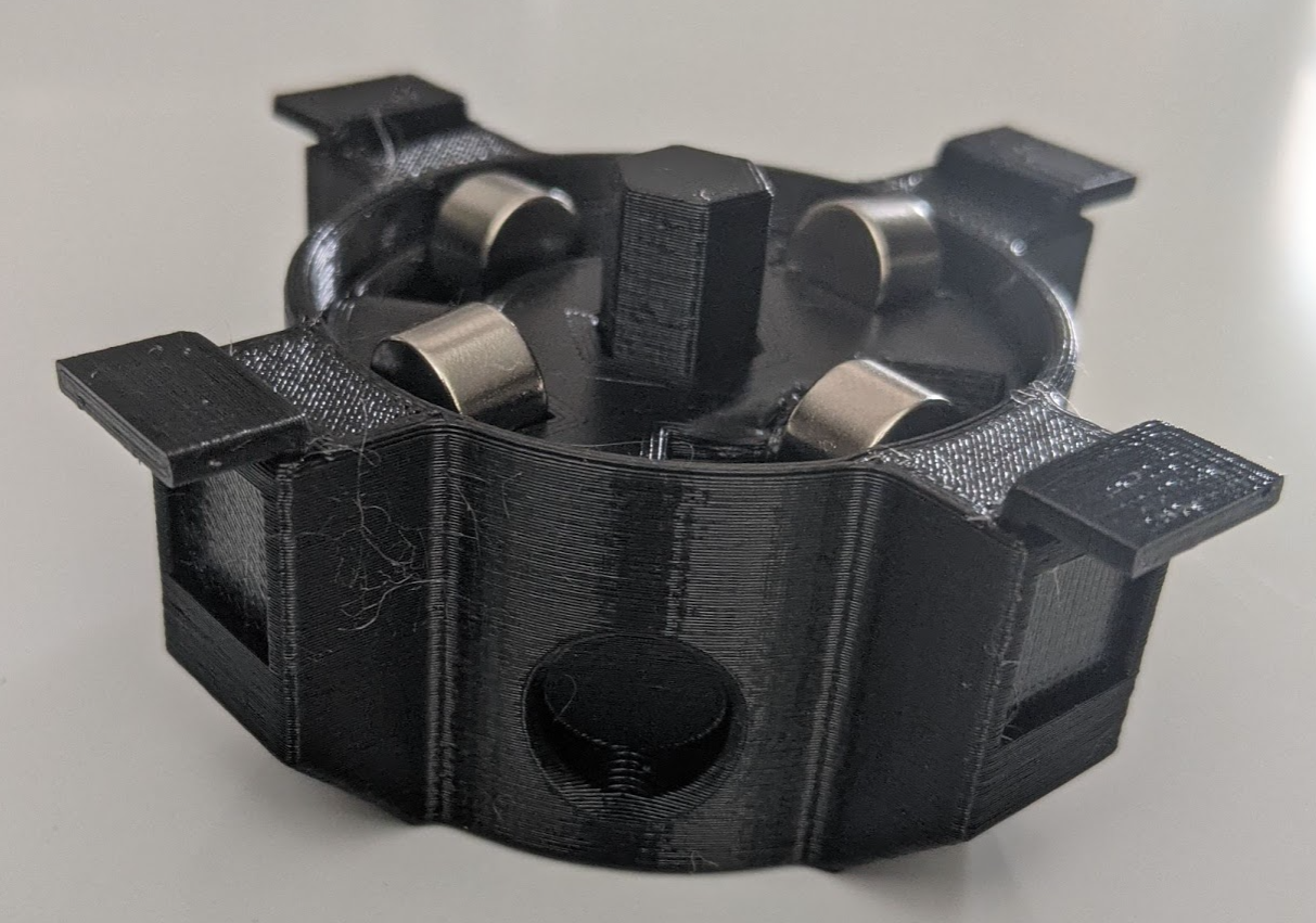

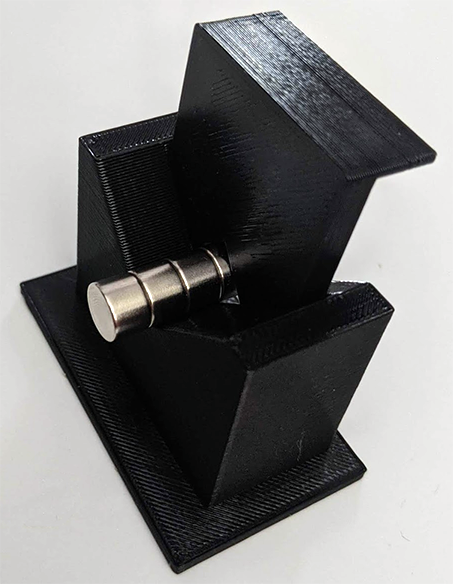

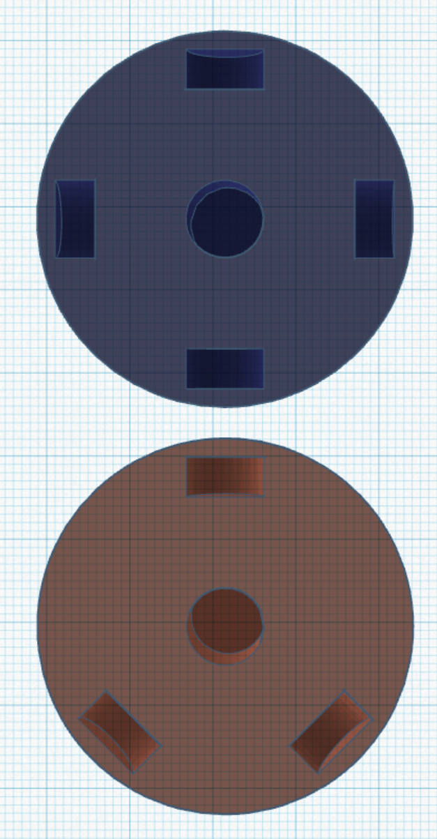

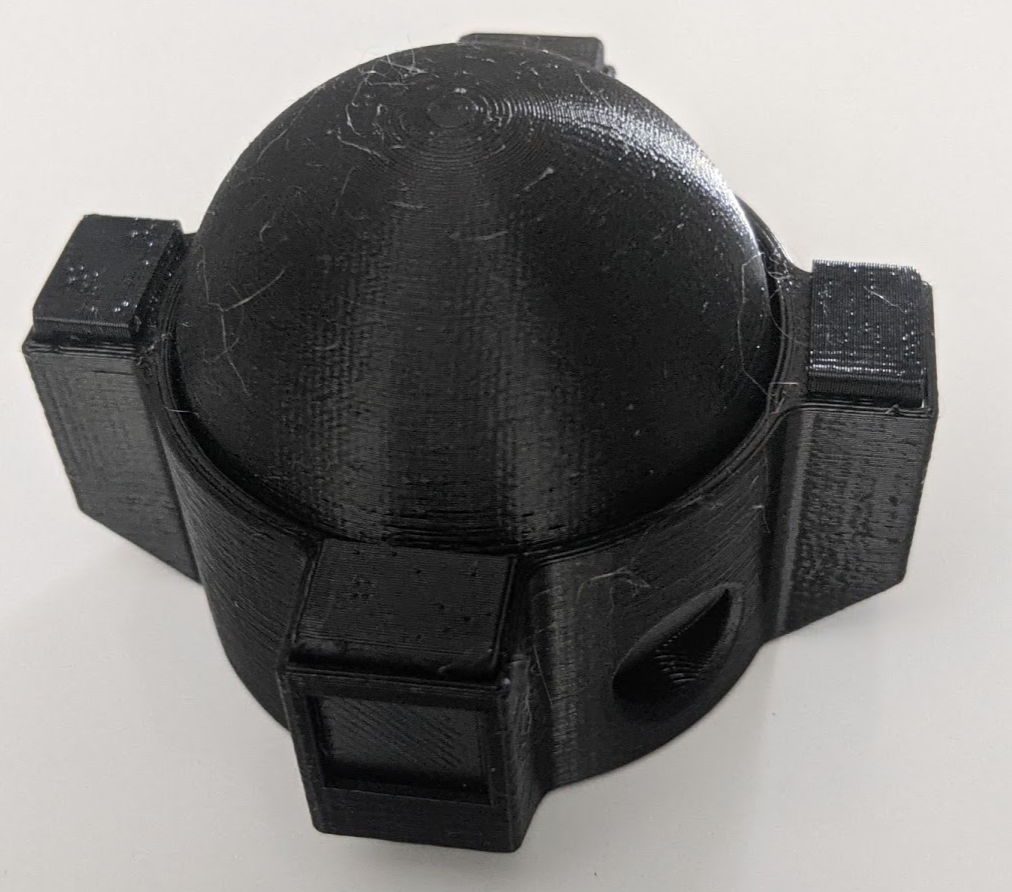

While I was able to assemble a 3-magnet sphere (head or bottom sphere) by hand, it was extremely hard, and I realized that it would be impossible to do this manually without supergluing my fingers to the sphere.
For that reason I designed the assembly jig to work in both 4 and 3-magnet arrangements (at least, in theory). For the 3 magnet orientation, the 3rd positioning magnet is not secured, so I can slide it manually - this is important for sliding the internal magnet into the halfway point between the halves during glue up, as that channel must stay aligned to prevent from blocking the magnet. Even with a hex pin to hold the two halves in alignment, there's still some slight wiggle that could allow for the channel to be misaligned during glue-up.

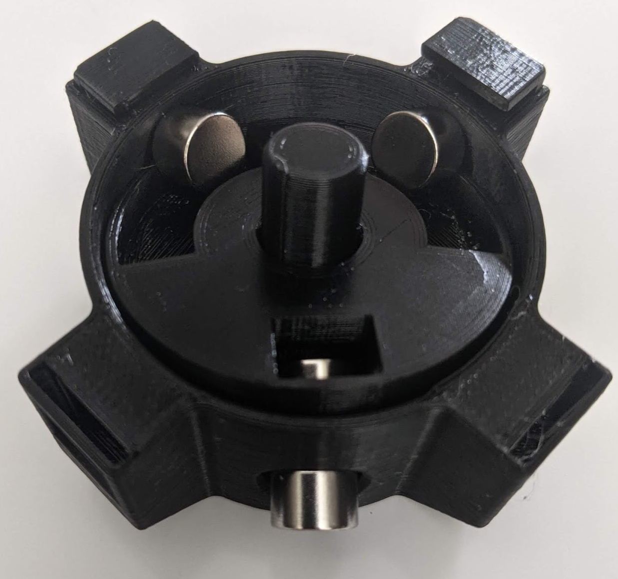

The magnets fit well, and are secured easily.
And though it still wasn't easy, it was possible to get all four magnets positioned, ready to glue the two halves together. (Note, the middle hemisphere shown in the pic below was one of my rare failed prints from last night, reprinting now...)
And the second hemisphere slid on easily, so the alignment jig is working pretty great... almost:

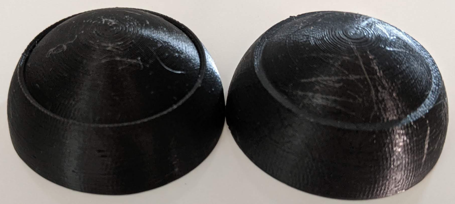

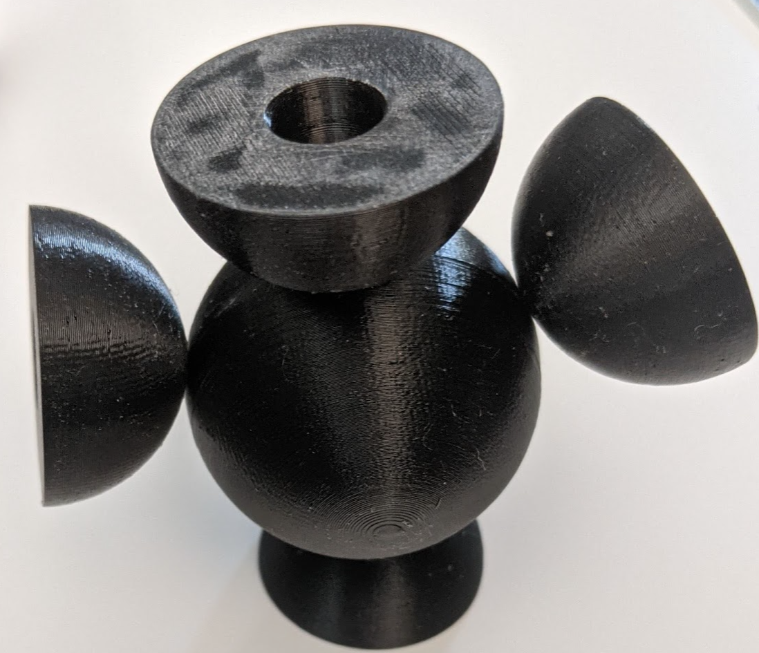

It was only at this point that I realized my major flaw in the design. With 8 super powerful neodymium magnets holding this thing together, it's impossible to remove the sphere from the jig! There's no leverage, and there's easily around 10 lbs of force (feels like more) holding the sphere in the jig. I can't get the magnets out of the jig, and I can get the sphere out either. Facepalm.
Glad I haven't glued anything yet. I'll take it all apart, then drill a large hole in the center of the base. That way I can lower the jig over a wood dowel and force the sphere out after glue-up.
Unfortunately, the jig isn't working near as well for the 3-magnet spheres. Positioning the 3rd magnet on the side didn't provide any holding power to keep the other two magnets properly positioned - the sphere would slide down and other two magnets would tilt out, making it impossible to slide the second hemisphere into place.
I did find success if I placed the 3rd magnet on the bottom, so that the 3rd magnet reaches the end of the internal slide and holds the sphere in the correct orientation. This was unplanned, and may pose problems once I drill a hole in the base. I probably need to make sure the hole is smaller than the magnet, perhaps a pencil sized hole will work best.
I also explored using smaller, less powerful magnets in the jig. When I purchased the magnets for Megabot, I also got a selection of other sizes for future projects, including some 8mm x 4mm magnets. These are about half the strength of the 9.5mm x 6.4mm magnets. This still didn't allow for me to align the 3-magnet sphere using the 3rd magnet on the side, but did make the bottom position even more steady.
I still can't assemble yet. Since my middle sphere's had print flaws from last night, I have to wait on their reprints. I need to assemble the middle first, so that I can ensure all the other magnets are positioned in the correct orientation with respect to the middle, otherwise the model may repel it's appendages instead of attracting them.

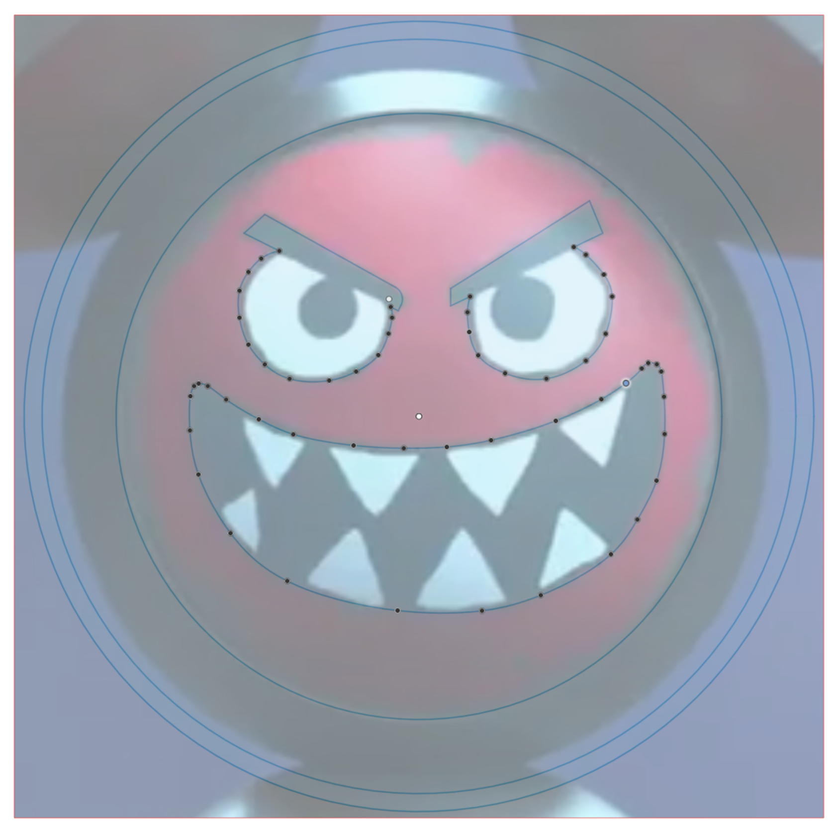

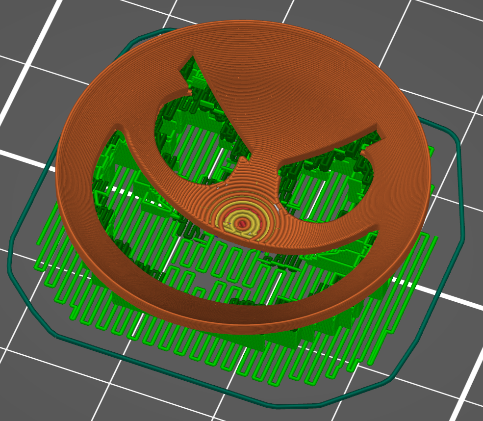

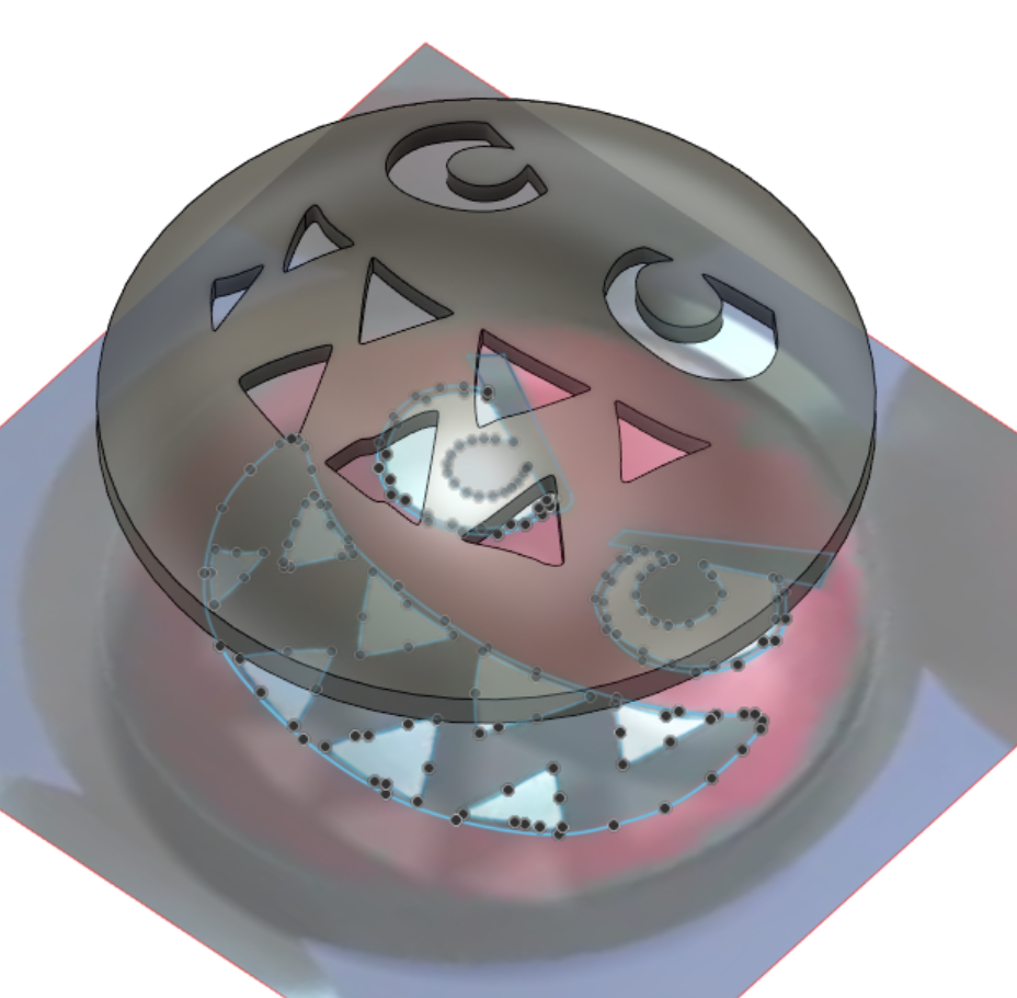

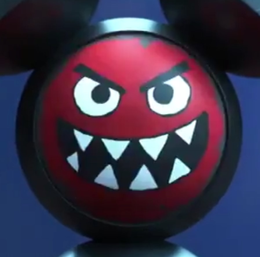

While I'm waiting on some final parts to print out, I decided to work on a painting template. Megabot has two faces, the yellow happy, smiley face, and the red destroy face. Since the printed model's face is only about 1.25 inches wide (33 mm), and I wanted it to look as accurate as possible, I thought that creating a template would be helpful.
Normally I would just print a template on paper and cut it out, but with Megabot's curved face, a flat sheet of paper would not make a great painting template. Instead, I've decided to try 3D printing a template.
To do this, I started with a screengrab of a face from the movie:
Megabot Destroy Face.jpg (59.61 KiB) Viewed 131233 times

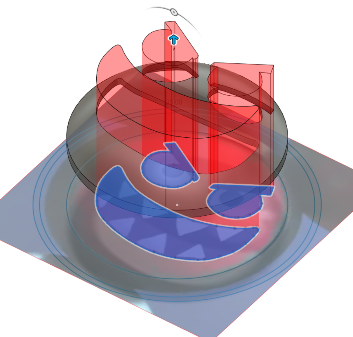

Then I brought the screenshot into Fusion 360 as a background canvas, scaling it to the appropriate size, though due to camera perspective I couldn't quite get the all the sizes to match so I simply chose what I thought best. On top of the canvas, I sketched an outline of the black painted areas. Since white would be painted on top of the black, I included the white areas in the black outline.
I then created a "contact lens" shape that would rest on top of the face area, and cut out the eyes and mouth.
To print the template, I flipped the model over so that the supports would touch the outside of the dome, so the inside would remain unblemished, ensuring a good fit against the model's face.
I was hopeful that my design would print and fit okay. It seems I'm getting pretty good at modelling, as it actually fit perfectly the very first try. While it might look like the nose is also cut out in the image below, that's just an optical illusion, only the eyes and mouth have openings.
Finally I repeat the process for the white irises and teeth, and do it all over once again for the happy smiley face.
I'm still a while off from painting, so I'll show more of these templates when I get to that step.

Finally, assembly time!

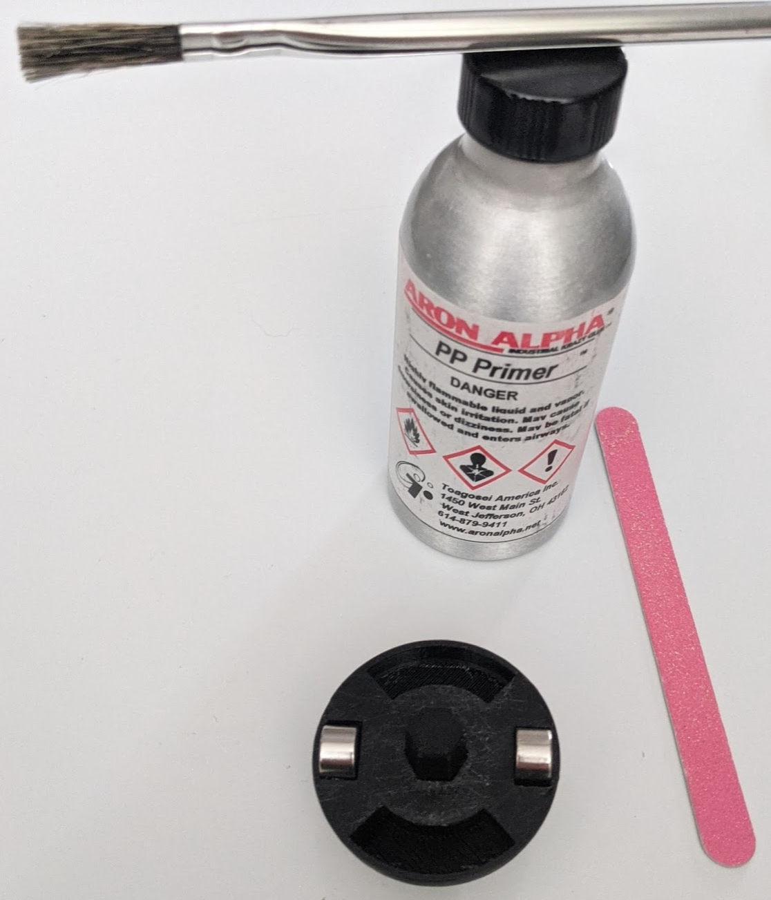

PLA is one of the more difficult plastics to glue together, and many superglues don't work at all. I've read many studies comparing different products, and Loctite's Ultra Gel Control Super Glue seems to be one of the best products. I've been using it for years now with great results.
Additionally, surface preparation is very important. I sand all mating surfaces (that I can reach) to rough them up and give the glue something to bite into. Additionally, I use a product from Aron Alpha called PP Primer, which wicks into the plastic and further improves its glue-ability - though the product labeling on this is very scary so choose for yourself if this nasty chemical is something you want to play with (death from breathing vapors, anyone?).
Instead of using the larger 3/8" x 1/4" neodymium magnets in my assembly jig, I decided to use the less powerful 8mm x 4mm magnets. The accomplished my goal of holding the model's magnets in place during assembly, and put up less fight when I had to remove the model from the jig. To ensure that the magnets were placed in the correct orientation, I used a test arm I had assembled with a magnet to ensure each magnet in the jig was positioned correctly.
I was also tired of hurting myself trying to separate magnets, even these smallish magnets are too strong to easily separate by hand. So I printed out a handy dandy magnet guillotine that I found on Thingiverse:

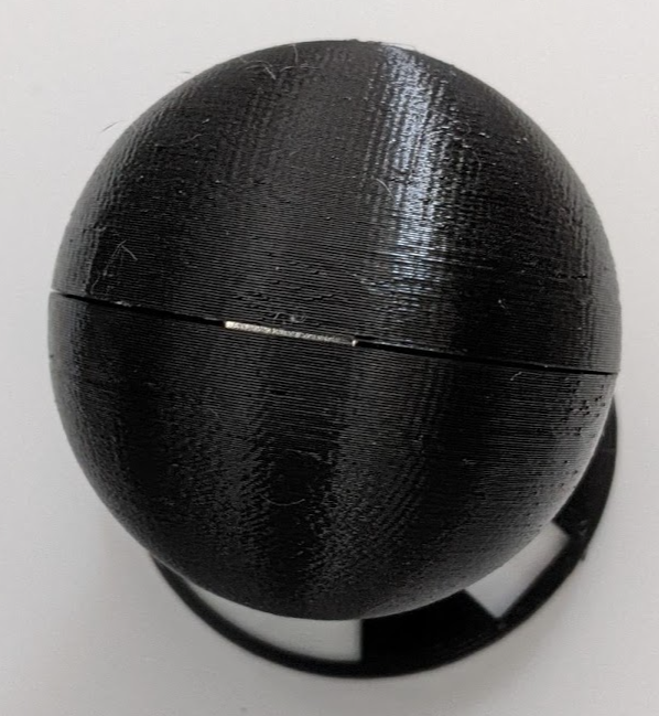

When assembling the 4-magnet middle spheres, I would superglue in the two stationary magnets first, just to help prevent any assembly issues, though this really seemed unnecessary. Once that set, I would place the other two magnets, add superglue, and place on the other half. In the picture below, you can see the surface scratches from sanding the mating surfaces for glue-up.
Immediately after joining the hemispheres I would push out the sphere from the jig using a pencil (note the all-important hole I drilled in the base of the jig), and firmly clamp the two halves together in my hands for 30 seconds. Then using the test arm I would wiggle the sliding magnets around to make sure they didn't get locked in place from any glue squeeze-out inside.
I has also briefly considered lubing up the sliding magnets with some lithium grease before glue-up, and in hindsight I'm glad I didn't. The sliding magnets slide easily enough, but also have just enough "grip" on the plastic to lock into place, so they only slide when force is applied. This seems pretty perfect.
After doing the middle sphere, I could then re-configure my assembly jig for the 3-magnet head/bottom spheres - this simply required taking out two magnets, and then using the freshly assembled middle sphere to position the bottom magnet with the opposite polarity.

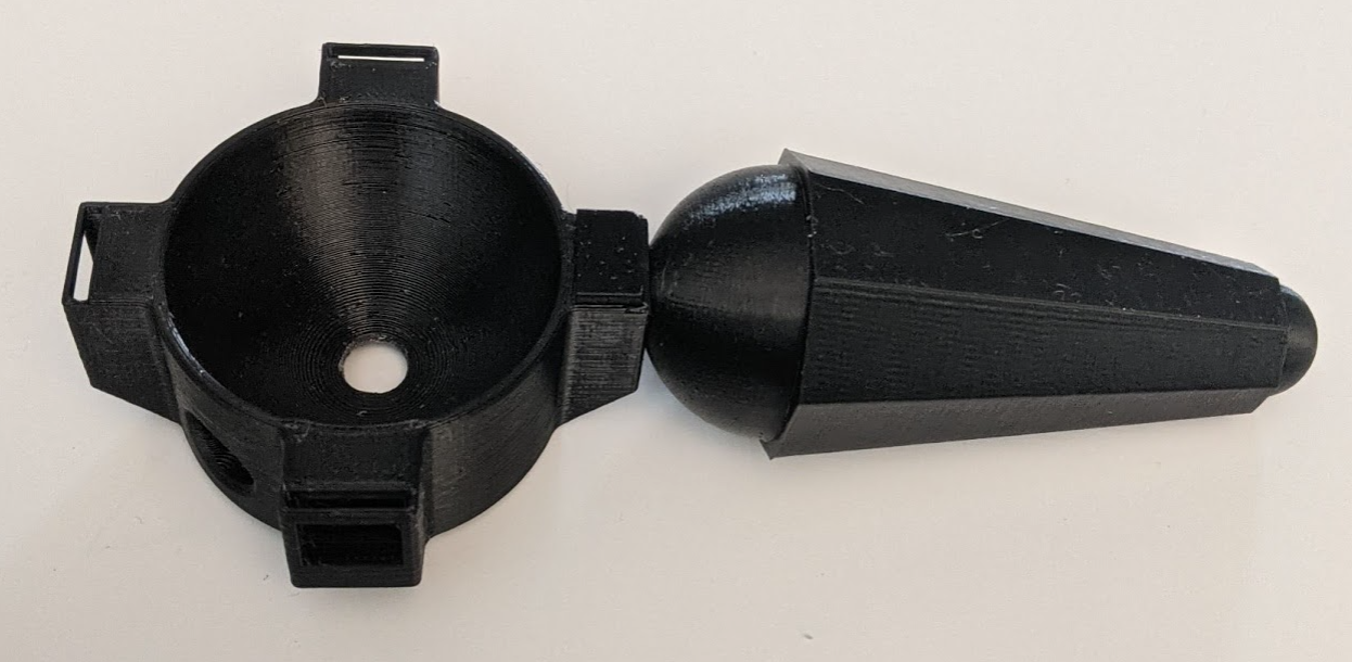

With that complete, I then began assembling the arms. One interesting observation is just how closely I designed the magnets towards the very edges of the model. In the picture below you can see one of the printed arm tips (finger-tips?), which looks completely solid:

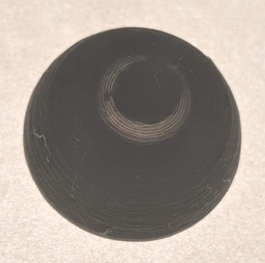

But when backlit, you can see right through the very thin plastic in some areas, probably about 0.2mm thick - if the magnet was any closer to the surface there wouldn't be plastic there at all. This translucency was hard to capture on camera, in person it looks much thinner.
To ensure that the Megabot model could successfully link in the snake shape, I needed half of the finger-tips to be in the opposite polarity. To do this, I first glued-up half the finger-tips (6, since I'm doing two complete Megabots), then used those to control the magnet orientation for the other 6 before gluing them in place.
Then I glued the finger-tips onto the arms:
Before gluing the arm bases onto each arm, I would set the magnet orientation using the 4-magnet middle sphere:

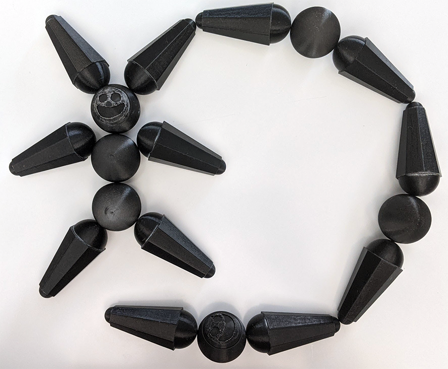

With all the gluing complete, I was finally able to check out my creations - Megabot lives! Below I put the face painting templates on to give you a hint of how they will look once painted:
I was also able to arrange Megabot in the snake form as I had planned. Unfortunately, the magnets aren't quite strong enough to hold it dangling from the top - it can only handle two sets of arms, as soon as I get to 3 it falls apart.
