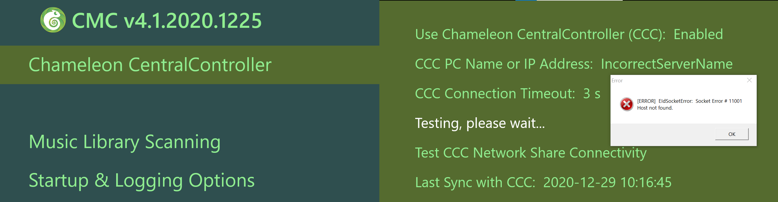

A "Socket Error #11001 - Host not Found" error message indicates that the remote PC is offline, or perhaps you entered the PC's name/IP address incorrectly:

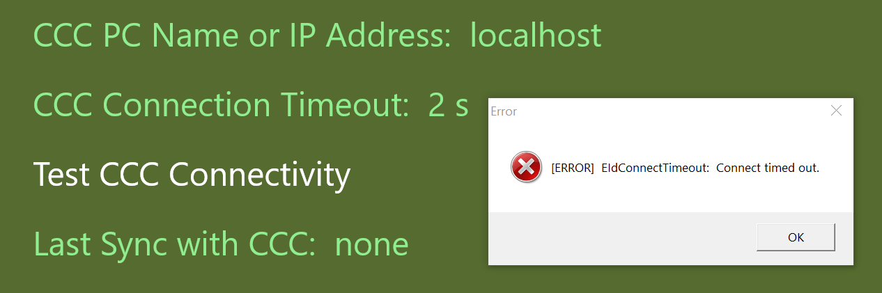

A "Connect timed out." error message indicates that the PC is reachable but CCC is not running - check to make sure CCC is running:

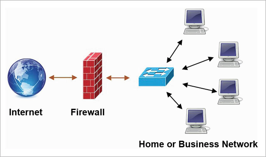

Chances are you have at one point in your life seen a firewall diagram like the following one, which illustrates how a firewall protects your home network from the scary internet:
Unfortunately, that is a very misleading image, as it suggests there is only a single firewall, and that it only affects internet traffic. Unless you have disabled the software firewalls running on your Windows PC's, that is simply not true. In addition to that firewall that protects you from the internet (this firewall probably lives on your internet router), each PC usually has a software firewall, and this firewall can block traffic from all PC's, even those in your home network. A corrected picture probably looks more like this:
This means you will need to make sure that every CMC and CCC PC has the correct exceptions added to its firewall rules.

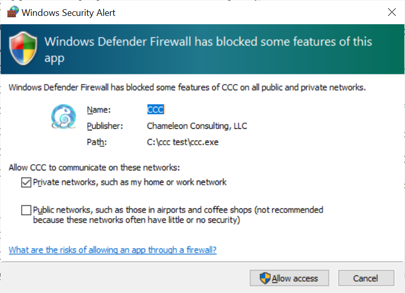

If you are using Windows Defender Firewall, then this is going to be really easy! The first time you run CMC or CCC, you will see a Windows Security Alert pop-up, similar to the following image:
The alert indicates that Windows Defender Firewall is currently blocking network access, and unless you click Allow Access, it will not work correctly.

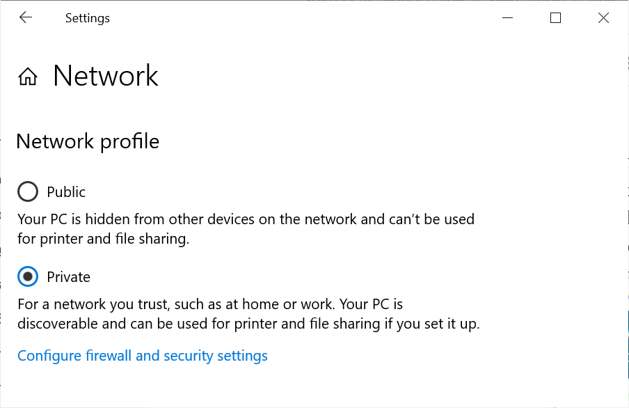

Most users will have their home network classified as a "private" network, and the option to allow communication on your private home network is checked by default.
Some users might have their home network classified as a "public" network - and if so this is probably a configuration mistake. Hopefully you know what type of network you have configured, and select the appropriate option here. If you are unsure, then on Windows 10 you can go to Settings > Network & Internet > Status > Properties (choose the network connection you are using) and you should see the configuration (and have the option to change it):
Once you click Allow Access, you are done. The Windows Defender Firewall is now properly configured for CCC or CMC to communicate with each other and with My Movies.

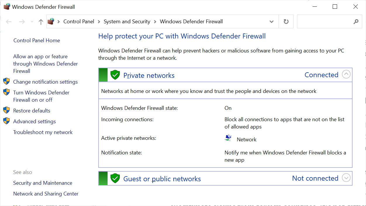

Click Start, then type Defender and select Windows Defender Firewall from the options shown. This will open the main control panel for Windows Defender Firewall:
This control panel is an alternate method to check if your PC is configured for a private or public network - mine is configured for "Private networks", as that one shows as currently "Connected".
In the leftmost column are several links, select the one titled Allow an app or feature through Windows Defender Firewall.

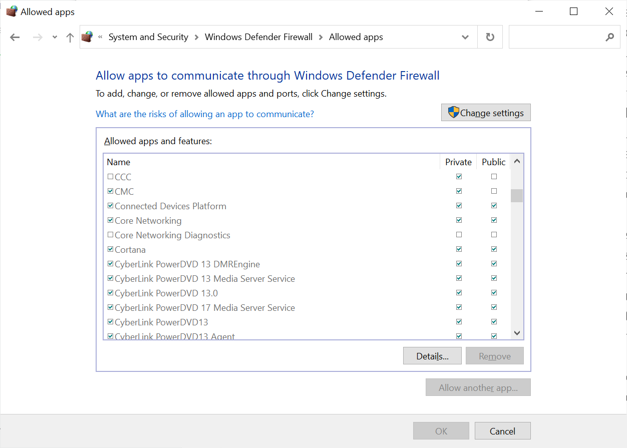

Before you can make any changes, you need to first click the Change settings UAC button that is at the top-right, above the list.
Since you've already run CCC or CMC and declined to give firewall access, then these will already be in the list shown. Scroll down to find CCC or CMC as needed. To grant access, you will need to place a checkmark in the left box, beside the app name, and also check the Private and/or Public checkboxes, whichever is appropriate for your network classification.
When you're done, click OK.

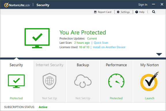

1) Open Norton 360:
2) Enter "Settings" (top-right, below the blue title-bar):

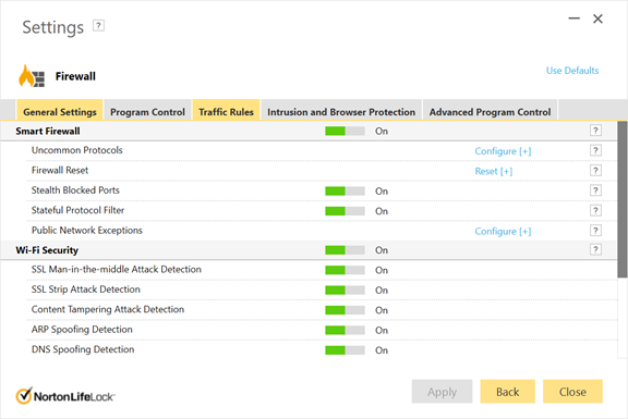

3) Select "Firewall":
4) Select the "Traffic Rules" tab:
5) Click the "Add" button (bottom-left):

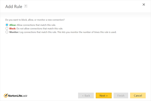

6) Select the "Allow" option, then click "Next >":

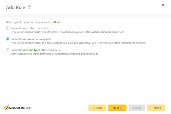

7) Select the connection type to allow option to "Connections from other computers", then click "Next >":

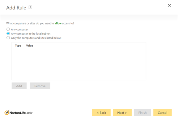

8) Depending upon your needs, you'll have to make a choice here on "What computers to allow access". For most users, the second option, "Any computer in the local subnet", is the right choice. A subnet is usually the first 3 octets of your IP Address range, i.e. 192.168.1.xxx. If you have multiple subnets and want to allow access from other subnets, be sure to select "Any computer".
After you've made your selection, click "Next >":

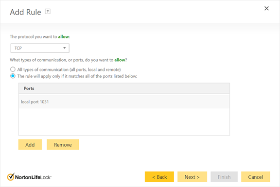

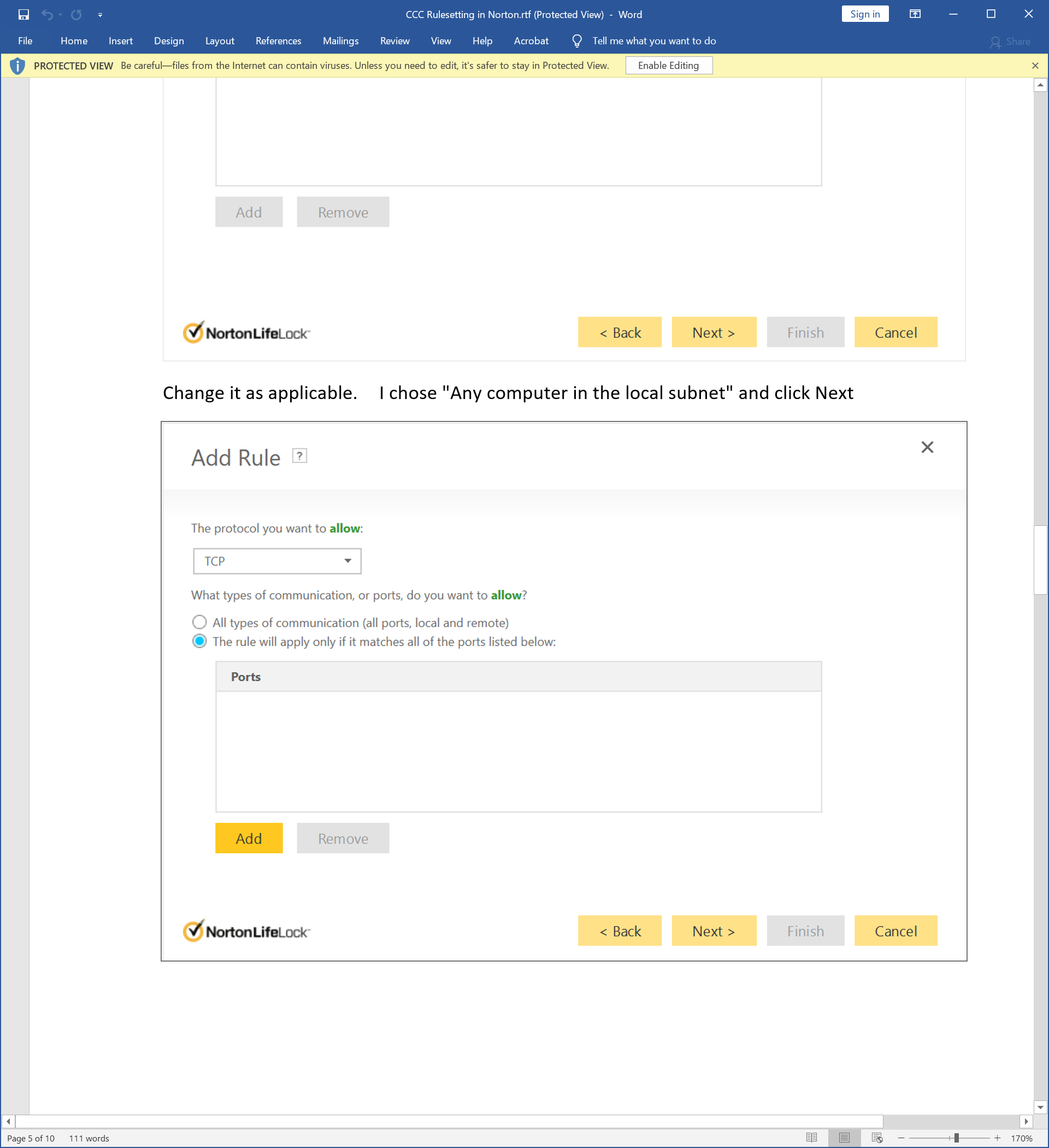

9a) In the protocol drop-down box, select to allow TCP.
Now you have another choice to make regarding which ports to allow. You can select "All types of communication (all ports, local and remote)", which is equivalent to the Windows Defender Firewall settings detailed above.
Or you can be more restrictive and select "The rule will apply only if it matches all of the ports listed below:". If you choose this 2nd option, you will then have to click the "Add" button to specify CCC's port #:

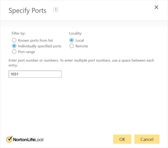

9b) From the "Filter by" options, select "Individually specified ports". For the "Locality" option, select "Local" (which means inbound). Finally, in the port number(s) text box, type 1031 then click the "OK" button:
9c) This will bring you back to the previous "Add Rule" panel, and you will see your new allowed port listed as "local port 1031". Click "Next >":

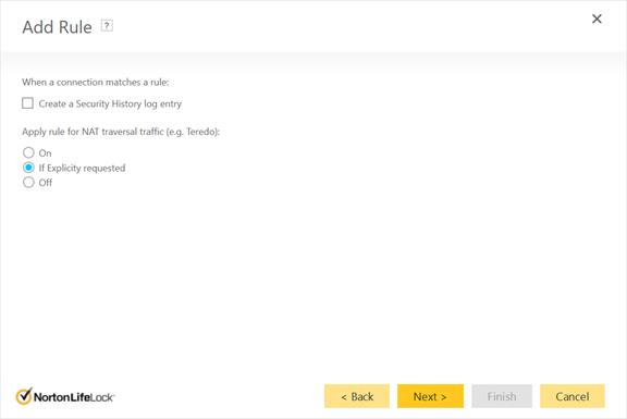

10) On the next page, the default values are fine. Click "Next >":

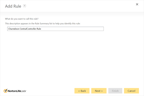

11) Now you can give the new rule a name - whatever you prefer. GaryReeve chose a good name: "Chameleon CentralController Rule". Another good option might be "CCC Inbound Port 1031". After you've come up with the perfect name, click "Next >":

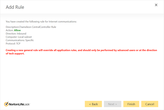

12) The new rule configuration summary should look similar to the above screenshot, perhaps slightly different according to the choices you made. If it looks good, then click "Finish".
13) Even though you clicked "Finish", you're not actually finished just yet (Argh... Norton!!!). Click "Apply" to put the new rule into effect, then you can click "Close".
