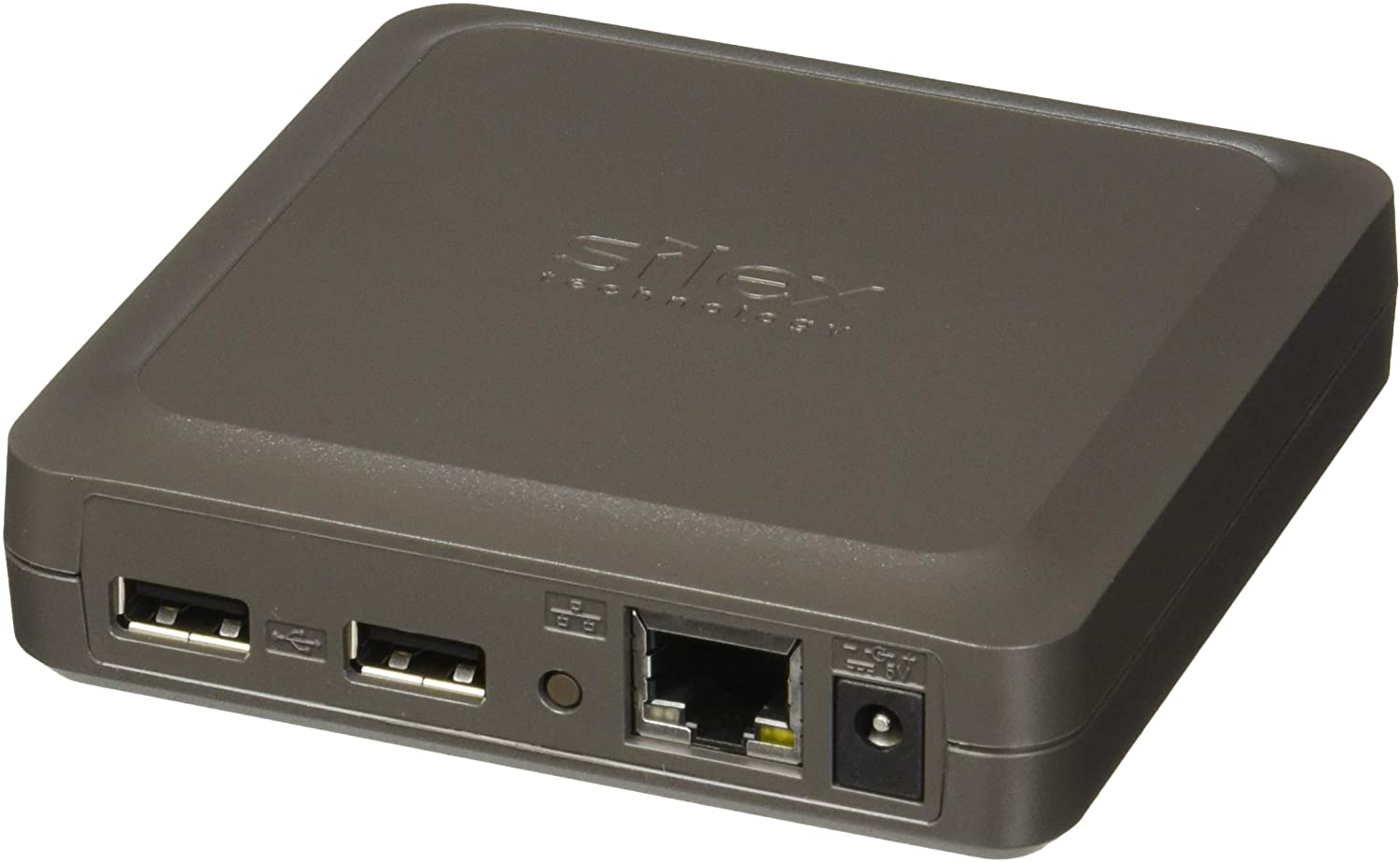

Once I got my terminology right, and started searching for "USB over IP", I started finding true network devices for networking USB devices, like printers and scanners and drives. I was finding lots of options on Amazon, starting around $40-$50. But the reviews were pretty bad. Apparently, most of these devices have inconsistent connectivity and flaky performance. For this to work, I was going to need something more robust. One of the reviews for a poorly performing product mentioned "don't buy this, buy a Silex DS-510 instead", which led me to the product I ended up buying.
The main benefit of the Silex DS-510 seems to be its reliability. Review after review confirmed that this device just worked, day after day, without issues. A few buyers complained of limitations like that only 1 PC could connect to a USB device at a time, but for me that was my intended use so this wouldn't be a limitation at all. My biggest hesitation was the price, $99. Ouch. But if it worked reliably I decided it would be worth it, and worst case I could return it for a refund. Not only did the two USB ports suggest I could network multiple Blu-ray drives, but some reviewers confirmed that you could plug in a USB hub for even more devices!
https://www.amazon.com/gp/product/B00U9 ... le_o04_s01
The Silex DS-510 is a simple small box with two USB 2.0 ports, a Gigabit Ethernet port, and a power port. You connect it to your USB device, in this case my USB Blu-ray drive, and your network and power it up, and you're done. Installation took all of 2 minutes. My USB Blu-ray drive did need a separate power supply, as the USB power from the DS-510 was not strong enough to keep it working, but this was expected and not a problem at all.

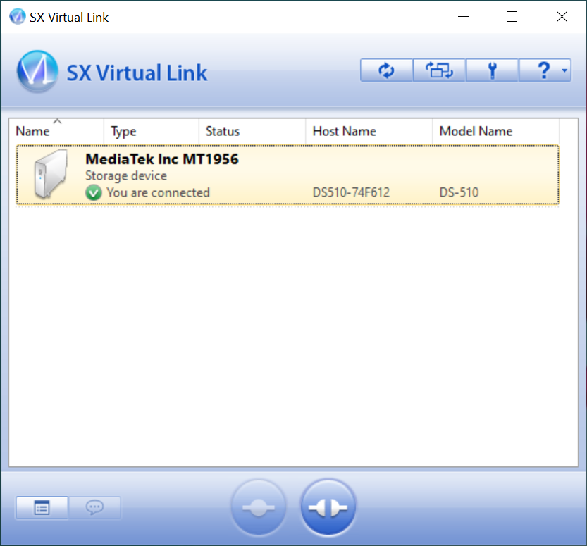

Now that the Silex DS-510 in on my network, the next step was to install Silex's "SX Virtual Link" software on the My Movies PC. The SX Virtual Link connects to the DS-510 "server", and allows you to connect to the associated USB device and make it appear as a local USB device. This was incredibly easy to do. It only took a few minutes to download and install the "SX Virtual Link" software, and almost immediately after launching the app it found the DS-510 on my network.

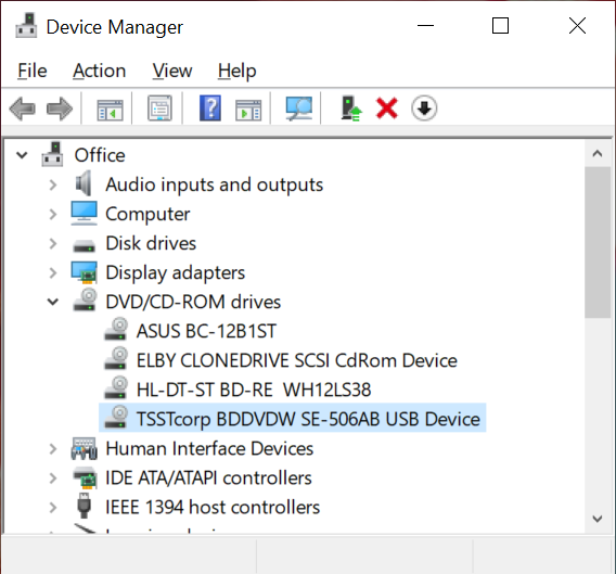

I clicked the Connect button and I was done. I could hear a few Windows chimes indicating that Device Manager had found a new device and was installing it. I checked Device Manager, and sure enough the USB Blu-ray drive had appeared.

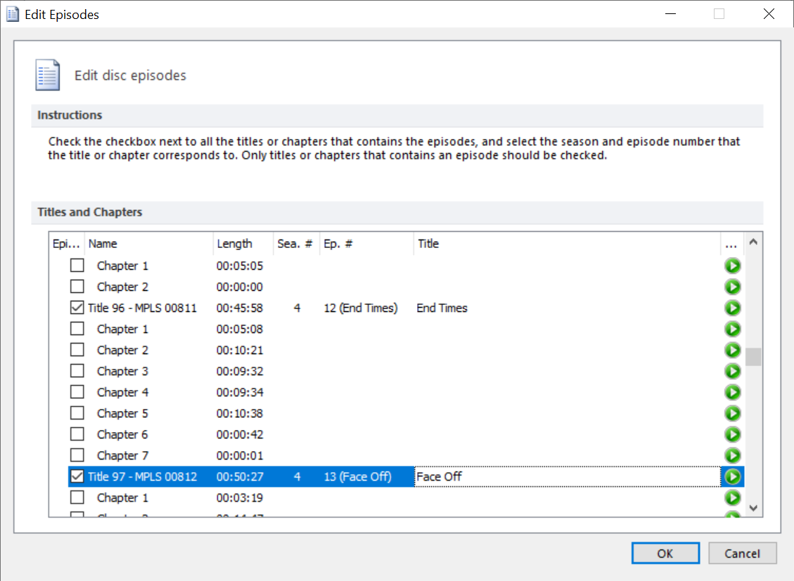

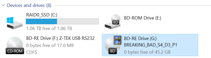

I needed to map episodes for my Breaking Bad Season 4 Disc 3, so I popped that in and checked Windows Explorer, and sure enough drive G:\ showed the disc was inserted:

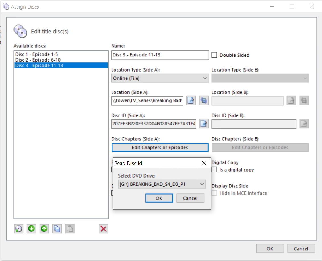

And the final test was to see if My Movies would read the Disc ID and Chapter indexes from it. Sure enough, the "Select DVD Drive" prompt included my networked USB Blu-ray drive, drive G:\
Success!!!
