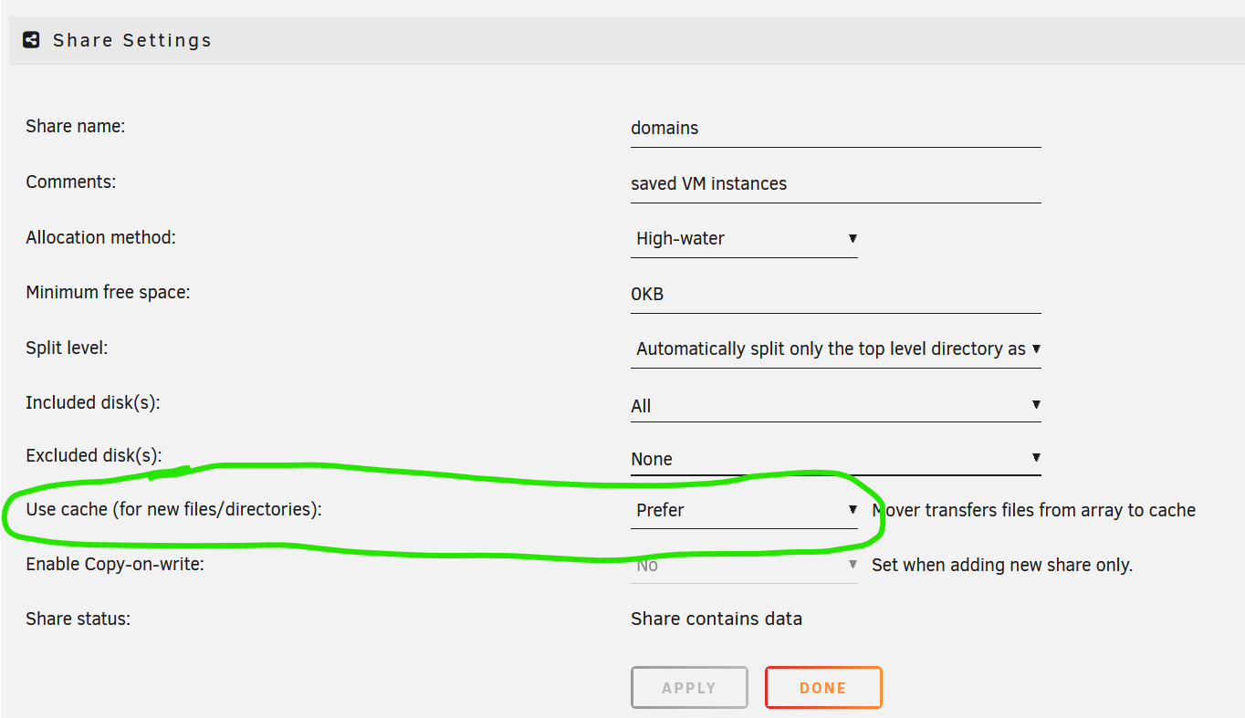

Manni wrote: Mon Jan 03, 2022 3:29 am Last question, do you know how to move a VM? I’ve created it in the array for testing, but I’d like to move it the cache SSD as soon as I’ve enabled it, along with a few of the shares that I know will remain small.
A VM is just some files in a directory. Should be easy to move. Easiest way is actually to change where your "domains" share is stored (set "Use cache" to Prefer):
That does assume you actually put your VM in your domains share (that's the default), and that in total all of your VM's are small enough to move the entire domains share to the cache drive. If you did something different, you would need to manually move the files, then update the VM to point at the new file location.
I'd also recommend making a backup of your domains/VM's into your array, for safe keeping.
