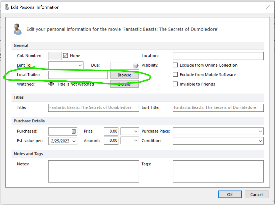

But I have a habit of double-checking things before I write, and I just discovered something that somehow I've never noticed before. I was thinking how it could be nice if the YouTube Trailer ID allowed us to use a local filepath. But then I thought, "there's no way that Binnerup would allow us to put local data in a global field that would update all users worldwide". Then I thought to myself, "no, Binnerup would put local data in the Personal Data section, that way it is specific to each user"...
So, while on a Movie, I clicked Personal Data, mainly to see where a good spot to put it might be, but also to consider if an existing field could be repurposed for our needs. Low and behold, what did appear:
It already exists!

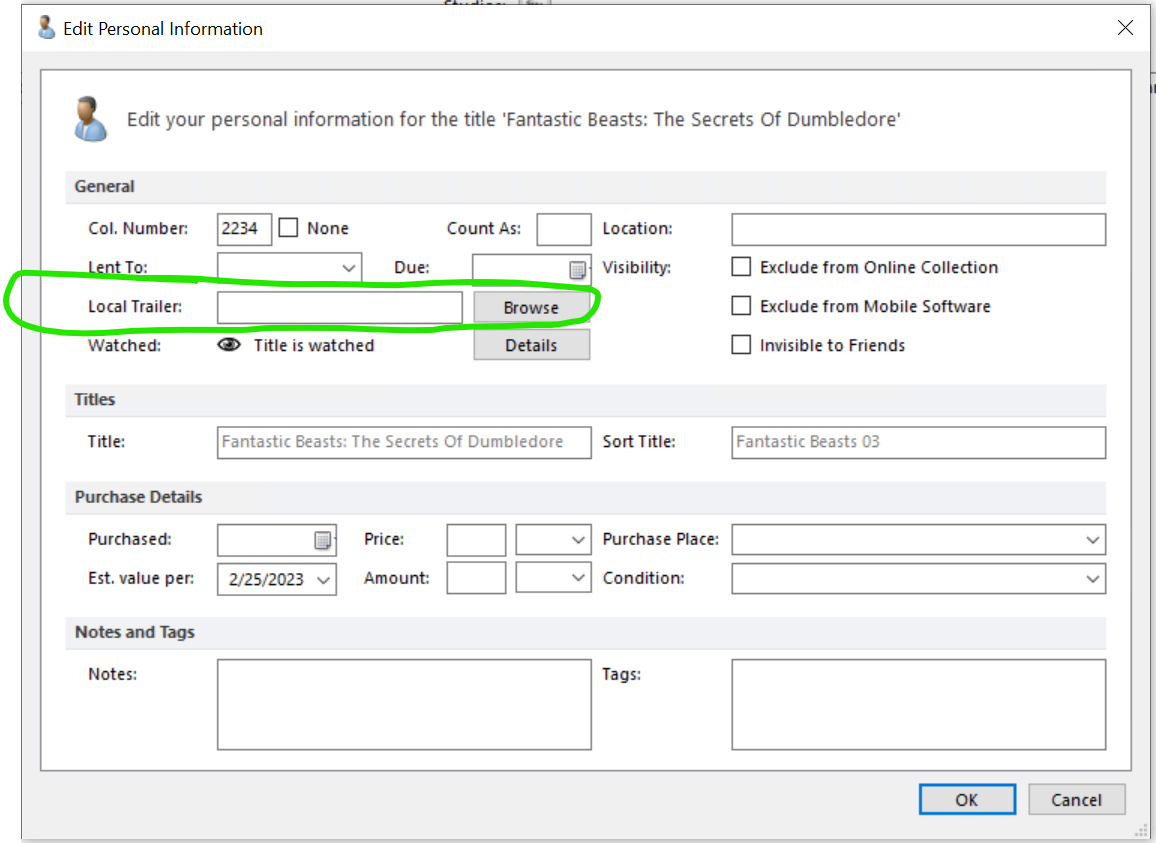

Then, out of curiosity, I checked the Personal Data options for a Disc Title too:
I know that looks like two copies of the same image, but trust me they are slightly different, one for the Movie (lowercase "of" in the movie title at the top), and one for the Disc Title (incorrect uppercase "Of" in the disc title at the top). All the options seem the same. So, there are literally two different places the local trailer path can be stored.
That said, currently CMC/CCC doesn't make use of this data. But I will add this to the next version!!! To be honest, I'm sure I've noticed this data tag before in the My Movies XML data, but didn't pay much attention to it because I doubted anyone would bother maintaining local trailers. You've proved me wrong.
I will have to make it behave so that certain values override other values, since the movie trailer can come from 3 different sources. I will give it the following priority:
  1. Disc Title - Personal Data - Local Trailer
  2. Movie - Personal Data - Local Trailer
  3. Movie - YouTube Trailer ID
So you can go ahead and get started on maintaining this data in your collection, and then when the next release comes out, it will begin using it.

Local Trailers can be assigned in My Movies to either the Movie or the Disc Title. For either Discs or Movies, click the "Personal" button at the bottom of the screen to find where to enter the Local Trailer info (see screenshots earlier in this thread).
If you have a movie in multiple formats, you can assign the Local Trailer to the associated Movie just once, and it automatically links to all Disc Titles (i.e DVD, Blu-ray, UHD, Director's Cut, Unrated Edition) that you might have for that same movie. Otherwise, if you only have one copy of a Movie, you can assign it to the Disc Title itself.
