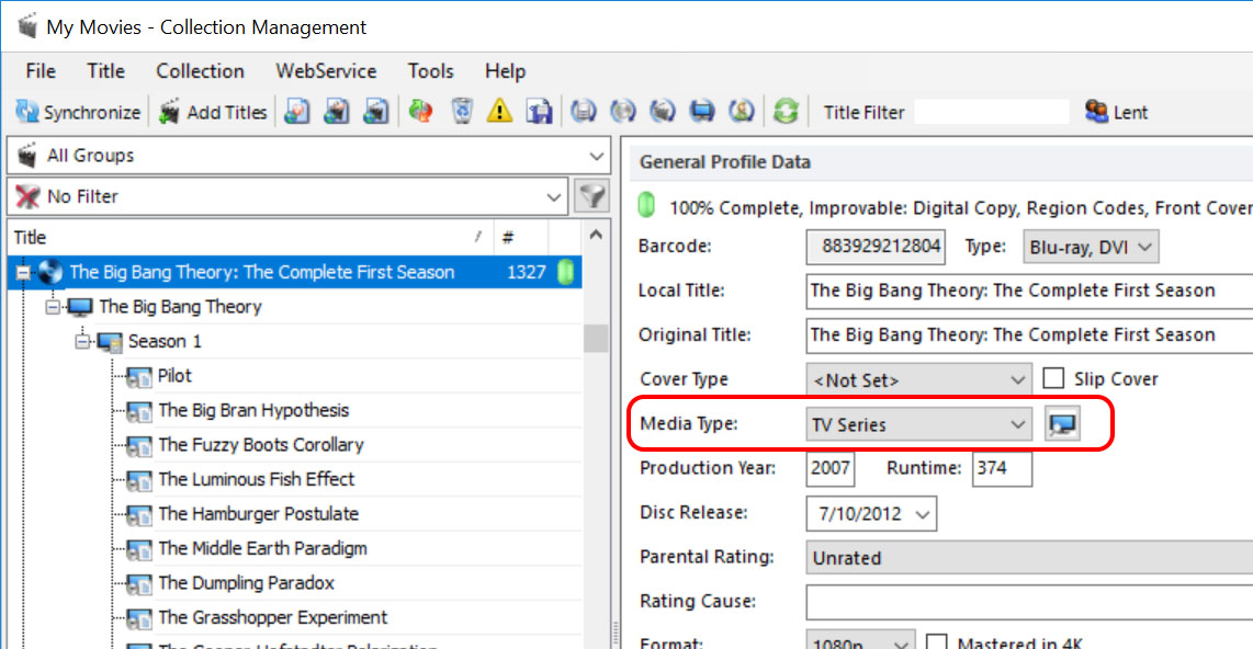

You can tell when a TV Series has been linked to a Title by the blue TV Series icon, circled in the screenshot below. Note, the TV Series icon will only display if the Media Type is set to TV Series.
A blue TV Series icon indicates that a TV Series has been linked to this Title.

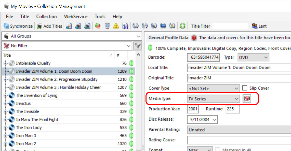

Sometimes, the TV Series assignment is missing, indicated by the red icon:
A red TV Series icon indicates that a TV Series has NOT been linked to this Title.

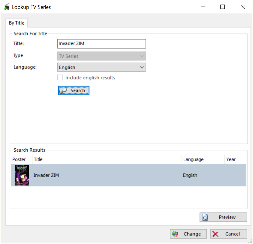

If the TV Series is not assigned, then this Title/Disc will NOT show at all in MM Browser v1.8. This must be fixed! Luckily, this is really easy to do. Click the red icon to bring up the Lookup TV Series search box:
Use the Lookup TV Series search box to link a TV Series to a Title.
Simply enter the name of the TV Series in the "Title" search box and hit the Search button. My Movies will bring back a list of TV Series that match your search. You might get multiple matching results, and you will need to select the correct result from the list. Once you have the right TV Series selected, hit the Change button.

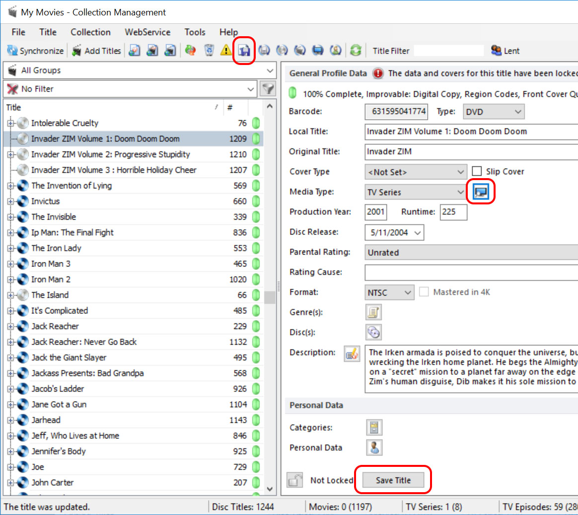

Back on the Title data, you will notice that the TV Series icon has turned blue. You're not quite done, though, as you need to hit the 'Save Title' button at the bottom.
TV Series is linked, but Title still needs to be Saved
