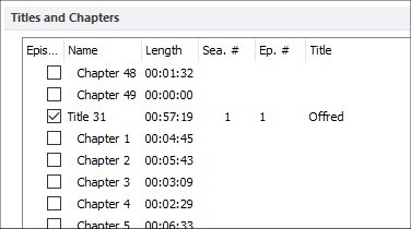

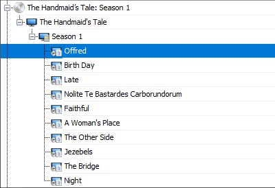

I'm going to use The Handmaid's Tale to illustrate the issue I have. As you can see in the following diagrams, I have seasons 1-4 on DVD. Each DVD season has a disc profile and all episodes are mapped, so there is a child season profile for each disc title as well. The individual episodes have all been ripped to MKV files. I also have season 5 but it consists of digital downloads only, so there is also a root-level TV series profile to accomodate those. This is expected My Movies behavior.

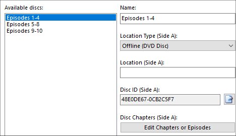

You'll notice on the discs dialog above that I have them listed as offline discs with empty location fields. This is because I don't use disc images, but instead rip episodes to individual files. The file paths for these are in the individual episode profiles as illustrated below. Season 5 is mapped the same way, but because they are not disc-sourced, they can only appear under the root series profile. This is also expected behavior.

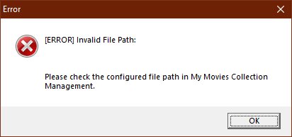

The problem I'm encountering is that all season 5 episodes will play just fine, but all season 1-4 episodes will not and generate the following error. I can only presume that this is because I mark the discs as offline, although since the episode profiles still show a file path to the individual MKVs and this is the same field that would be used to play the non disc-sourced episodes, it makes no sense to me why the disc-sourced ones won't play.
