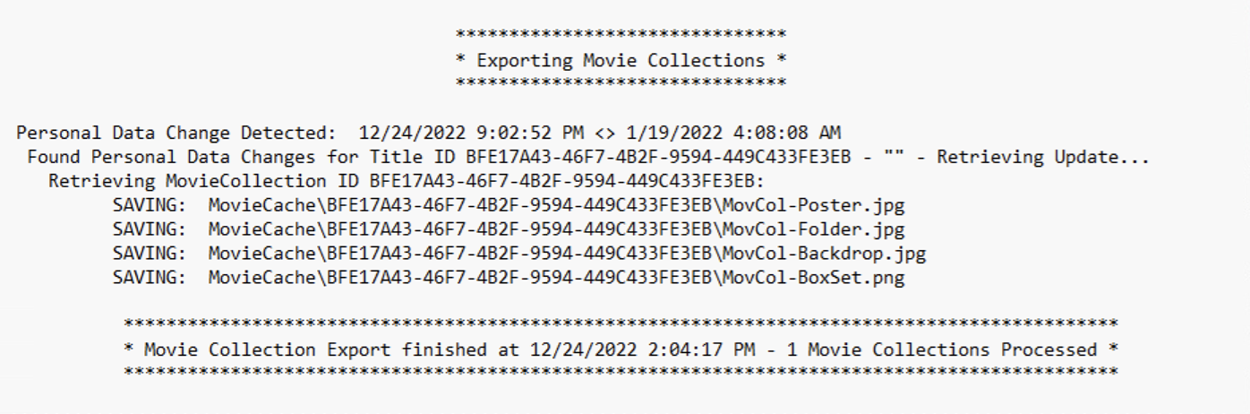

This is the export from the SAW collection after all of that.
Shouldn't that have SAW in it somewhere?
Either way it works. As always, thanks for all the help.

Yeah, it definitely should say "SAW" in there, right between the double quotes after the Title ID.

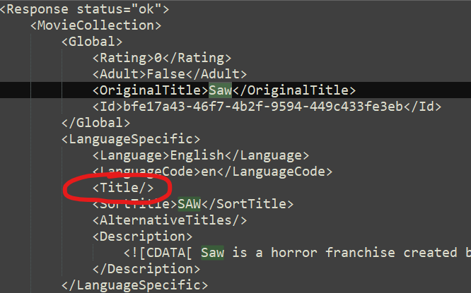

I think this is what you asked for....
Kevin

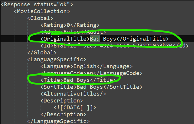

Ok, I took a close look at the XML data you posted, and I think I see the problem. In the LanguageSpecific section, the Title is blank:
While the OriginalTitle is populated in the Global section above that, apparently CCC is using the LanguageSpecific section for the Title.
I compared it to my Bad Boys movie collection, and I have both areas populated:
Looking in My Movies, I see all three areas, Global - Original Title, Language Specific - Title, and Language Specific - Sort Title.
I went back and checked your screenshots you sent me, and you had SAW populated in all three areas too. But that was before you deleted and re-added this movie collection, perhaps you left the Language Specific Title blank this time?
Now, in CCC I use the Language Specific Title as for users in other countries they want the title in their chosen language. I will improve CCC to do a fallback to use the Global Original Title if the Language Specific Title is blank, but that is really just a band-aid, and best practice here is you want to populate the Language Specific Title.

You are spot on, Language Specific Title is blank. That is on me as all I ever updated was the Sort title. I learn something every day (smile).
