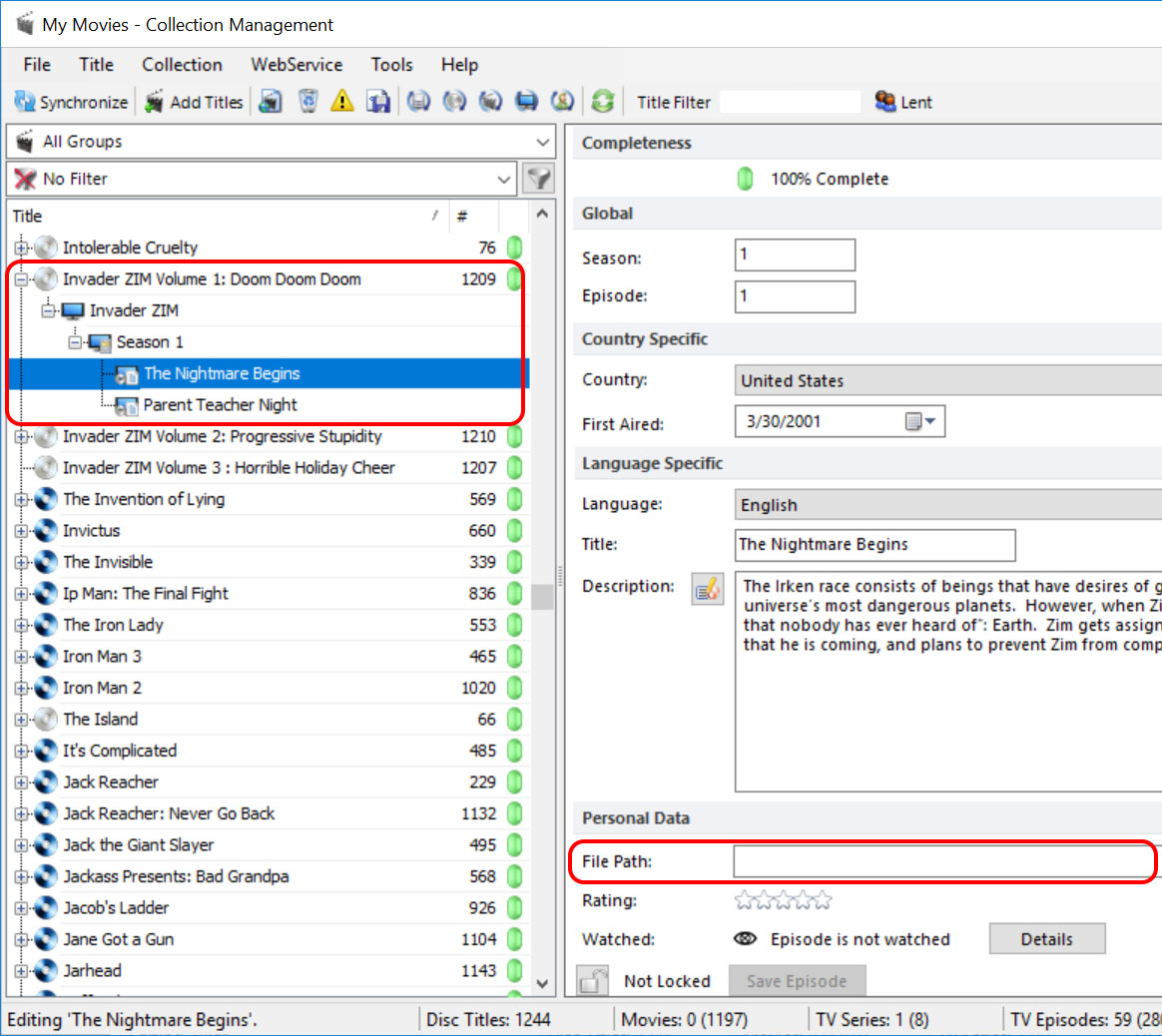

In the screenshot below, notice for the Title "Invader ZIM Volumne 1: Doom Doom Doom", the "+" plus sign is missing from the left of the Title's name. This is true even though this Title is already linked to a TV Series (notice the blue TV Series icon). We need to get the "+" plus sign to show up, which allows us to drill down to the Episodes.

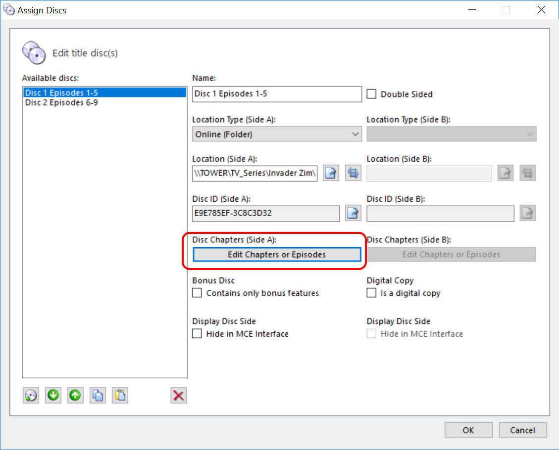

Click the Discs icon to open up the Assign Discs panel, same as we did in TV202:
Notice the missing "+" plus sign, which means we need to enable Episodes via the Discs icon.
Next, we need to select the "Edit Chapters or Episodes" button - you will need to do this for each disc:
Click the "Edit Chapters or Episodes" icon.

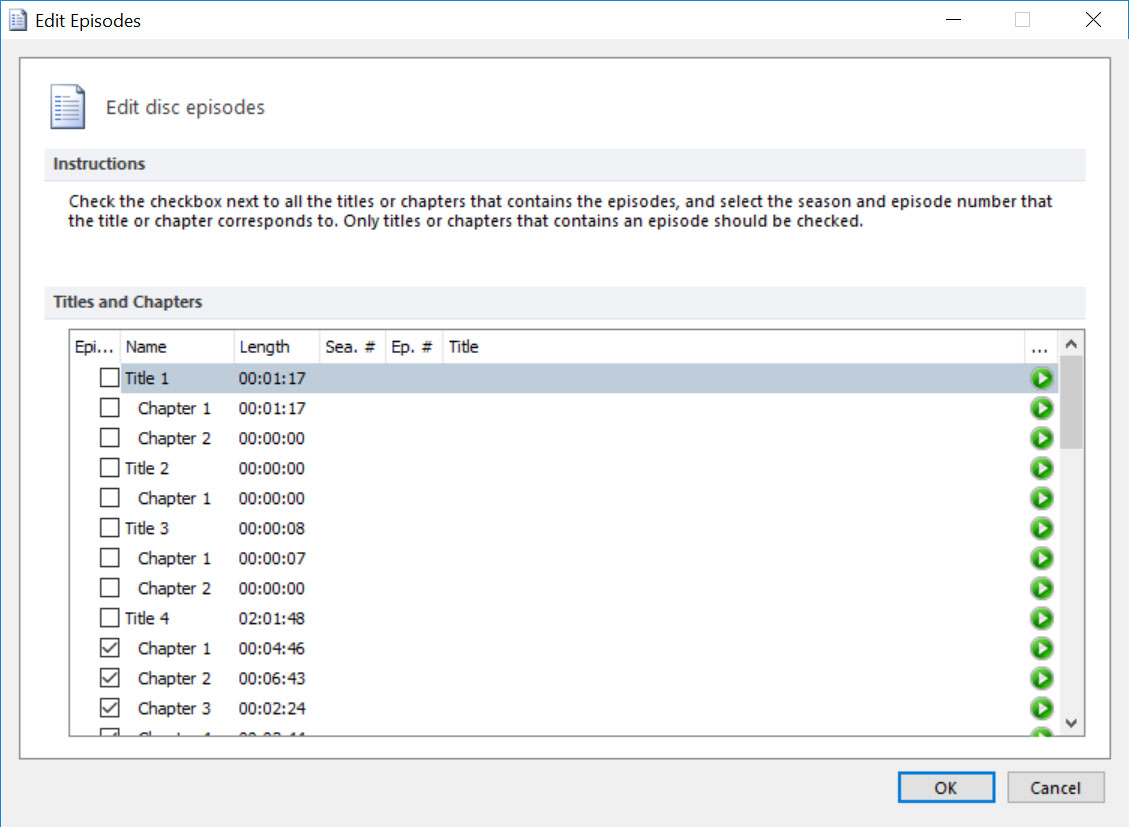

This will open up the "Edit Episodes" panel. Note that even though some Chapters have been selected by default for this disc, there are no Seasons or Episodes assigned:
The "Edit Episodes" panel, missing the Season and Episode assignments.

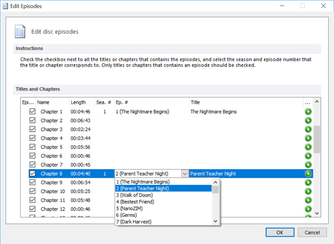

Back to the process: Once you identify an episode, you need to assign it. On the correct row, first make sure the Episode check box is checked, then select the Season, and finally select the Episode. Expect these episodes to be spaced out, and sometimes they will appear in random or reversed order:
Assigning Seasons & Episodes on the Edit Episodes panel.

As soon as you click 'Save Title', My Movies will download each episode you assigned, and the "+" plus sign will appear. Click the plus sign to drill down to the TV Series, then again to drill down to the Season, then again to drill down to the Episodes. Note that in the screenshot below, only the two episodes I configured are shown - you have to assign all episodes in the steps above to get My Movies to download and display them:
Expand the Title to drill down to the Episodes, where you will assign the Converted Media.

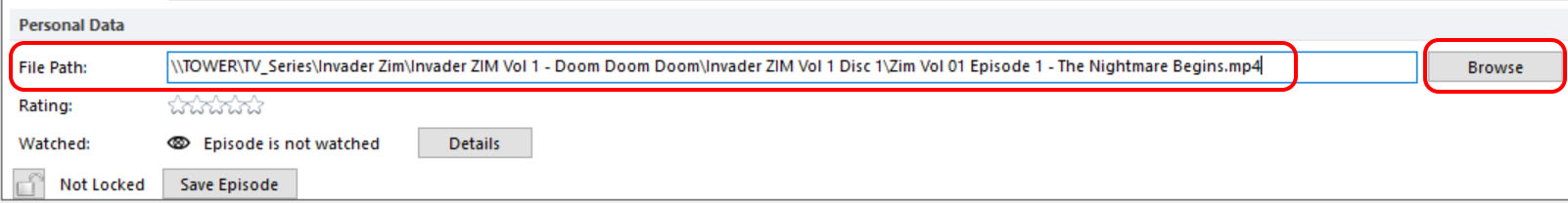

For each Episode, you will need to select it and then assign the Converted Media to the "File Path". The easiest way to do this is to hit the Browse button and navigate to the correct file and select it.
Assign the corresponding Converted Media file for each Episode to the File Path.
One you finished the assignments to all Episodes, be sure to click 'Save Episode'. Again, you can use the 'Save Meta-Data' button to update the mymovies.xml meta-data files immediately.
