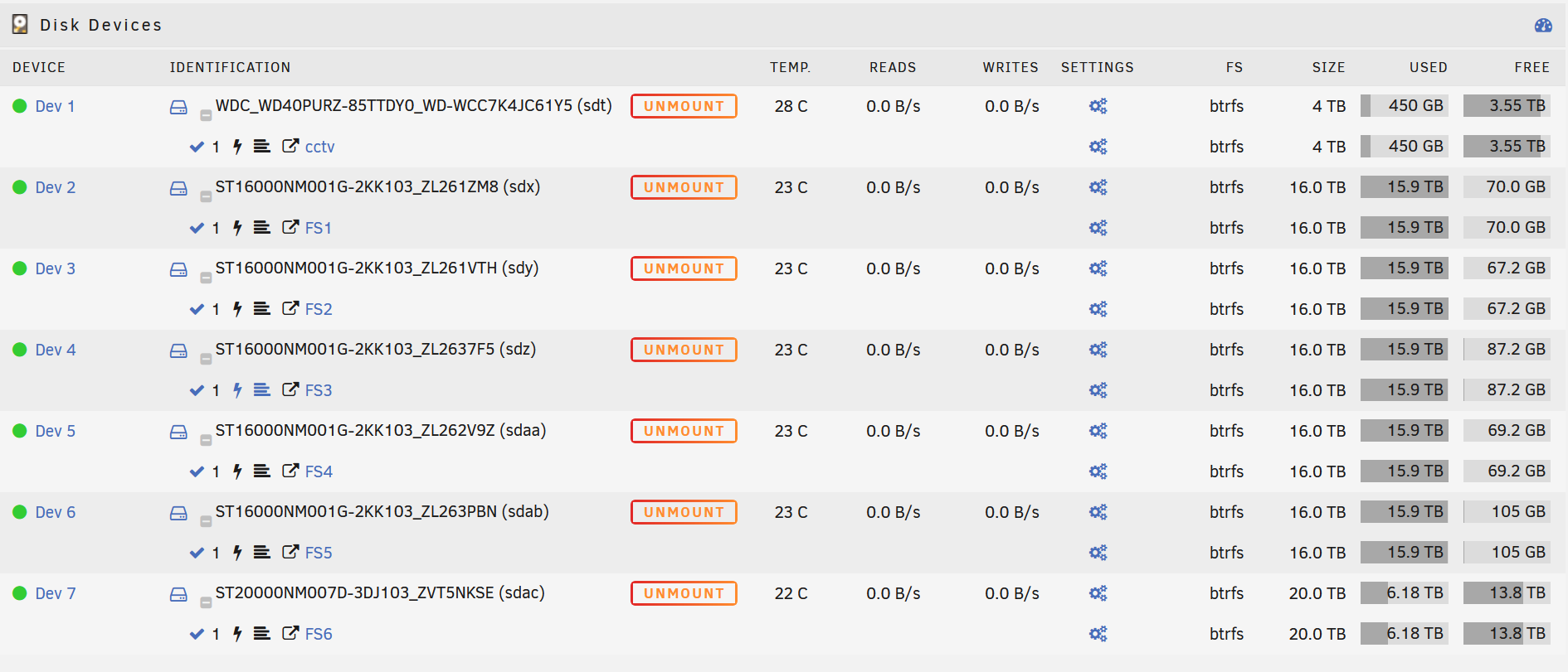

My movie collection backup has completed, and I'm very happy. The first 5 drives are filled sequentially to the brim, utilizing about 99.5% of available space on each drive, and I have almost 14 TB of free space on the 6th drive, FS6.
None of my backed-up data is striped or split across any drives, so worst case if I lose a drive is I only lose the backed-up data on just that drive.
While it looks like I have enough room for a couple more movies on each drive, I'm not sure that space is actually accessible. FS4, which has 69.2 GB free, errors every time I try to copy another ISO to it, as soon as the free space drops below 65 GB. This is the issue I first noticed with the Sling Blade ISO erroring while writing to FS4, but I mistakenly attributed this issue to MergerFS. I've now determined that this is not a MergerFS issue. Without MergerFS even running, I can interact with all 6 drives individually, FS1 to FS6, and it is via direct access that FS4 errors anytime I go below 65 GB free.
I have seen one of the other drives, FS2, drop as low as 12 GB free during some of the backup activity, so I'm not sure why FS4 is behaving this way. But ultimately, I'm hesitant to try and utilize that last half-percent of free space, I'd rather leave it unused for future backup activity to sync changes.
