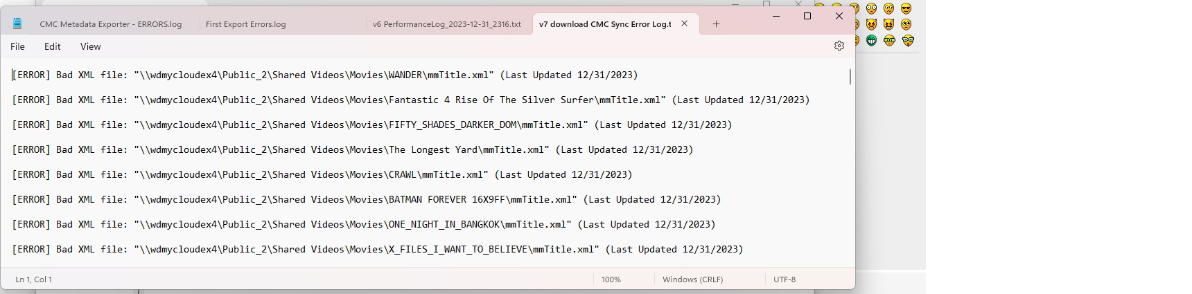

Opened CMC and ran a sync, received errors on all titles for bad .xml mmTitle.xml.
all title error.jpg (182.18 KiB) Viewed 50966 times
Cleaned the metadata just in case there was a problem with overwriting data file. Exported again and received no errors with export. Screenshot shows updated metadata for MMCM and CME.

Ran a sync and same problem again.

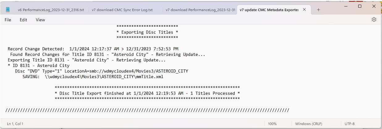

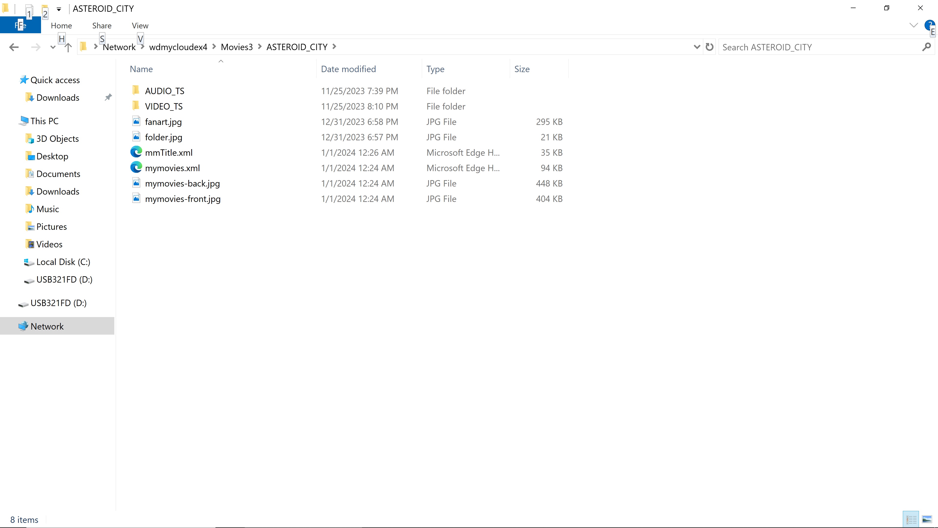

So I decided to check the operation of export and sync. Changed the title of a movie in MMCM by adding a space. Saved the metadata and exited. Opened CME and exported changes. That title successfully exported.
export successful.jpg (129.02 KiB) Viewed 50966 times
Synced with CME and it gave an error for that title as bad .xml as before. All others are still fine.
one title error.jpg (49.28 KiB) Viewed 50966 times

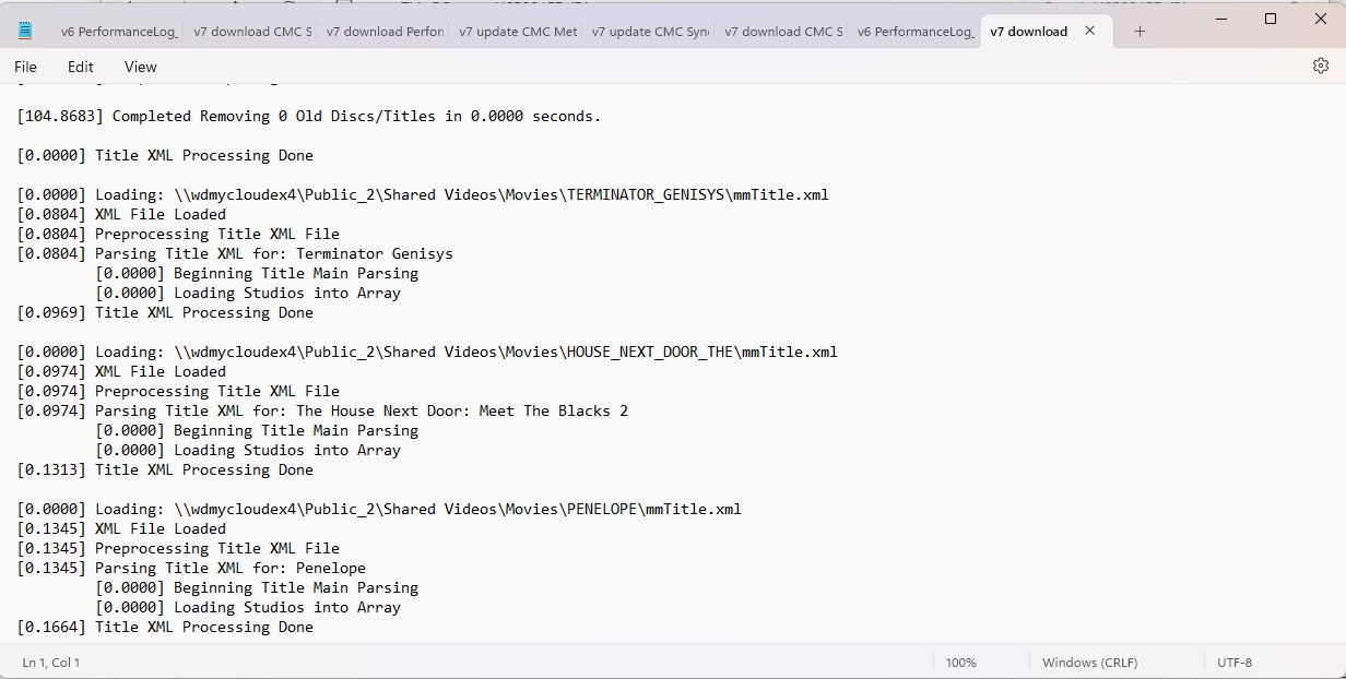

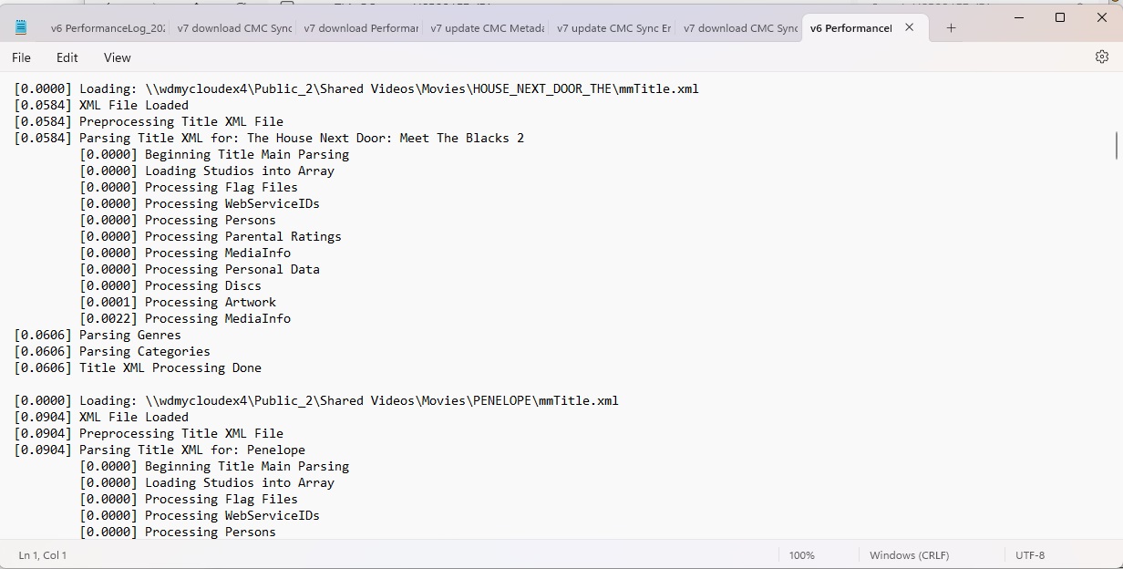

One thing I found in the logs is during performance logging, in v6 it loads all the information from the metadata
v6 loading titl xml data.jpg (159.92 KiB) Viewed 50966 times
but in v7 it is not loading information
v7 loading titl xml data.jpg (164.1 KiB) Viewed 50966 times

Pauven wrote: Mon Jan 01, 2024 11:30 am It also sounds like there may be a bug in v7 where it's erroring when reading the CME XML files. I'll have to look into that. Did you find any error files in the CMC folder or Logs subfolder?
From the screenshots earlier, it appears that is what is happening. I had a thought this morning and ran v6 CMC_CME, and did a smart sync for changes(from last nights v7 CMC_CME export). It found the changed title and synced it with no errors. It is only v7 CMC_CME that is having a problem reading the file.
Pauven wrote: Mon Jan 01, 2024 11:30 am Also, are you using CME v7 or CME v6? I can't quite tell from your screenshots.
Looks like I misplaced a couple pictures. The first screenshot is v6 performance log(from v6 CMC Logs folder), it shows loading the database correctly
v6 loading titl xml data.jpg (159.92 KiB) Viewed 50957 times
The next screenshot shows v7 performance log (from v7 CMC Logs folder) not loading the database
v7 loading titl xml data.jpg (164.1 KiB) Viewed 50957 times
The error files are both coming from v7 CMC Sync Error logs (from v7 CMC Logs folder)
all title error.jpg (182.18 KiB) Viewed 50957 times
one title error.jpg (49.28 KiB) Viewed 50957 times
