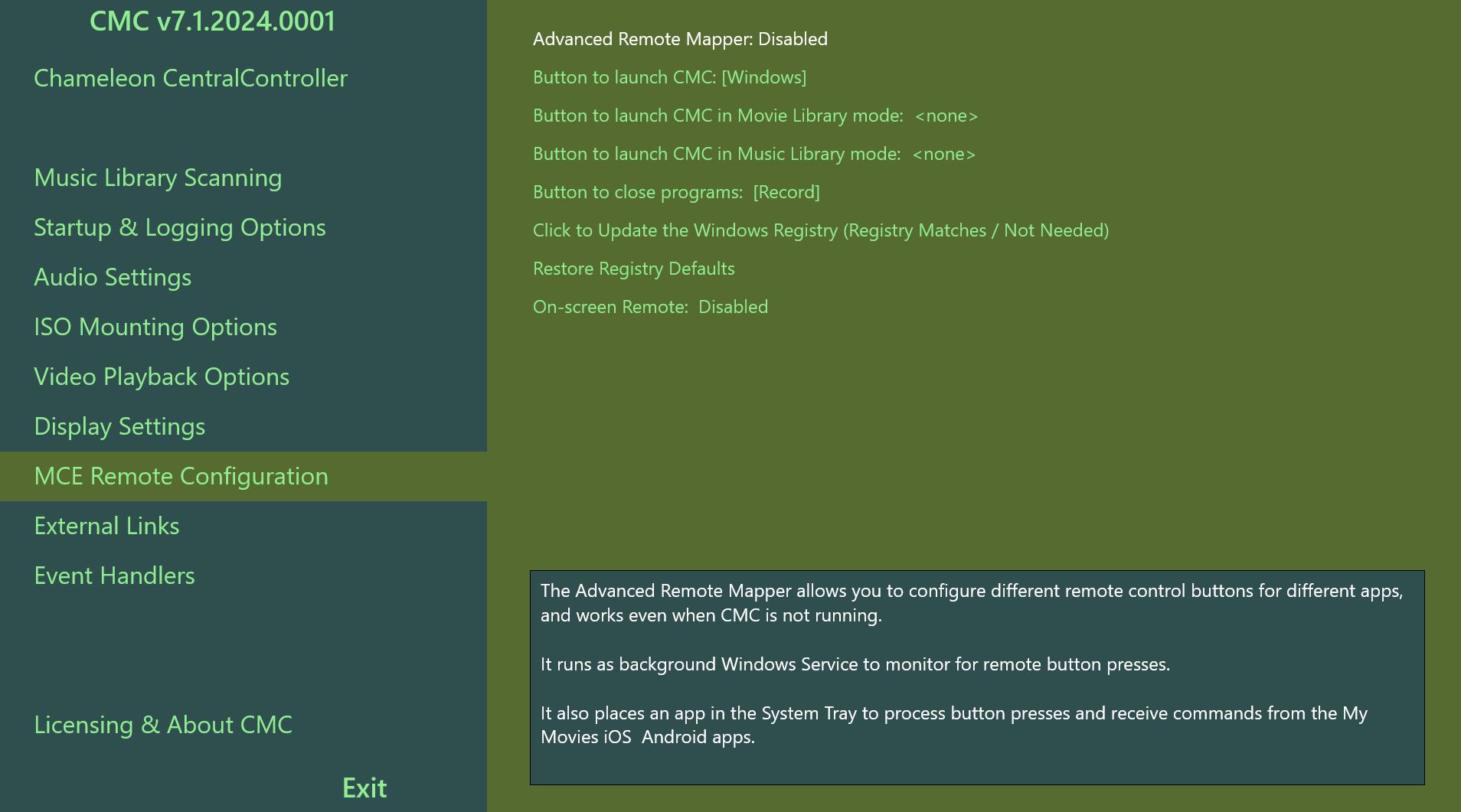

I have a new problem for you. I have been using CMC_CCC successfully (except for PowerDVD 22 freezing sometimes, not CMC fault), and decided to map MCE Remote buttons to make things easier.
Steps used are as you state in your forum, open in admin mode, select mapping choices, save settings, update registry, reboot.
I mapped them (in admin) and it reported "registry matches/not needed"
CMC Screenshot before reboot.JPG (139.48 KiB) Viewed 18200 times
I then rebooted and no buttons. Went back in (as admin) to settings and it said they did not match "registry update needed".
CMC Screenshot after reboot.JPG (142.59 KiB) Viewed 18200 times
Tried again, same result.

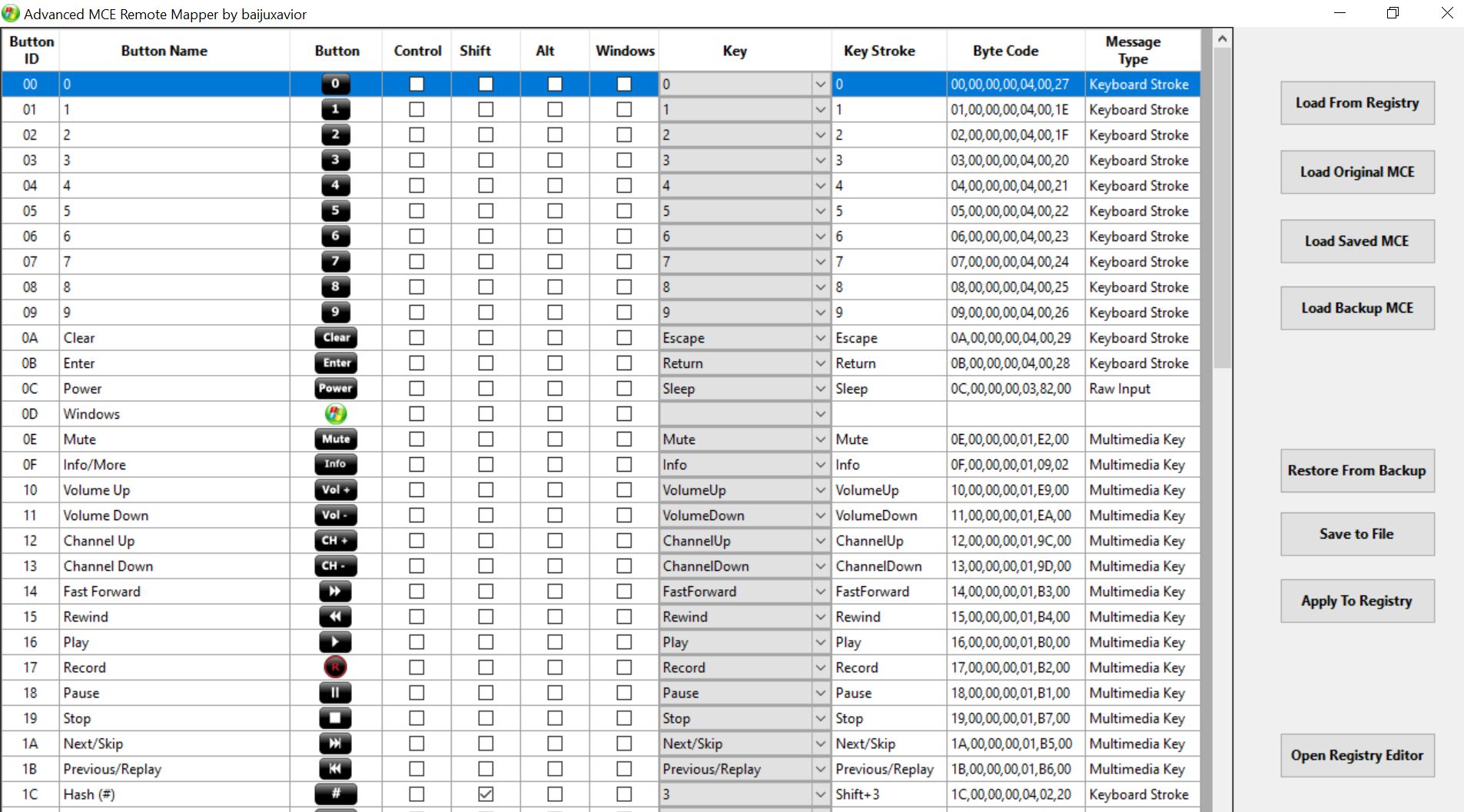

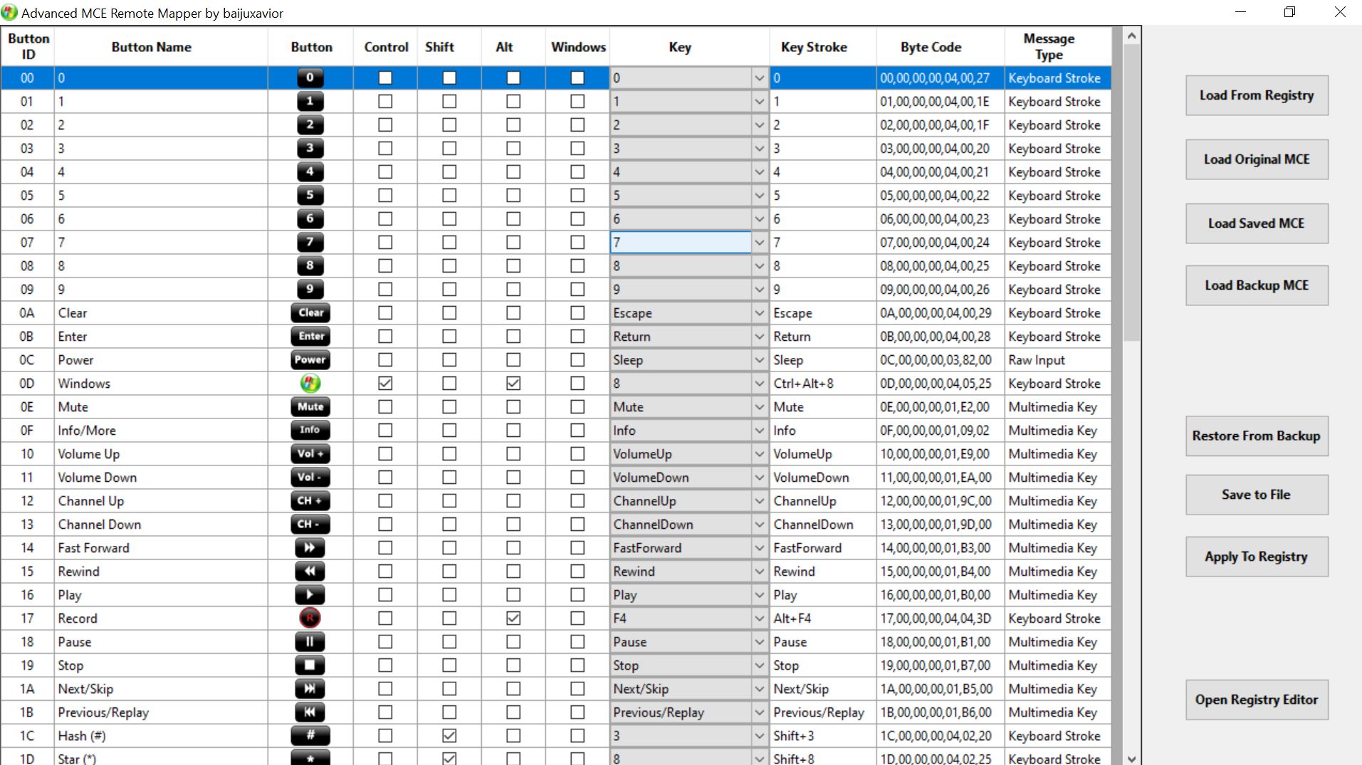

I then downloaded AdvancedMCERemoteMapper and compared settings. Here is the screenshot before reboot
mcemapper screenshot before reboot.JPG (331.04 KiB) Viewed 18200 times
and here is the screenshot after reboot
mcemapper screenshot after reboot.JPG (317.41 KiB) Viewed 18200 times
I tried to use the MCE Mapper to make the changes but same result, after reboot, the changes revert back to stock.

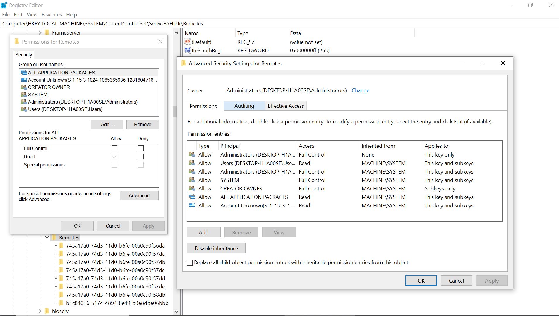

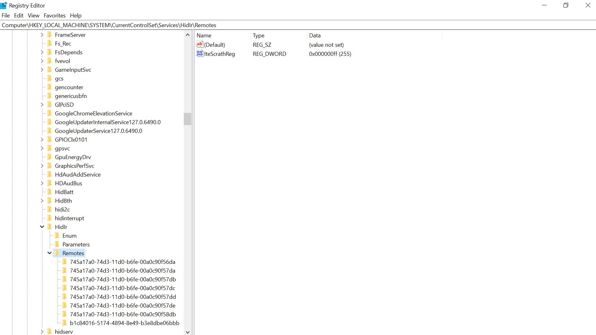

Made the mapping changes and booted to safe mode/minimal with no change. Made changes in safe mode and rebooted to safe mode again with no changes. So that should put other software to rest since nothing booted
Tried setting permissions in registry, set system to read only and full permissions for everything else (users, administrators) with no change
Turned off secure boot in bios with no change.
It has to be in the registry settings somewhere, here is a screenshot of my settings, how does it compare to yours?
Registry screenshot1.JPG (143.66 KiB) Viewed 18188 times
Registry Permissions.JPG (277.3 KiB) Viewed 18188 times
Next step I can think of is deleting the 56da string in the registry as described in the kodi thread mentioned above, since CMC is writing to the 57da string
I went ahead with Deleting the 56da string and rebooted, it just recreated a 56da string but missing info in it. Deleted the 56da string and renamed the 57da to 56da and rebooted and it created a 57da string but missing info, 56da string stayed the same as i had renamed it. All throughout I tried to map the buttons with no luck.
Imported the original strings back and and everything is as it was before. This tells me that I can make changes to the strings but windows is rewriting the strings on reboot for some reason. That leads me to the driver for the IR. I had read a post about the driver needing to be rolled back to an earlier driver for the NUCs, I will see if I can find that forum again and post the link to that discussion and see what you think.
update: it turns out the driver discussion was in the same post from kodi above, I will play around some more and see waht I can come up with.
