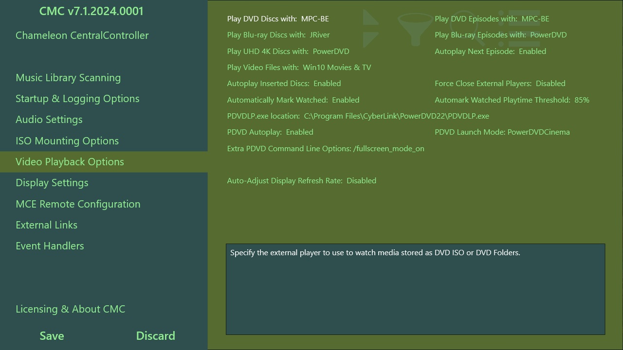

CMC supports both MPC-BE and MPC-HC, perhaps you selected the wrong one, or the one you have installed is not being found. In Settings > Info you can show the detected players, that would be helpful here.
I usually install both MPC-BE and MPC-HC. This time I just installed MPC-BE. My guess is that if I install MPC-HC the error would not occur.

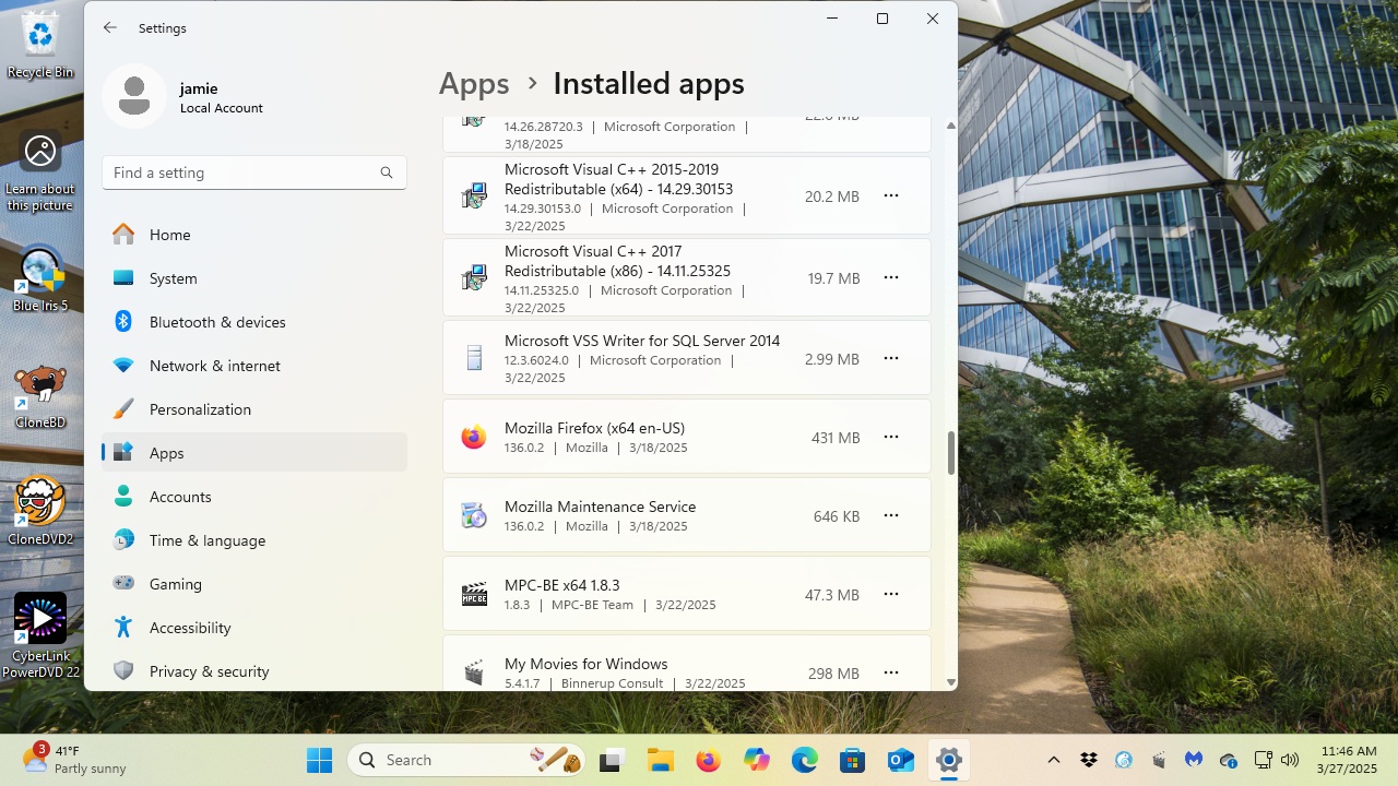

Here is a screenshot of my installed apps including MPC-BE.
Here is a screenshot of my player setup
cmc-playback settings.jpg (139.57 KiB) Viewed 20090 times

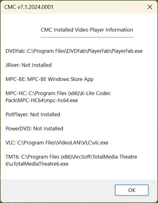

I need to see Settings > Licensing & About CMC > Show Video Player Info
Should look something like this:

Post by Jamie » Thu Mar 27, 2025 9:00 pm
funny, it says mpc-be is not installed.

Excellent! (but only because that's what I was expecting).
So the mystery is why CMC isn't seeing MPC-BE.
I did make a change in the 7.1 beta to detect MPC-HC installed via the K-Lite Codec packs. But that should be irrelevant for MPC-BE.
You mentioned it was installed normal. Can you provide a link to the version you installed?
And I also need to know where your "mpc-be.exe" lives.
