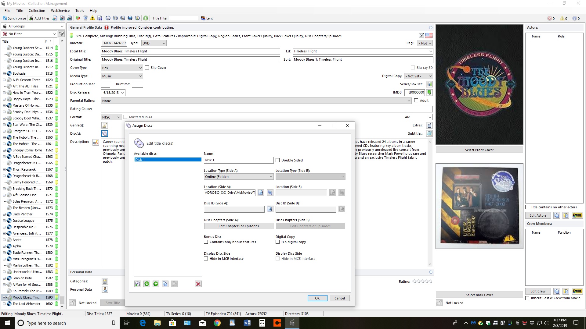

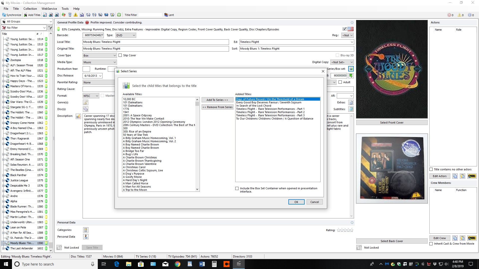

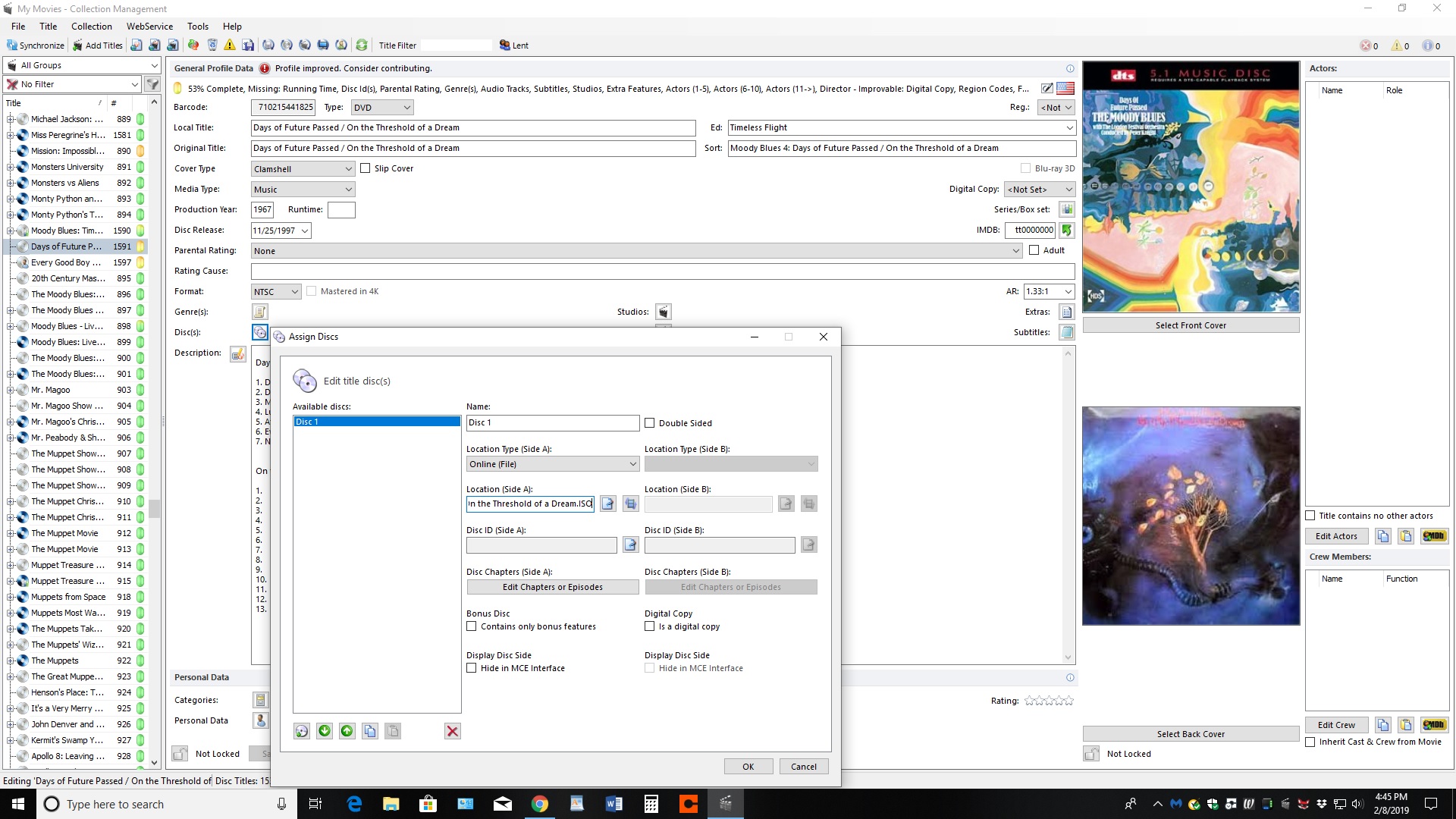

Here is how I set up a boxset for a music boxset. You should be able to do this with any file type
1. Boxset title timeless flight
2. Boxset individual titles
3.. Days of future past individual title
add more title as you did the first one

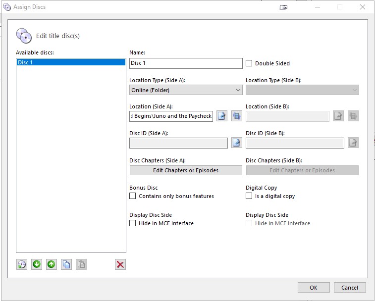

If you try to add the "Juno and the Paycheck" in My Movies, it isn't found and so no meta data exists for the title. As My Movies often does, it tried to match each word of the title and selected "Paycheck" as the match. I don't know why it didn't select "Juno" since I have that title too.
If there's no meta data in My Movies, my thought is I need to create it manually so CMC will have what it needs to work with the titles.
I have included a screenshot of the "Juno and the Paycheck" title I added to the "Alfred Hitchcock - The Legend Begins" in My Movies. Tom

tombean wrote: Fri Feb 08, 2019 5:30 pm If you try to add the "Juno and the Paycheck" in My Movies, it isn't found and so no meta data exists for the title...If there's no meta data in My Movies, my thought is I need to create it manually so CMC will have what it needs to work with the titles.
This sounds correct. Every so often you come across a title that doesn't exist in the My Movies centralized database. You get to fill out the details yourself, and Contribute them so that all My Movies users can benefit. And Binnerup gives you points for contributing a title.
The important thing to know here is that you want to add the meta-data through the MMCM GUI, and not try to do anything manually externally to MMCM.

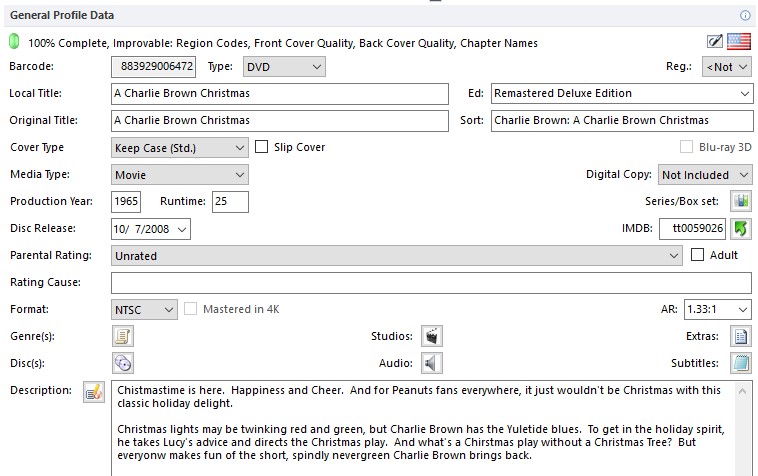

I have another question about the following error:
"[ERROR] A title set as a 'TV Series' is missing the required TVWebServiceID: "A Charlie Brown Christmas"
Overriding Media Type, setting to 'Other Media Types' to force title to display in CMC.
Please assign a TV Series to the title in My Movies to enable TV Series Grouping."
I have attached a screenshot of the My Movies information about the title and its Media Type is Movie not TV Series.
I checked the listing in My Movies and it says it's a "TV Series" but it won't let me update the information in my system. "Change Title Source" says "This title already exists in your collection." I tried changing the Media Type to "TV Series" in My Movies and ran a Full Sync in CMC but the error persisted.
What can I do to fix this error?
Tom
