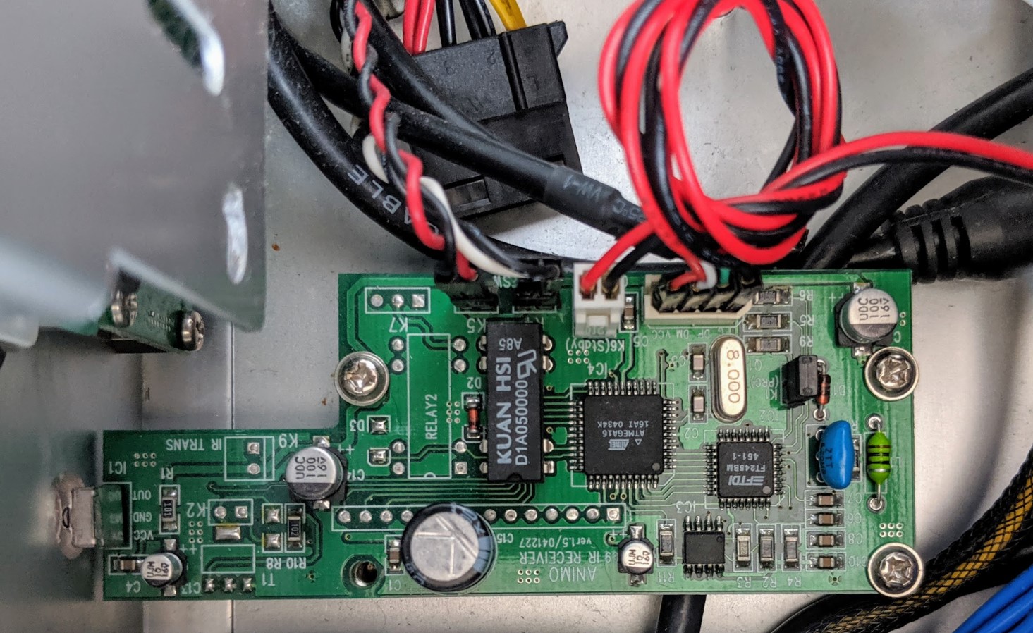

I give thanks to OrigenAE for last night's insanity, though I do arrive on the other side with a newfound realization. Origen's IRTrans IR110 is a dead product, unless you want to time travel back to Windows XP/Vista.
I was able to get the USB drivers installed easily. The IR software, both Origen's legacy version and IRTrans' current version, also installed without a hitch. The problem, then, is that the software is refusing to talk to, or even acknowledge, the hardware. I spent hours troubleshooting this issue, at one point I even had my voltmeter out to test the connections. IRTrans goes on record saying that OEM products, like Origen's IR110, must be supported by the OEM and that IRTrans can't help. Origen's website hasn't seen updates in years, so they seem to be on life support if they aren't already dead. And I finally noticed on the IR110 product page that it clearly states XP/Vista only. Doh!

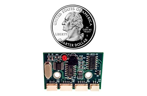

The PC-IRS-01 looked perfect! It's hardware native RC6. It's super small, and would probably mount easily behind the X15e's light-hole (if I rotated it vertically), and it can use IR receiver sensor extenders, guaranteeing it will fit any case. All of this doubled my frustration that the funding was unsuccessful. :cry:
But then for some reason I clicked on the 'Updates' button for that campaign, and to my surprise I discovered that Inteset Technologies, the company behind the PC-IRS-01 Kickstarter campaign, said they were going to make it anyway!!! And here's a link to their page where you can read up on it and even order it: https://intesettech.com/index.php/produ ... ender-kit/
What could be better than that? How about this: it is available on Amazon for $32, has 4.6/5 star rating, and with my Prime free shipping it will be here tomorrow!

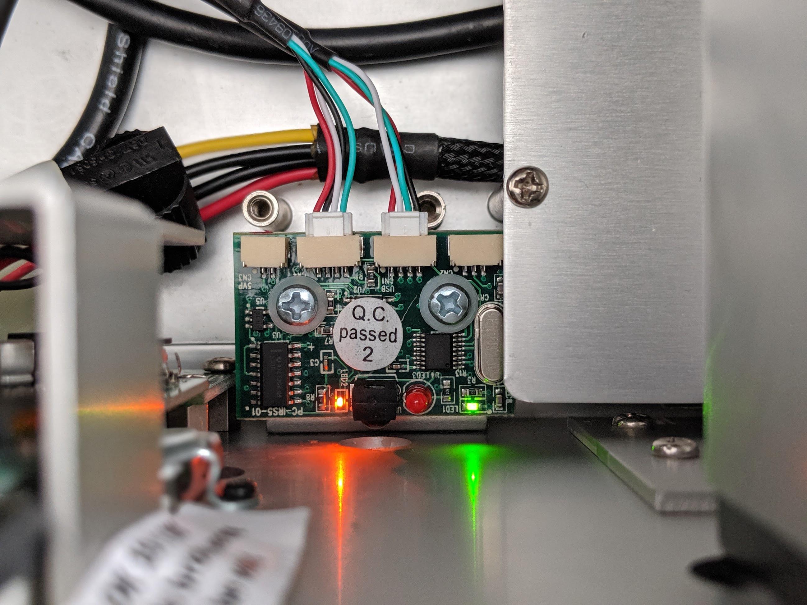

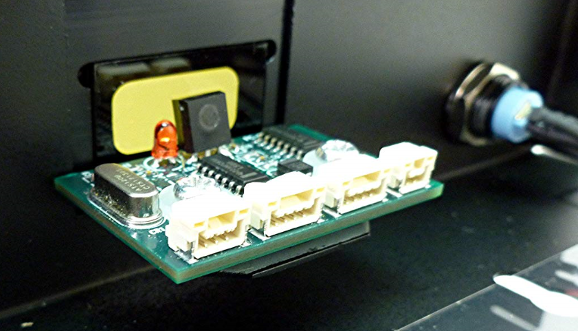

I was able to get the Inteset PC-IRS5-01 working successfully on my HTPC.
I had to take a Dremel to the mounting bracket, which was a couple millimeters too long, and was hitting the mounting posts for the original Origen IR110 PCB. Once I had the clearance I needed, I used some Scotch permanent double-sided tape to mount the bracket inside the case. I like this tape, which is thin just like regular Scotch tape, unlike normal double-sided mounting tape which is 1-2 mm thick. I use this for lots of projects.
I got lucky and my USB header still provides power after the PC is shut off, so I didn't need to run a separate 5V power supply - I think I enabled this by configuring the BIOS to allow USB to wake the PC. The only downside to this is that if you fully cut power to the power supply (i.e. electricity goes out or you flip the switch on the power supply), then when power is restored my motherboard does not provide USB power. It only provides power if the motherboard has already been booted, then shut down. I guess the BIOS is only enabling USB power after the first boot, and the setting is lost if electricity goes out. I can live with that.
Here you can see it installed in the case, and the power/connectivity LED's are lit even though I've shutdown the PC:
Inteset PC-IRS5-01 Installed.jpg (455.78 KiB) Viewed 21338 times
I can see that amber light shining through the sensor window, which let's me know it has power. I can also see the flash of the red led when I push buttons, so I can see it is receiving commands. All in all, that's worked out very well.
I'm pleasantly surprised that the IR sensitivity is very good, and even seems to pick up button presses when I have the remote at oblique angles. That's not to say it couldn't be a touch better, the mounting bracket is preventing perfect sensor alignment with the light-hole (hehe). I plan to model and 3D print a new mounting bracket that uses the original mounting posts, and positions the sensor perfectly.
The best part is that the remote shows up as a Microsoft eHome receiver, so I haven't had to do any remote reprogramming, everything has been plug and play.

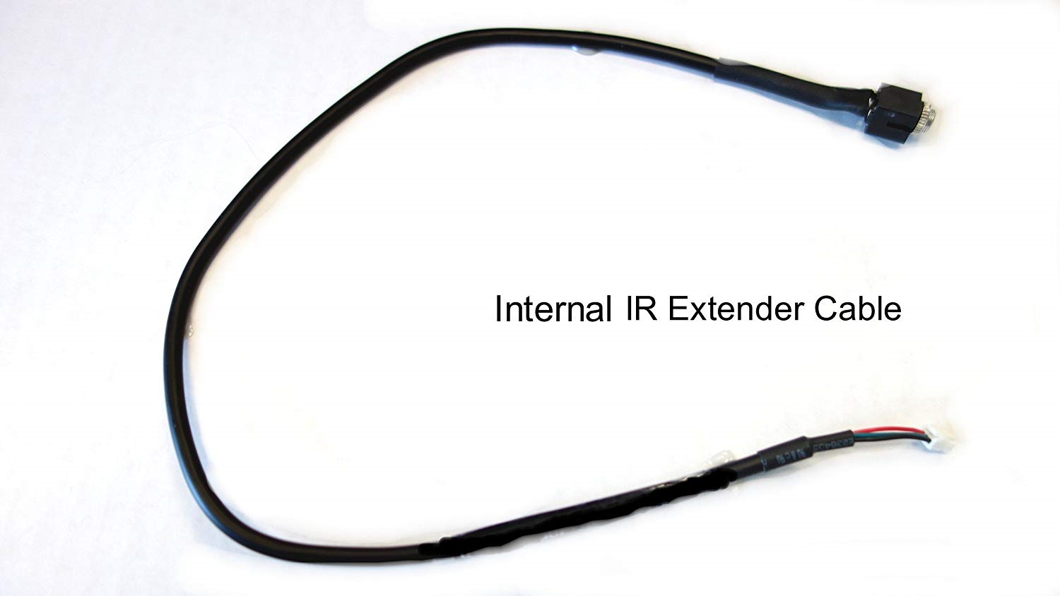

  • One of the cables was missing in my package - the internal cable for connecting the external IR receiver. I have no need for the external receiver (currently), though I wish I had the cable for future use if needed.

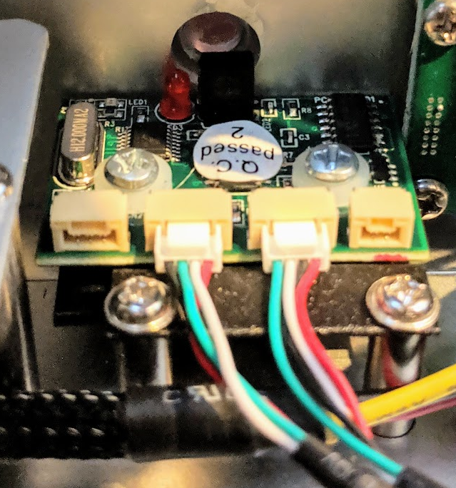

Post by Pauven » Mon Sep 02, 2019 4:10 pm
Here's an update on using the Inteset PC-IRS5-01.

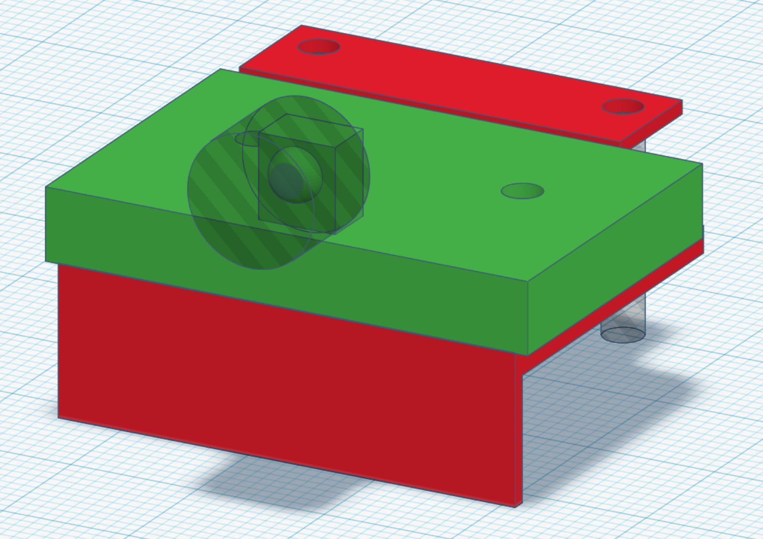

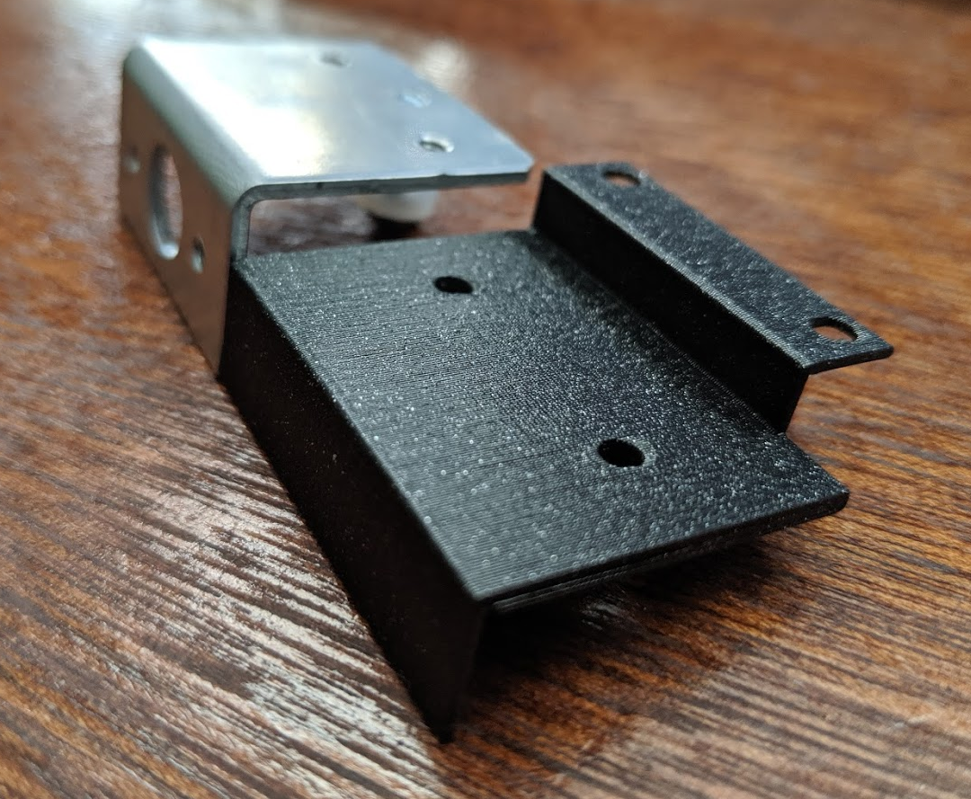

After a couple days, I was finding IR reception to be inconsistent. The IR sensor wasn't aligned well with the IR window in the case, and I decided I needed to go ahead and make a custom mount. Using the old Origin IR110 PCB and the Inteset PC-IRS5-01 PCB as templates, and with a few extra measurements from the Origin X15e case, I was able to mock up a design in Tinkercad.

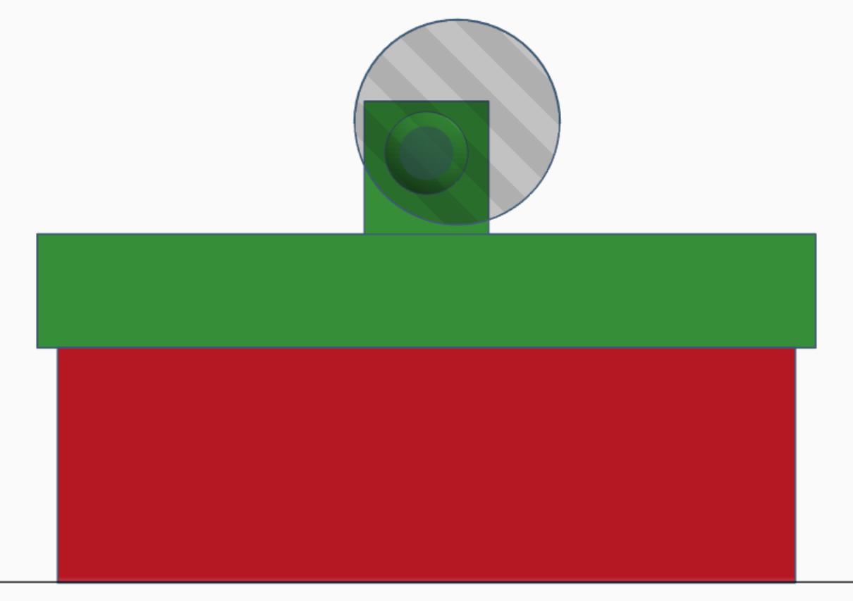

In the picture below, the green represent the PC-IRS5-01 PCB, the red is the part I'm modelling, and the transparent circle is the IR window in the case. I purposely positioned the sensor off center, low and to the left, since I normally sit up and to the right of where the case resides. This finely tuned position maximizes the sensor's line of sight with my seating position.
This next image shows a rotated view, approximately from my seating position, and the sensor is still in view in the center of the opening.
An hour and about $0.08 worth of plastic later, I had my new mount. Notice that the new mount positions the PCB lower, and closer to the front of the case (the IR sensor tip is positioned just inside the IR window), plus attaches to the available X15e mounting posts.
Here is the PC-IRS5-01 mounted to the 3D printed part (using the originally supplied stand-offs, which provide clearance for components on the bottom side of the PCB):
Here it is installed. Luckily my careful measurements paid off, as the IR sensor is positioned exactly where I wanted it, diagonally offcenter:
The new mounting position 100% resolved my IR reception issues. It now responds perfectly.
