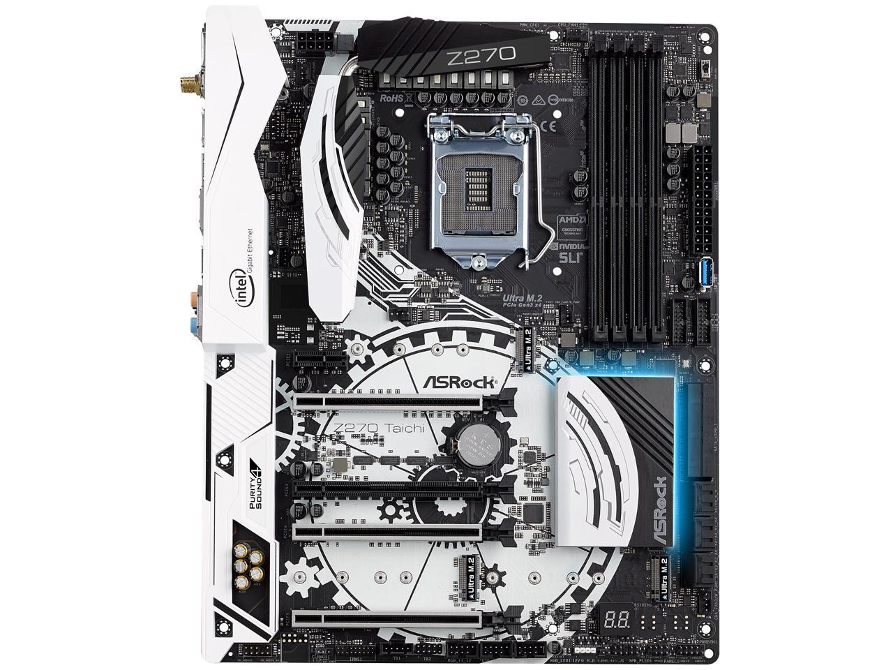

Motherboard
The ASRock Z270 TAICHI LGA 1151 motherboard ($160, https://www.newegg.com/Product/Product. ... 6813157754), which will provide up to 10 SATA ports on-board, and at least two PCI-Express 3.0 x16 ports running in x8 mode concurrently (important for the Controller Cards below). This board also has 3 Ultra M.2 sockets for NVMe SSD's.
With this board, you would connect 8 SATA ports to the X-Case backplanes. That leaves either 2 SATA ports for SSD cache drives (i.e. you could connect two 1TB drives and mirror them, so you get 1TB of cache that is mirrored for protection), or you can use 1 M.2 socket to connect an NVMe SSD (only one, though, otherwise you lose some of those 8 SATA ports going to the case). While the NVMe is definitely faster, you won't notice this on a gigabit network connection, and they are more expensive, but the choice is yours.
Do note that any data on the cache is not protected unless you mirror the cache with 2 drives. Typically your rips will hit your cache drive first, then get moved over to the array overnight, so having a mirrored cache is not important. But if you use Dockers/VM's, that data may also reside permanently on your cache, so having those drives mirrored will be nice insurance. You can also set up some shares to always be on the cache (i.e. Music) so you get super fast network access to that data without spinning up any drives. In that case, you could either mirror your cache drives or just keep an extra copy of your music in your protected array as a backup.
Also note that while the cache drive is technically optional, YOU WILL WANT THIS!!! A must have option in my mind. I was scared of setting up a cache drive for years, but it is so easy and works so well, I regret every day I neglected to do this.
This motherboard is compatible with both 6th and 7th gen Intel Core i7/i5/i3 / Pentium/Celeron Processors (Socket 1151), but not 8th or 9th gen.
This motherboard has dual gigabit NICs. Hopefully that is fast enough.

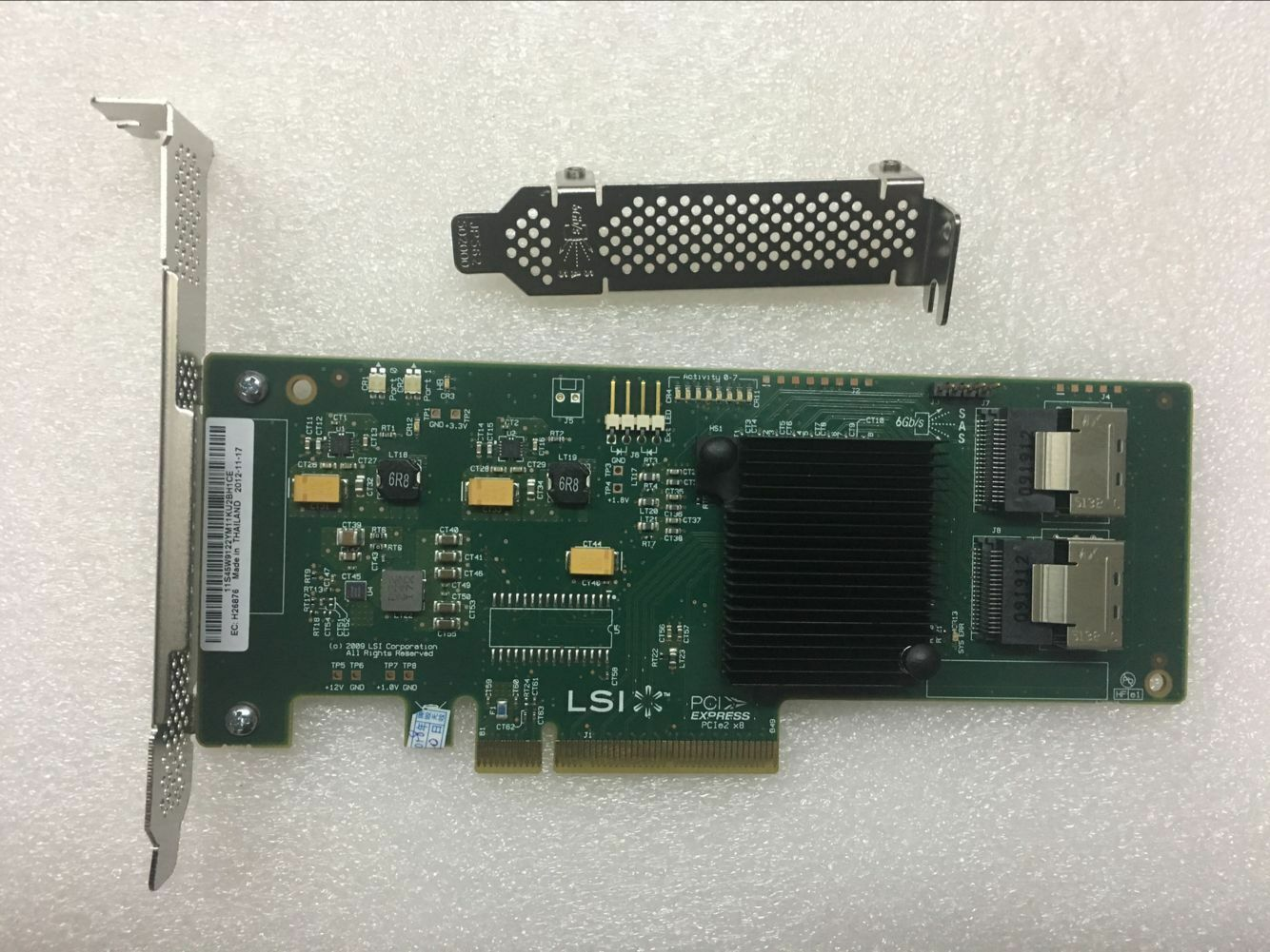

Controller Cards
One of the most popular controller cards is the LSI 9201-8i. These are great for Unraid. Each one supports 8 drives (2 SAS connectors). You will need 2 of these to control 16 drives, since the motherboard will handle the other 8. They cost $56 each, shipped, for a total of $112: https://www.ebay.com/itm/LSI-6Gbps-SAS- ... :rk:1:pf:0
These are older cards, using a PCI Express 2.0 x8 connection, so it is important to make sure these get installed in a slot with x8 connectivity. The motherboard I spec'd above will do this just fine, you just have to make sure you use the right slots. If you use the wrong slot, they will drop to x4 lanes, halving throughput. Also, if you use 3 slots, then at most you will be in x8/x4/x4 mode, so you do not want to have 3 PCI-e slots occupied on this motherboard, or you will halve throughput on at least one of these controller cards.
There is a newer model, the 9207-8i, that uses a faster PCI Express 3.0 x8 connection, and would still be okay even in PCI-e 3.0 x4 mode, but this costs about $40-$50 more per card, so I really don't think it is worth it unless you think you'll have 3 PCI-e cards installed at some point.

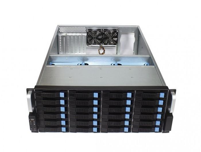

Case
X-Case eXtra Value RM 424 for $351. The EX model is $638, $187 more than the eXtra Value, but saves you the expense of having to buy those 2 controller cards. Since the controller cards will only cost $112 for two, the eXtra Value case actually comes out $75 cheaper. True, you do have to splurge for a nicer motherboard with both more PCI-e lanes and more SATA ports, but you're probably still saving money over the EX model. On top of being cheaper, the controller cards provide dedicated bandwidth to every drive, while the expanders share bandwidth, possibly making certain data activities slower (i.e. monthly parity checks that use all drives simultaneously). So faster and cheaper = win in my book.
This case also has room to install a couple 2.5" SSD's inside, perfect for cache drives.
You'll need to get a quote on shipping, but I'm guessing it will be around $150, so let's call this case $500: https://www.xcase.co.uk/collections/4u- ... tswap-bays

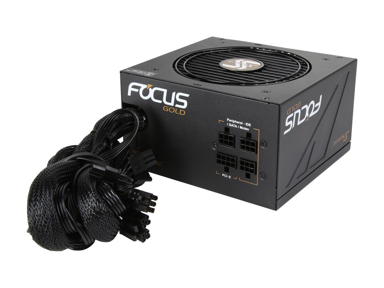

Power Supply
The biggest power draw a server like this will see is when all 24 drives are spun up simultaneously (Unraid does not have a staggered spin-up, so even if your motherboard/controller cards offered staggered spin up, that would only be at system start-up). Whenever all your drives are idle, starting a Parity Check in Unraid will instantly spin up all 24 drives, maximizing the hit on the power supply.
This load is estimated at up to 50 Amps on the 12v line, and 9A on the 5V line. You'll obviously want a power supply that exceeds these specs, so you have capacity left over for the rest of the system (CPU/motherboard/controller cards/graphics/cooling).
Your typical 650W power supply will have plenty of 5V amperage, but only 50-55 Amps on the 12v line. A 750W power supply gets you into the low 60's on the 12V line, and should be good for most systems. An 850W takes the 12V line over 70A, but this should only be needed if you are using a very high-end power hungry CPU. If you were doing a dedicated high-end graphics card, you'd probably need to bump this up to 1000W or more, depending upon the card.
I'm recommending this Seasonic FOCUS SSR-750FM 750W 80+ Gold power supply. It is semi-modular, has 12V@62A, and an excellent value at $90: https://www.newegg.com/Product/Product. ... gnorebbr=1

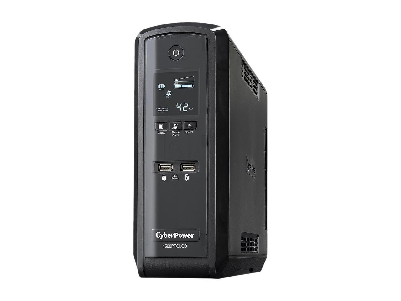

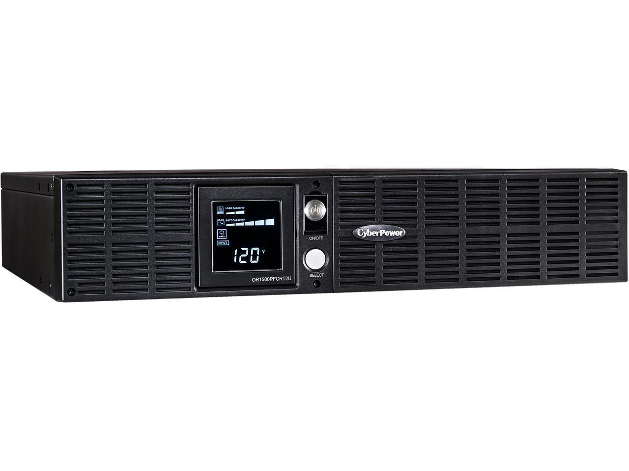

That's a perfect segue into my next topic: UPS devices.
I have several UPS devices, but even more computers than UPS devices. I've NEVER had a PC fail that was always run on a UPS device. I have PC's going strong 5-10 years, until I upgrade and retire them, on my UPS devices.
But the PC's that I never plug into UPS devices have ALWAYS failed on me, even through multiple rebuilds, and often within 1-2 years. It's so frustrating. I've rebuilt my HTPC twice in the past two years, and it has been dead for the past several months. I need to buy another UPS before I rebuild it yet again.
I always buy UPS devices that have that Pure Sinewave line conditioning, and I really believe that is the secret to how it protects these computers. Sure, it helps that they don't have the power turned off unexpectedly, but even better these PC's are receiving perfect A/C power, immune to brown outs and surges.
Sure, my evidence is anecdotal at best, but I am a die-hard believer. I've been using UPS devices for over 15 years now, and I have 1 large UPS on my Unraid server, and a couple smaller UPS devices on my critical computers.
Now, with regards to Unraid, there is a second reason to have a UPS device. When you are writing to the array, if power is lost during the write, those files will become corrupted. Unlike many expensive RAID controllers or NAS boxes, there is no write buffer or on-board battery/capacitor to finish out the write queue when there's a power failure. It shouldn't corrupt your array, just the one file being written, but a power failure might invalidate your parity, and then you would have to do a parity check/rebuild, which isn't fast (but maybe faster than Drobos).
You don't need a big battery either. Even a small one that can keep the server up 5-10 minutes will make a huge difference. You can connect the UPS to the Unraid server via USB, and configure Unraid to shutdown automatically to protect itself when the battery gets below a certain level. This will be a graceful shutdown too, so you don't get unexpected shutdown warnings when you start it back up, or the dreaded forced parity check (though you can always cancel it if you want).
Even my big UPS will only keep my Unraid server up for 30 min to an hour, less if all the drives are spun up for a parity check or rebuild. You'd need thousands of dollars worth of UPS batteries to get through a parity check/rebuild, so I wouldn't even worry about that - if they get interrupted, you just have to start over, but no data should be lost. I think in the new Unraid v6.7, LimeTech is even working on a pause/resume function for the parity checks, but this capability doesn't yet survive a restart. Fingers crossed he gets this figured out.
If you're interested in what I use, I really like the CyberPower CP1500PFCLCD. These typically go for about $200. I think it's a good value for the money, since it includes 100% Active PFC (Power Factor Correction) and 900 Watts of Pure Sine Wave. These are small and light enough (25 lbs) that they are easy to hide near all your important PC's. I find that the CyberPower UPS's have similar features to APC but better prices. Regardless of brand, you do pay a premium for the Pure Sine Wave feature, but to me that is the most important feature.
The bigger UPS that I have on my Unraid server (overkill, really) is the CyberPower FPC Sinewave OR1500PFCRT2U. It's so hard to tell from the specs, but this is double the size of the unit above, so it has twice the uptime. It's also more than double the price, and really heavy at 50 lbs. Actually, I've found that weight is one of the best ways to compare the size of one UPS to another. They all use the same battery technology, and 95% of the weight of a UPS is the battery, so a UPS that weighs twice as much has basically twice the energy storage. I got the bigger UPS for my Unraid server because for a while we were having frequent power outages that were lasting a few minutes longer than the smaller one could stay awake.

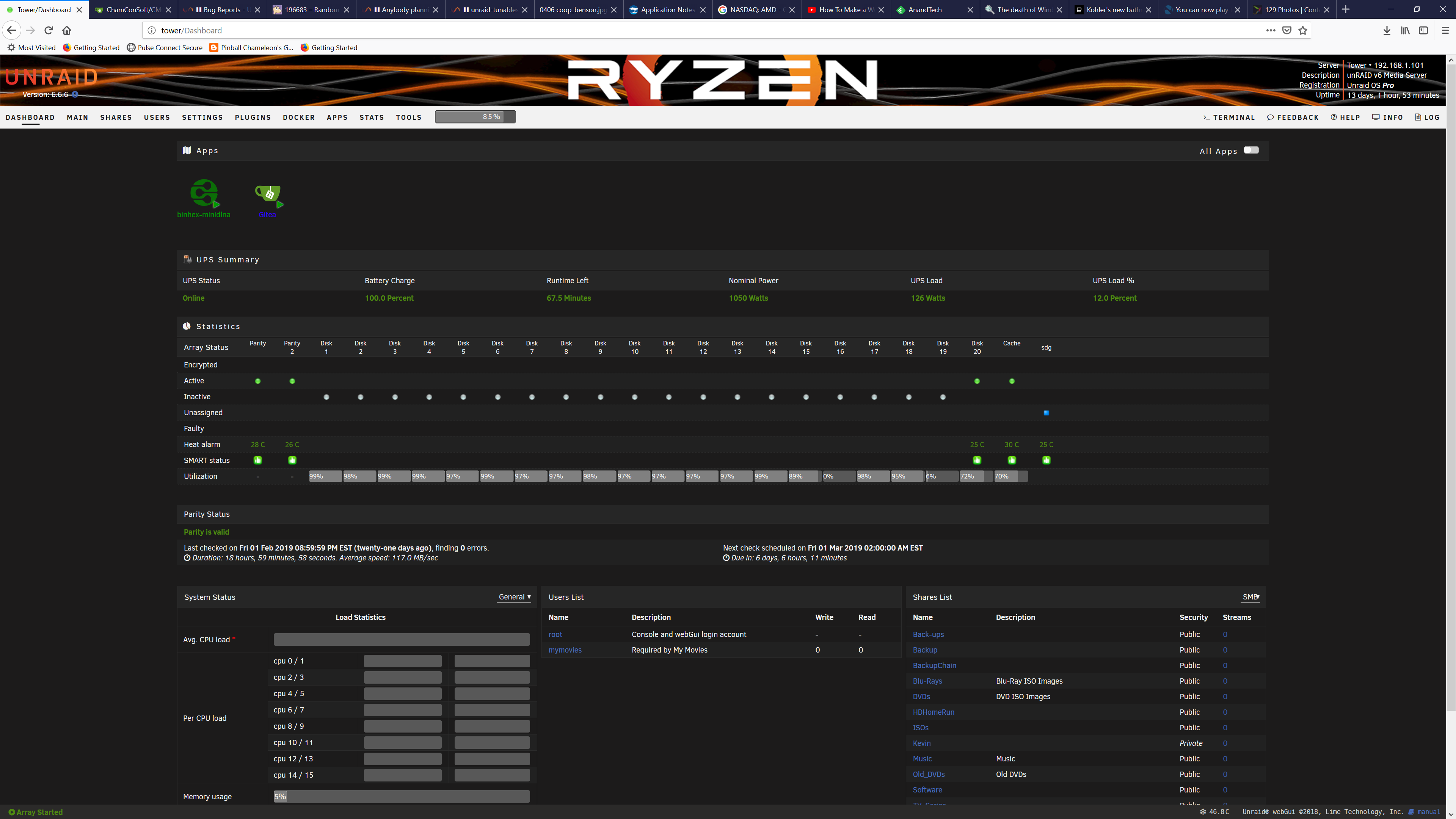

Something else that is also neat is that Unraid will log these power issues and display them to you in the GUI. Now it's super easy to know when I had a 12 minute power outage overnight. You also get UPS health stats on your Unraid dashboard:
