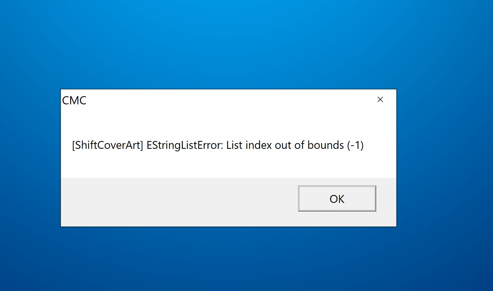

Thanks, I didn't get these with RC14 but I got this one instead (only once):
Out of bounds error.JPG (64.78 KiB) Viewed 6426 times
I re-did a full sync after that (I had deleted all the CMC folder except my .cfg file when I installed RC14), and I didn't see it again.
