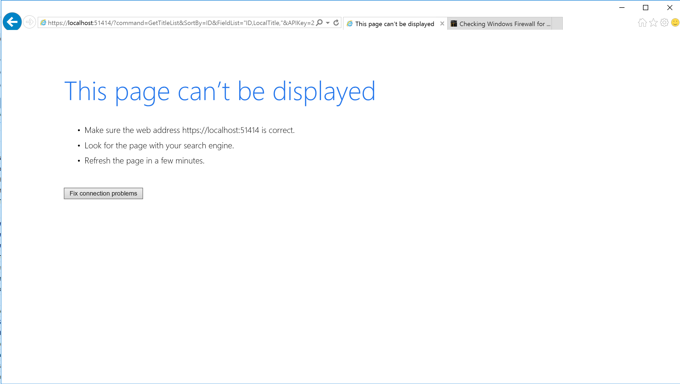

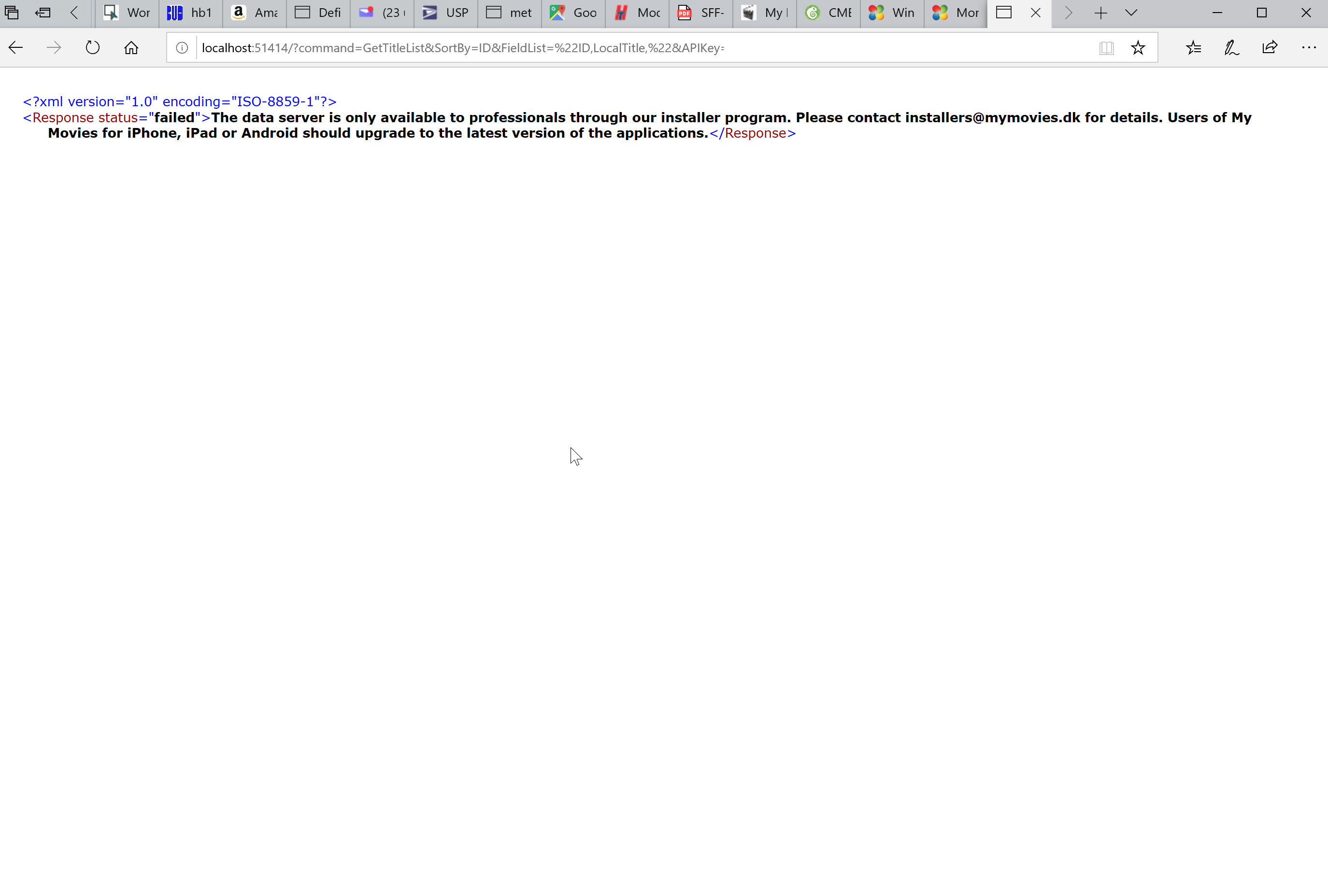

2.) That makes sense. I have two screen shots attached. Paul suggested the url using the api key which I did on both my server and my PC acting as a client. On the client side the call was rejected. It stated that it's only available to professionals through their installer program. On the server side all it says is the webpage can't be displayed. When I run the trouble shooter it says the remote device or resource won't except the connection. The devise or resource is not set up to accept connection on port 51414. The port is not blocked on either machine.

The server response for that URL is exactly as I suspected - the API Service is not running, at least not on that port #. I don't know if this is normal for Server Essentials or not. My guess is that it is normal, as I think Binnerup expects you to install a MM Client on each PC that you use MM, and that the API should be local on the client, and for that reason it wouldn't need to exist at all on the server.

The client response for that URL was unexpected.
First, in your screenshot I notice that the API key is not in the URL - I assume you photoshopped it out?
Second, the response that "the data server is only available to professionals" is both a generic response and out of date (the data server is actually available to all users who have at least 2500 points, but Binnerup has not changed the message). By the response being generic, what I mean is that you get the same response no matter the cause - wrong API Key or User/Pass info, insufficient points.

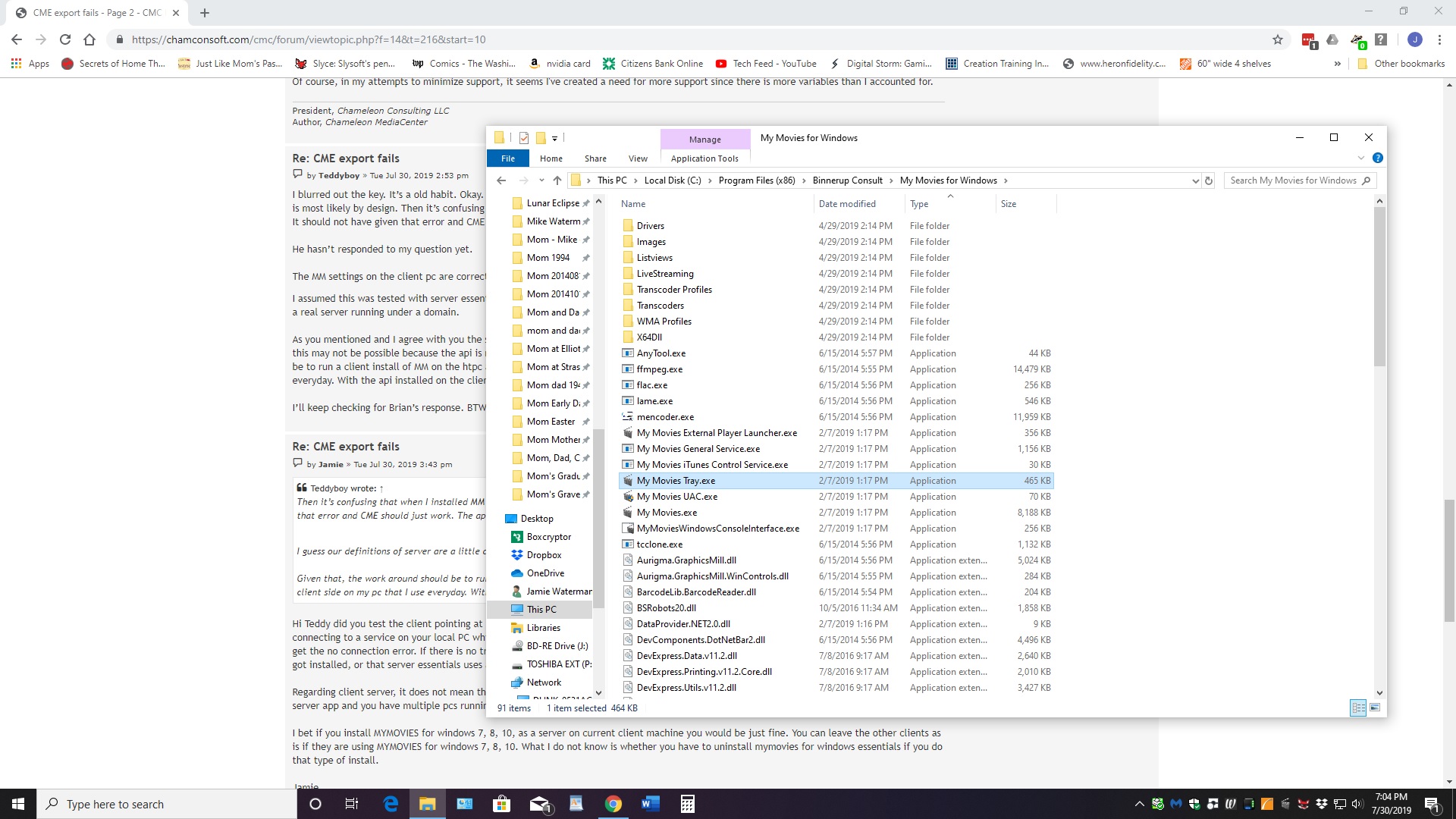

Sorry to butt in again, but I think that if Brian does't respond then "Teddy?" could look into his installation folder on his server and see whether there is a tray executable for mymovies. By executable it could be exe, wssx, or whatever. ON my PC mymovies install it is "Mymovies Tray.exe". It may have a similar name or at least the word "tray". Just double click that file and try the export if you have that file. Hopefully Brian can get back to you tomorrow. Right now the mymovies forum is having SQL issues.
Sorry for not testing or thinking of testing windows server essentials but my budget and Paul's maybe, makes it hard to test every OS. I do volunteer testing for Paul from time to time and it seems that I have been doing a very crappy job as of late. At least the last release.
Here is a picture of my installation folder. The blue highlighted item is the tray file that I am referring too.
