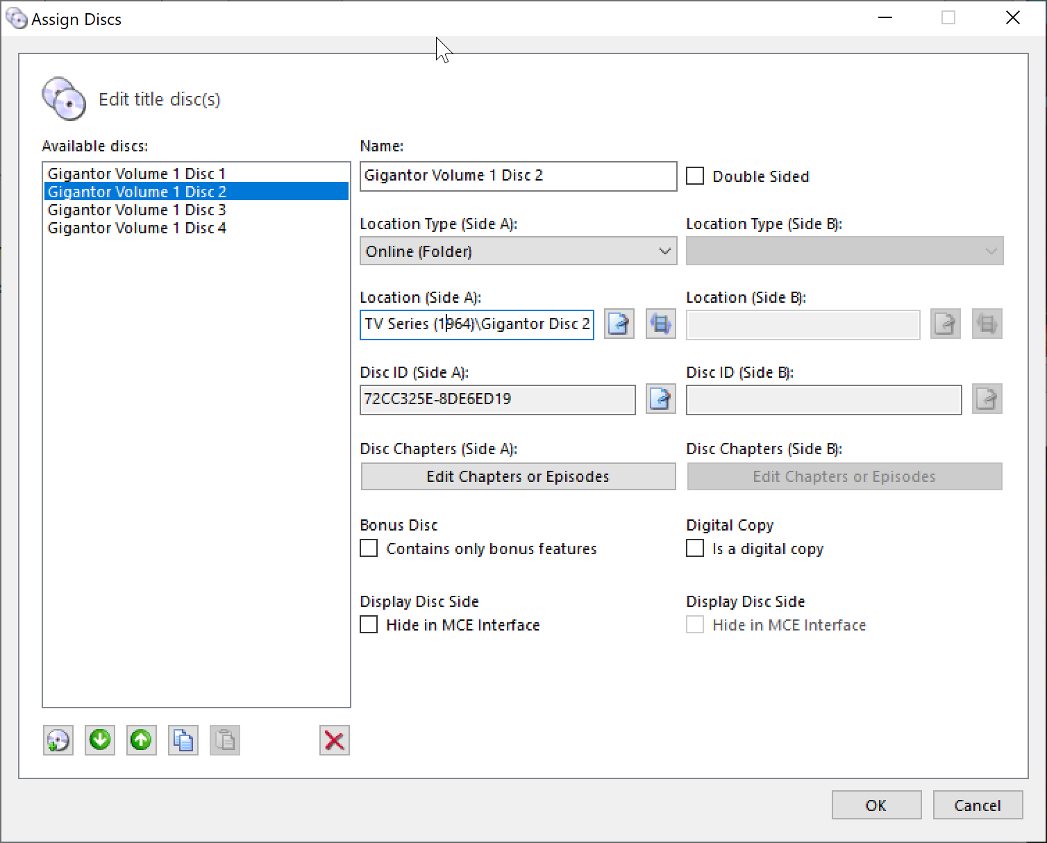

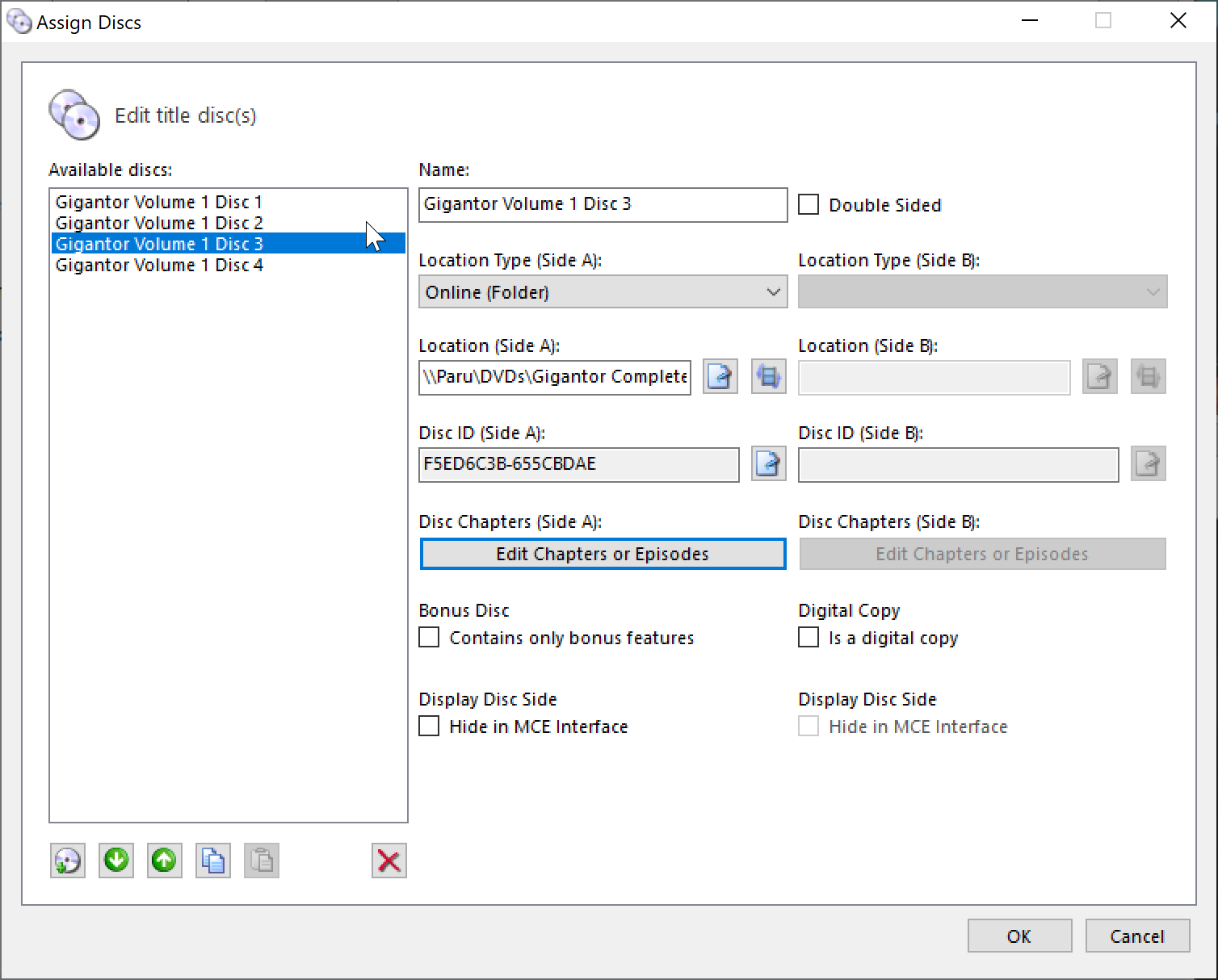

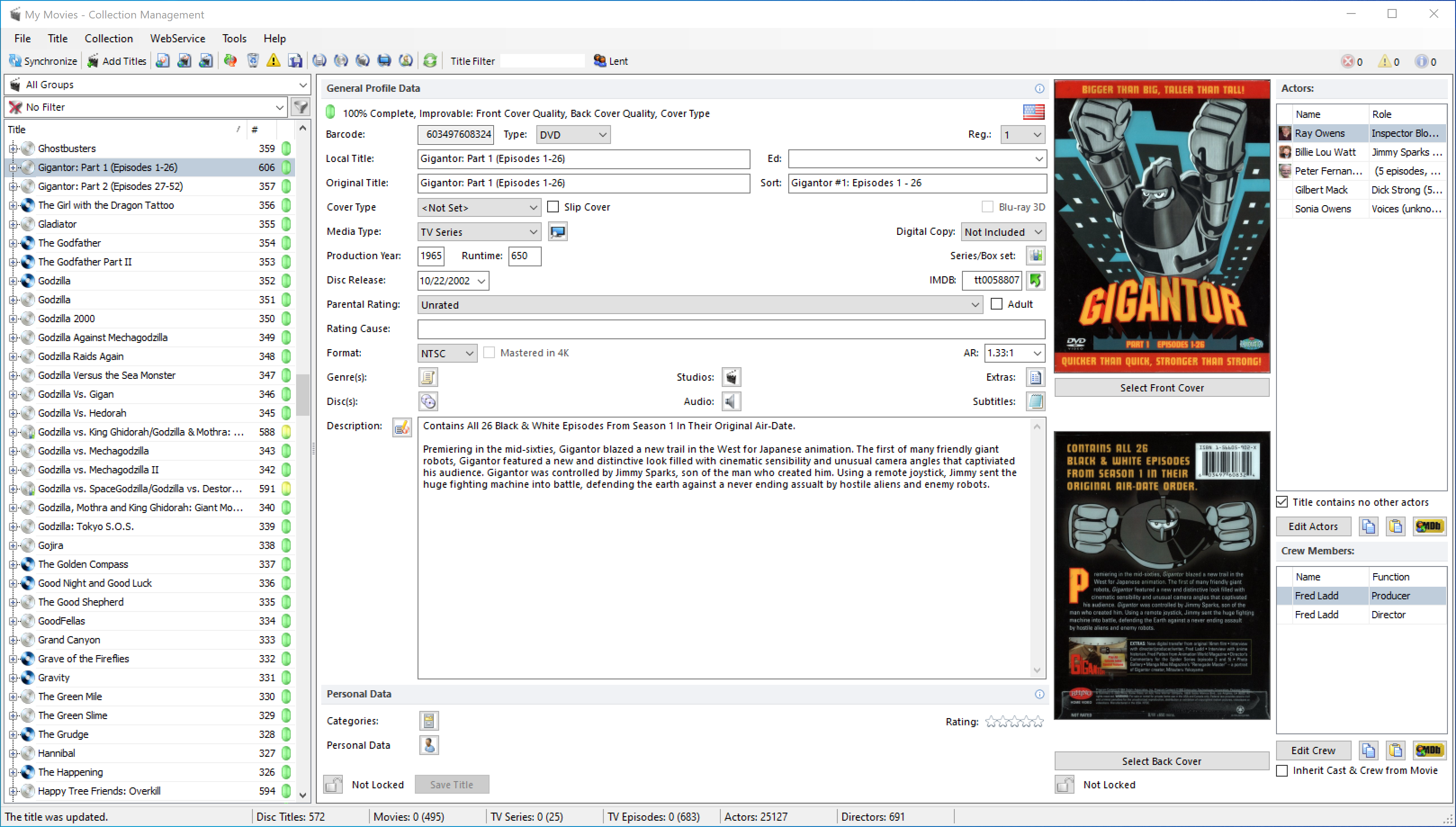

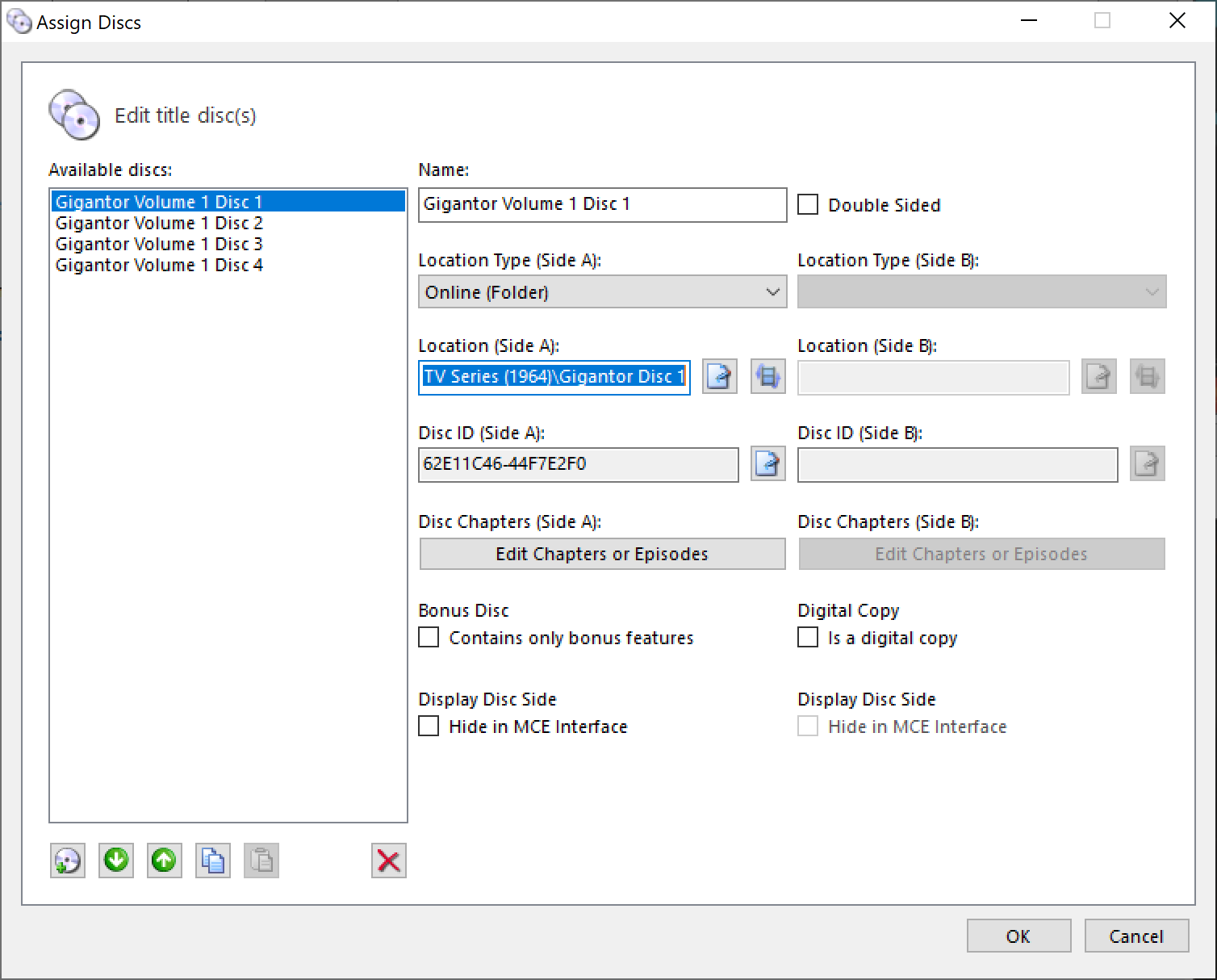

Teddyboy wrote: Wed Aug 14, 2019 12:09 pm Here is another one that has me stumped. None of the season one episodes will show in CMC. CME states that there is not episode data when clearly there is in MMCM. I can't figure out what is wrong.
Please include screenshots of the Gigantor main Title screen, and the Assign Discs screen.
Here are the screenshots you requested Paul. I've dug a little further and Gigantor: part 1 is not seen by CME as a series. Even though it's assigned as a TV series in MMCM as you can see in the screenshots. The TVwebservice id is present in the mmmovies.xml file to identify it as a series and the same id is present in the mmtitle.xml file for all four discs in the title. The same issue exists with Kimba and Rin: Daughters of Mnemosyne as well.

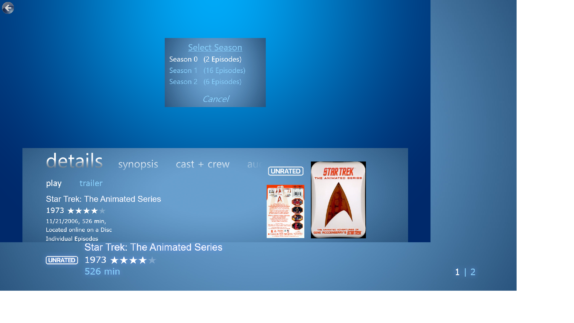

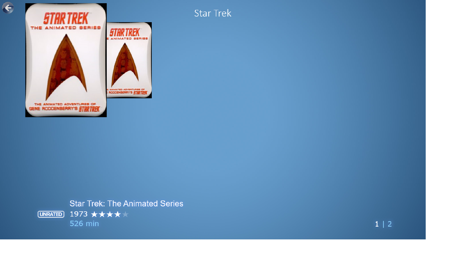

Star Trek TAS exported with no errors and I can play individual episodes, but there are no season buttons in the lower left hand corner of the screen like there is in other tv series.

Teddyboy wrote: Wed Aug 14, 2019 10:18 pm Here are the screenshots you requested Paul. I've dug a little further and Gigantor: part 1 is not seen by CME as a series. Even though it's assigned as a TV series in MMCM as you can see in the screenshots. The TVwebservice id is present in the mmmovies.xml file to identify it as a series and the same id is present in the mmtitle.xml file for all four discs in the title. The same issue exists with Kimba and Rin: Daughters of Mnemosyne as well.
On the main Title view for Gigantor Part 1, please expand the tree on the left to show all Disc > TV Series > Season > Episodes levels, then provide one screenshot for each level, Series, Season, & Episode.

Teddyboy wrote: Wed Aug 14, 2019 10:21 pm Star Trek TAS exported with no errors and I can play individual episodes, but there are no season buttons in the lower left hand corner of the screen like there is in other tv series.
This is what it looks like when the Title is missing the TV Series assignment in MMCM. Because it doesn't have the TV Series ID, CME doesn't export the mmSeries.xml file. And because there is no mmSeries.xml file, CMC doesn't show the enhanced TV Series view.

Gigantor Part 1 Resolved itself. as a test I deleted disc one from the assign discs screen then brought it back in and reattached the folder and remapped the episodes for that disc which were only four or five and saved the title. I ran CME and it picked up those episodes. I did the same thing for the remaining three discs and CME found them and added episode metadata to the folders. Gigantor Part 1 now shows episodes in CMC.

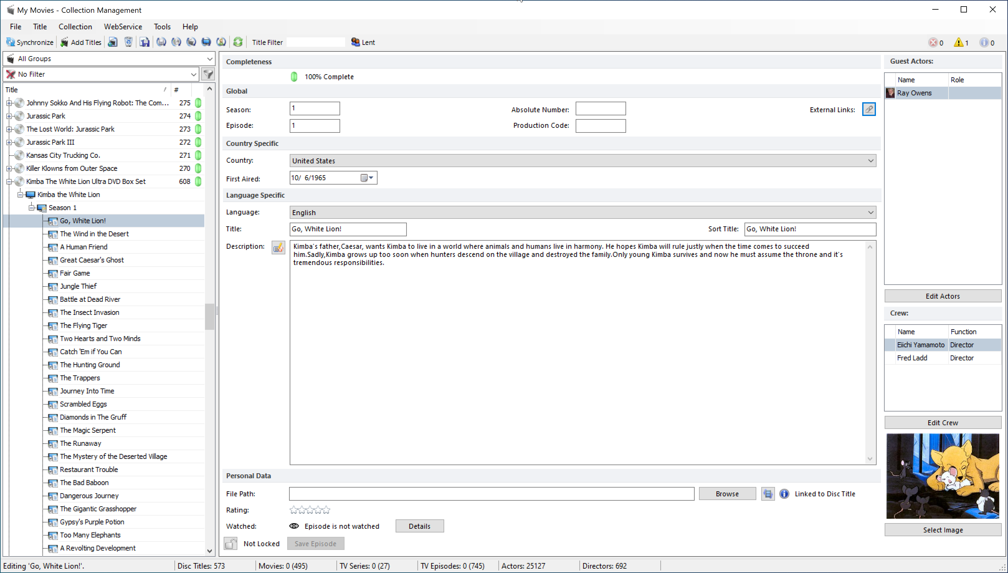

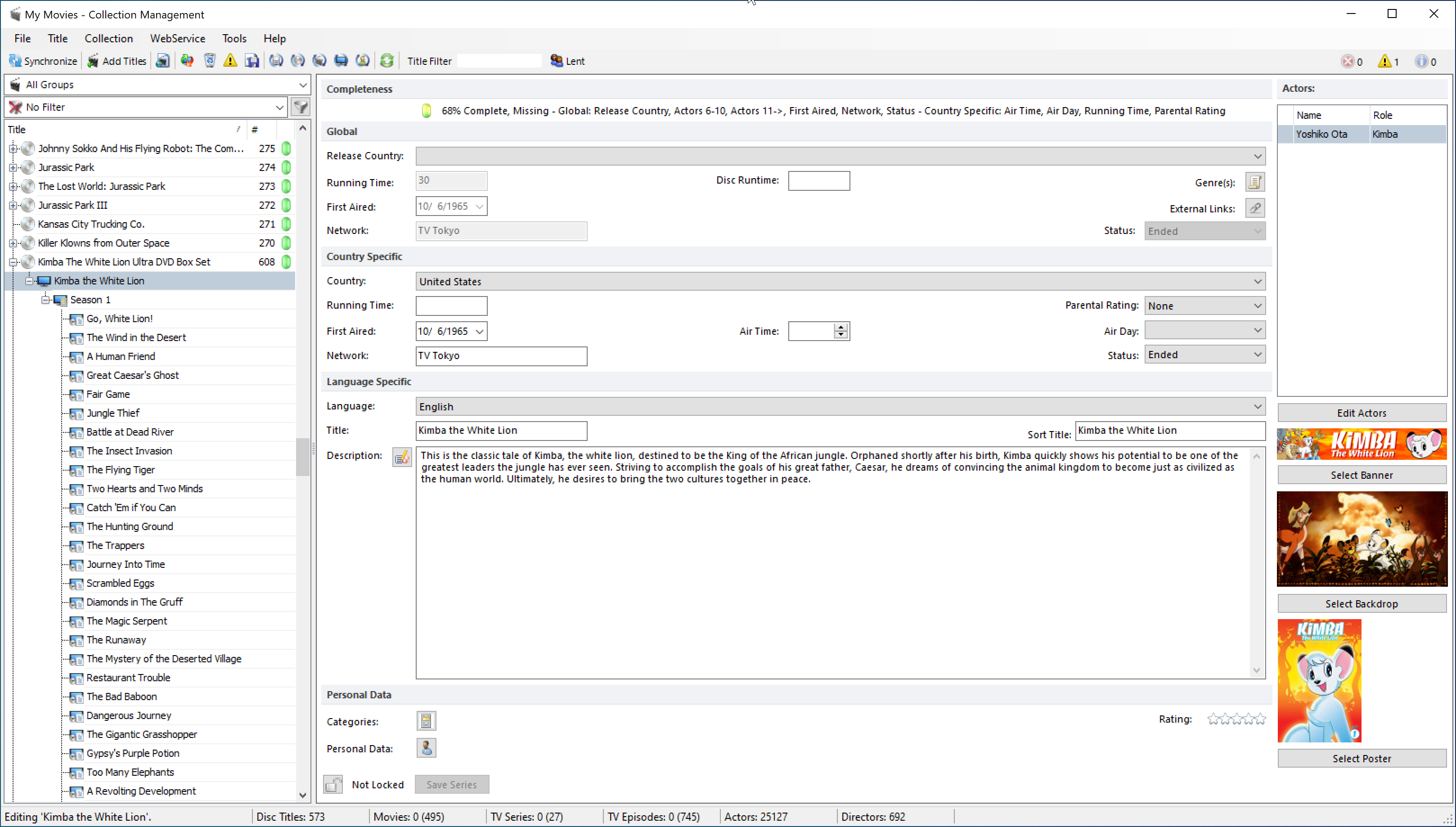

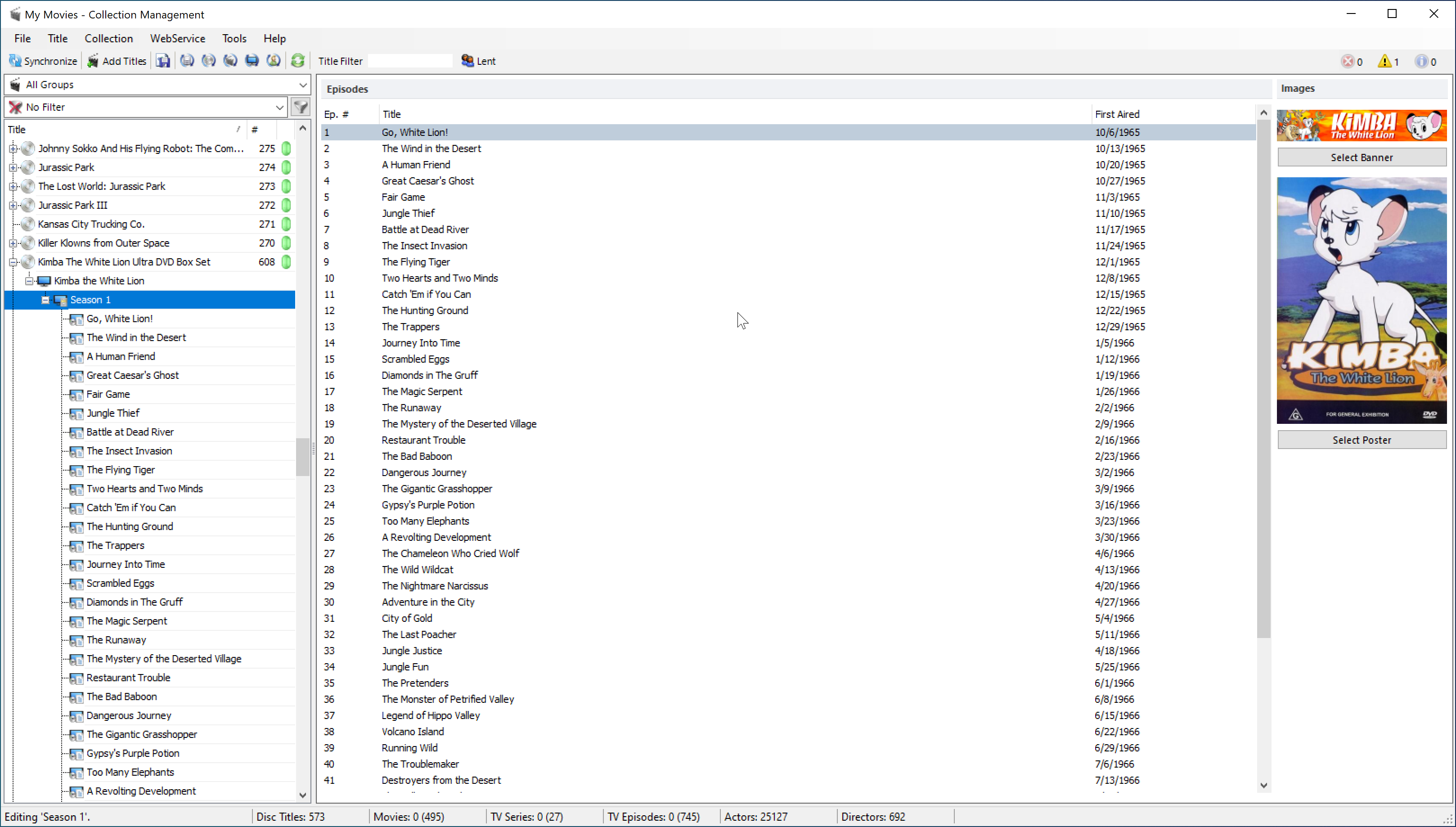

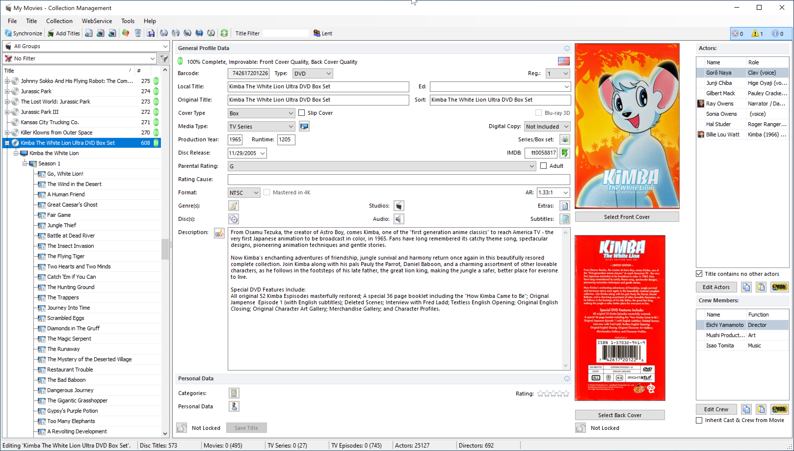

I thought I might get lucky and try the same thing with Kimba, but no dice. I even deleted the whole title and deleted all the metadata including metadata from CME. I let MMCM add its metadata back and then ran CME. It came back with the same message that there was "No Episodes indexed for this Title's Discs, skipping Meta-data export."
I've attached screen shots of the title, series, season, and one episode. I thought I would attach xml files if you want to compare against Kimbas mmmovie.xml against CME. Maybe you'll see something that would be invisible to me. I'll throw in Gigantors as well. :)

Teddyboy wrote: Fri Aug 16, 2019 12:15 am Gigantor Part 1 Resolved itself. as a test I deleted disc one from the assign discs screen then brought it back in and reattached the folder and remapped the episodes for that disc which were only four or five and saved the title. I ran CME and it picked up those episodes. I did the same thing for the remaining three discs and CME found them and added episode metadata to the folders. Gigantor Part 1 now shows episodes in CMC.
Those exact steps were going to be my next recommendation. I've had a few users in the same boat, that somehow their data is messed up in MMCM, and the only way to get the Series and Episodes to export is to delete and re-add the discs. It 'almost' sounds like some kind of MM DB corruption, but I hesitate to suggest that. Perhaps it is really old data that came in on an older version of MM that is somehow missing a data element, and you have to re-add the discs using the current version to fix it. It's all just guesses and speculation, and only Binnerup could shed light on the issue.
Teddyboy wrote: Fri Aug 16, 2019 12:15 am I thought I might get lucky and try the same thing with Kimba, but no dice. I even deleted the whole title and deleted all the metadata including metadata from CME. I let MMCM add its metadata back and then ran CME. It came back with the same message that there was "No Episodes indexed for this Title's Discs, skipping Meta-data export."
Please provide some screenshots of the discs and episode mapping too.
