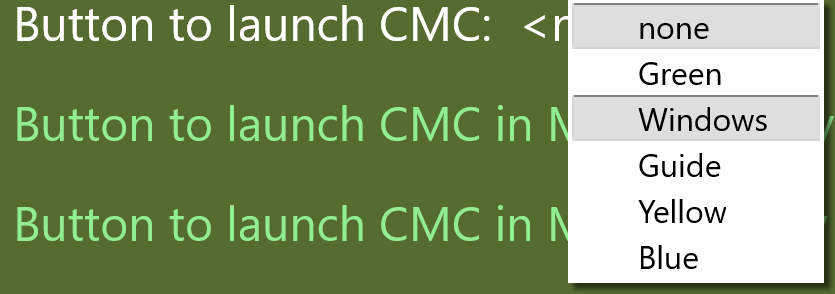

Also, I think you picked the wrong button. There are four colored buttons, Red, Green, Blue, Yellow, and you picked one of them, Green. You did NOT pick the Big Green Windows button, which is listed as 'Windows' in the selection options:

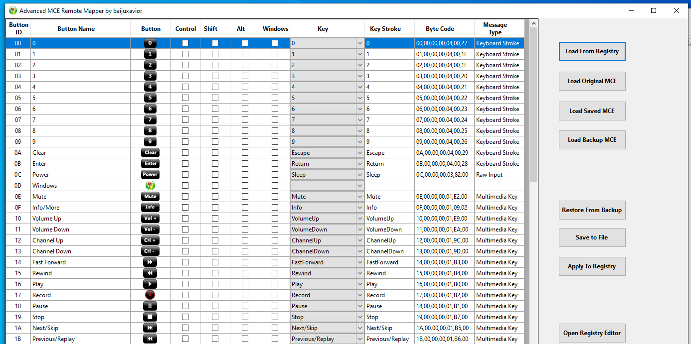

Teddyboy wrote: Fri Aug 30, 2019 11:08 pm 6. In MCE Mapper: Load From Registry, and provide screenshot
Debug log is attached
In the MCE Mapper screenshot, you are showing the Big Green "Windows" button as not configured, but you are NOT showing the four colored buttons, including the Green button. Scroll around and you should see them.
Also, from the Debug Log (thanks for providing that and everything else!), I see:
 * Configured Launch Button "Green" has Button ID "5C"
Which tells me that you did choose the Green button instead of the Big Green "Windows" button.
I truly hate that the terminology for the WMC Start button has become "The Big Green button", as it is too easily confused with the little Green button.
One last note, even in MCE Mapper, the Big Green Button is named "Windows", not "Green". In fact, all the button names came from MCE Mapper, since I used their source code and button tables as a reference when I built this functionality into CMC.

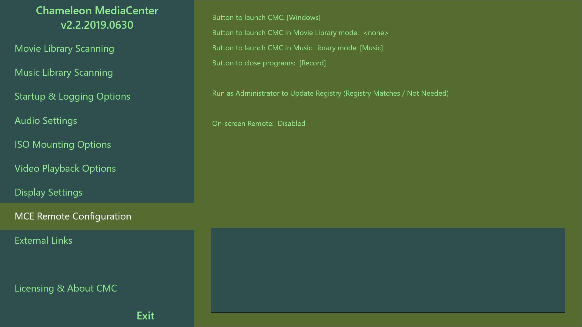

After I rebooted I tried the WMC button which is called the windows button in CMC. It worked. I then noticed that I have no red button, but only a record button. I went into the remote settings and changed close programs to "record". I saved the settings and went back to the remote settings to save the registry settings. I noticed that I wasn't getting the prompt that my settings were saved to the registry. I banged and screamed at it until it dawned on me that I had not entered CMC with administrator rights. I did that and the registry settings finally saved. You really need a prompt to say "Hey nitwit, Turn on Administrator rights!!!!" It just sits there and if I didn't know that I needed to be prompted I would have thought that it had saved to the registry properly. Also the prompt always says registry matches even though I know I haven't saved the latest changes to the registry yet.
Also for the "Windows" Button. Could you call it MCE or WMC button? I think that is what it was originally called. Either that, or can you provide icons showing what the buttons look like?
I rebooted and everything worked fine including the music button.
Here are my WMC mappings.
