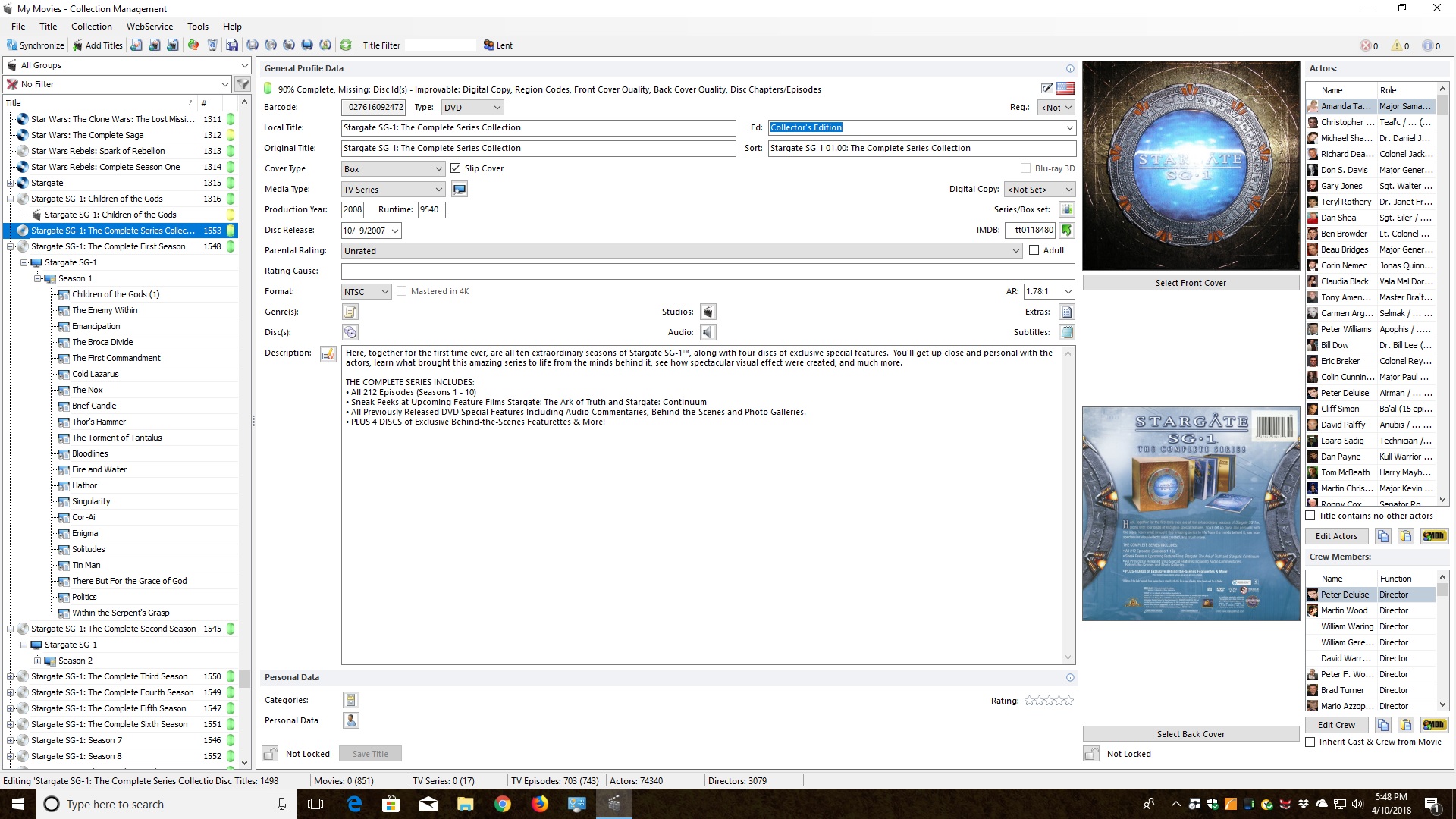

Here's a screenshot from mymovies

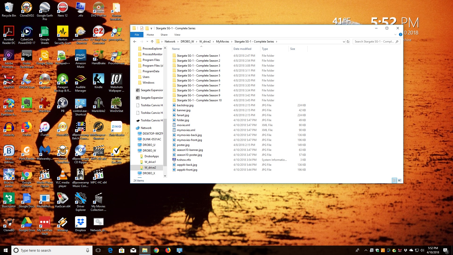

Here's windows explorer. It does have xmls
stargate explorer view.jpg (674.72 KiB) Viewed 18873 times

Now I see in your last screenshot that you have a tvshow.nfo meta-data file. I got a few of those to generate this morning, and they look very interesting to me. Based upon the name alone, I think this might solve the file overwriting problem. I also see the poster.jpg and banner.jpg files in the same folder, but my concern is that they have different dates. I need these files, along with the tvshow.nfo, to build the complete TV Series package. I haven't been able to reliably get these files, but I feel I am getting closer.

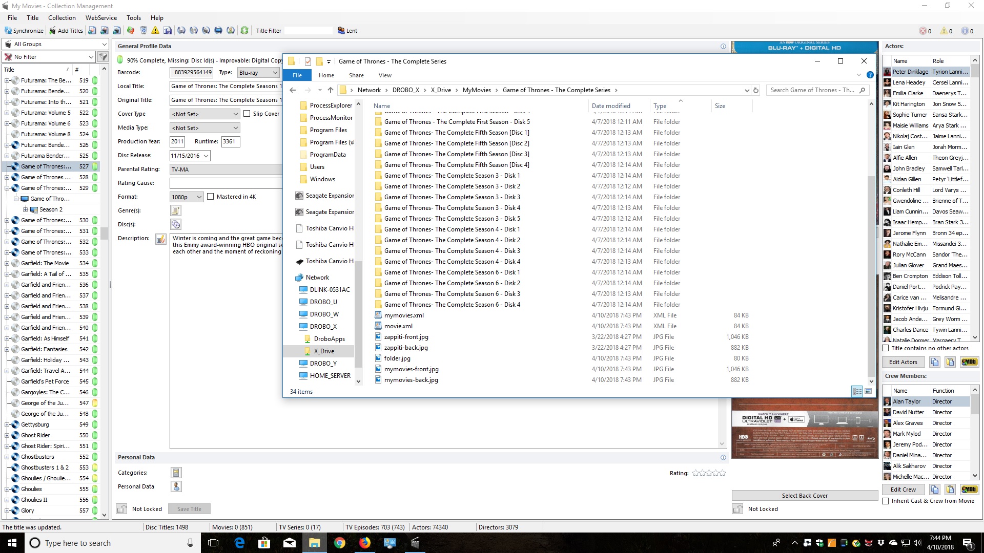

If you look at the stargate windows explorer screenshot you can see a mymovies.xml file and a folder.jpg file. Why isn't mmBrowser not using these? They are the correct data files for the series title? I know it's a kludge but the files are there and they are the correct files. What I'm doing is creating a fake parent and it might be hard to do for every series. The game of thrones folder was pointing at the wrong folder in mymovies. That is why I didn't see the xml files before.
game of thrones explorer.jpg (646.24 KiB) Viewed 18871 times

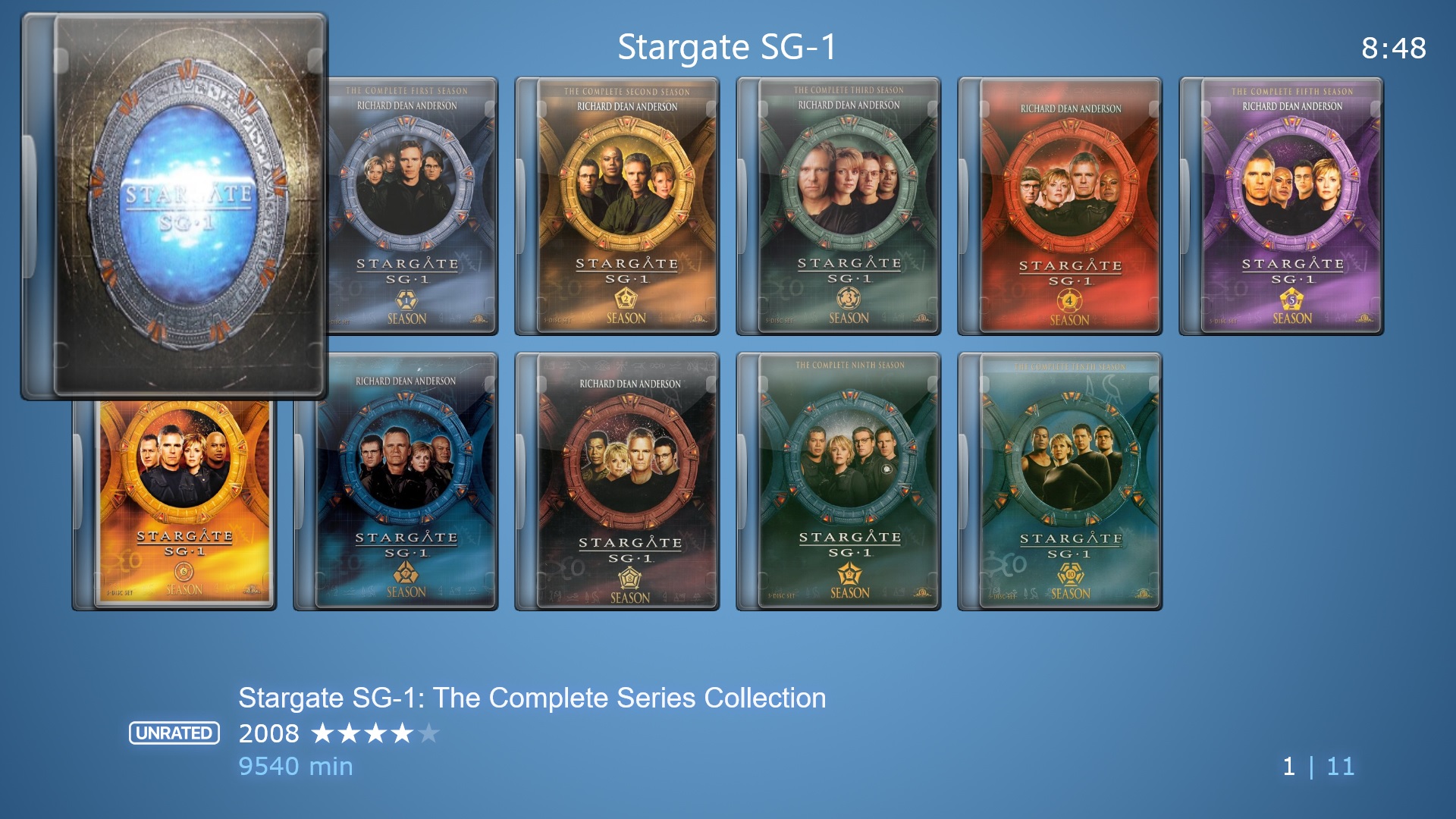

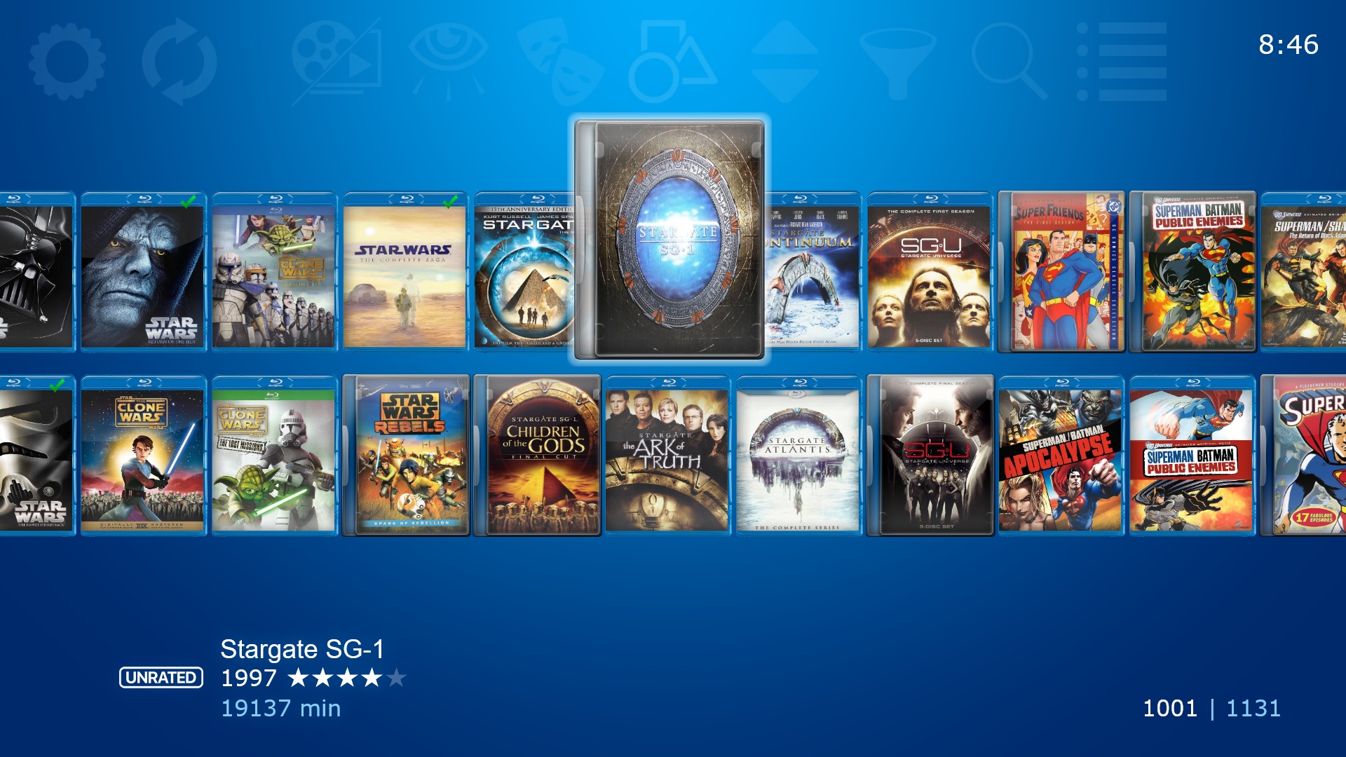

It mostly worked with the fake VIDEO_TS folder. The problem is that it shows the parent cover with the child covers as well.
stargate parent cover.jpg (555.37 KiB) Viewed 18867 times
stargate child season covers.jpg (519.95 KiB) Viewed 18867 times

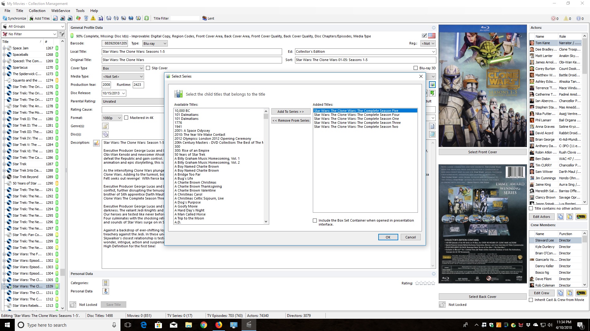

I was also wonder whether we could set the TV series up as a real box set by moving the individual season titles under the parent title as in the screenshot
I don't know whether a tv series structure would work with this method.
star wars - box set.jpg (708.86 KiB) Viewed 18863 times
