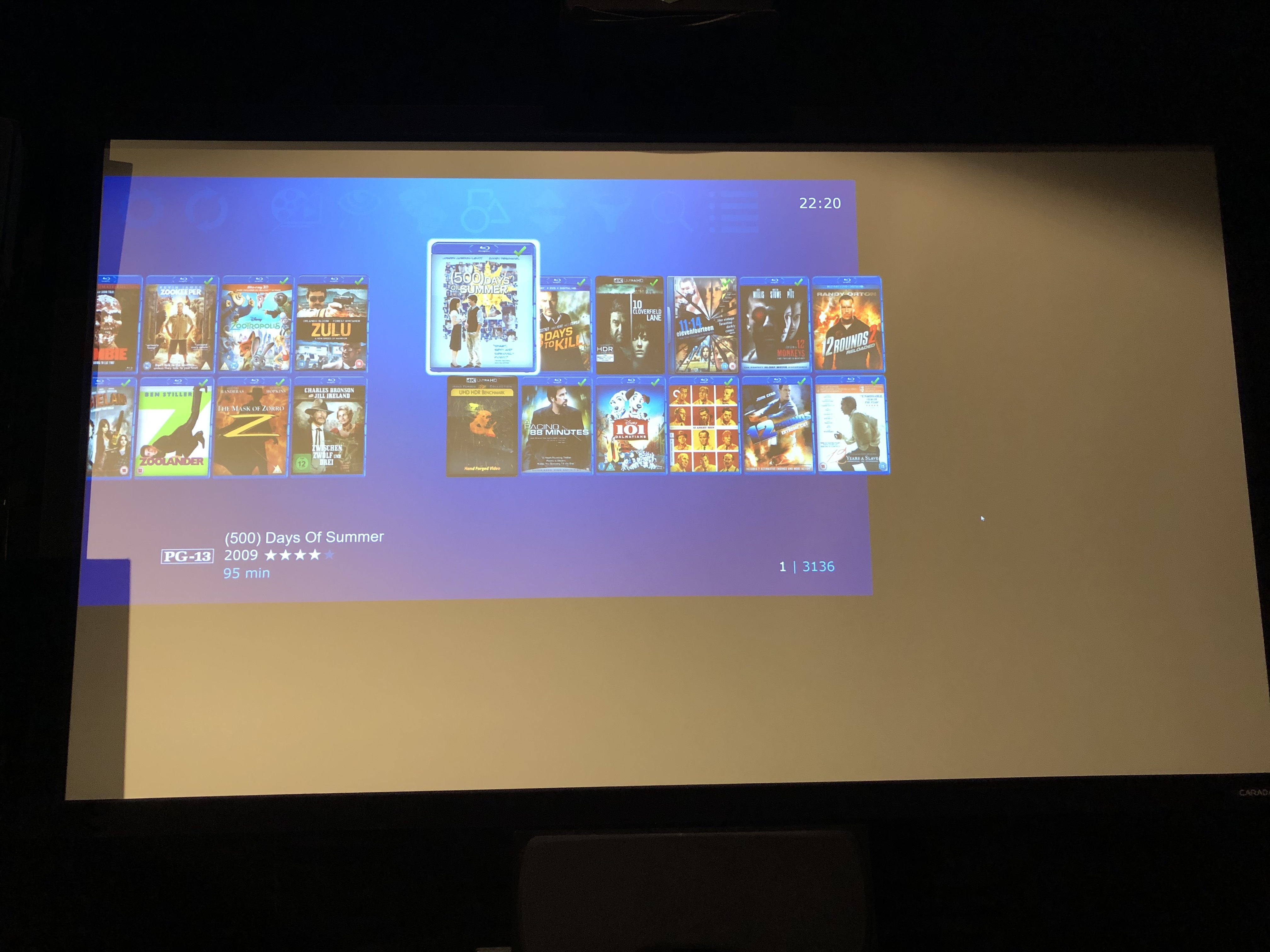

I did one more test beside the above, I tried to change the DPI in windows to see the results (the first screenshot was taken at 200%).
If I set the DPI to 100%, I get a much smaller GUI for CMC.
I took a picture with the lights on to show what it looks like (I have a 16/9 screen):
If I set it to 225%, it's too big and goes beyond the screen.
So it looks like it's a CMC scaling issue. 200% gives the least wrong result, with just the top black bar and missing bottom part (first screenshot).
CMC is the only app doing this after using remote desktop, at least I haven't seen others having such issues.

Manni wrote: Thu Jan 02, 2020 5:28 pm I did one more test beside the above, I tried to change the DPI in windows to see the results (the first screenshot was taken at 200%).
Your scaling tests might not have had the desired result if you didn't restart windows in-between. CMC looks at your screen resolution and DPI to automatically fill the full screen (without clipping), scaling the image and positioning the window.
What you demonstrated looks like you changed scaling without restarting Windows, but I'm not sure. CMC might get confused and produce the wrong result in this scenario.
I use 150% scaling on my 4k monitors and it's fine. There's no requirement to use 200%.
EDIT: And the original issue you presented is not technically scaling, but rather window positioning. CMC thinks the screen is taller and is shifting the window down to center it. So while you found a way to trigger some scaling issues by manually adjusting the DPI, that's not necessary the exact same issue.

Post by Manni » Thu Jan 02, 2020 6:15 pm
Yes, I had rebooted after the DPI change.
However, I noticed that if I leave a bit of time, CMC rescales, so deals with the wrong DPI, however I still have the black bar.
So you are correct that this is NOT a DPI issue but a wrong scaling/shifting issue. :)
By the way, I know that you don't have to use 200%, but that's what allows me to see the interface on my 88" diag screen when sitting 2-3 meters away from it :)
Note that I can reproduce this 100% when I go directly from remote desktop with CMC correctly displayed to logging to the HTPC (hence terminating the remote desktop session), but I can also have this issue when I start CMC from the HTPC after ending the RD session, provided an earlier RD session had taken place.
I don't have the issue if I haven't used RD in that same session.
