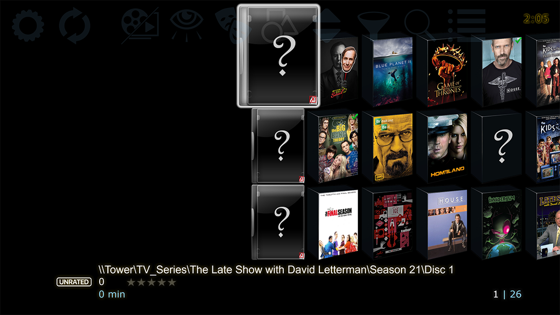

First, I replicated the issue. During setup, I again discovered that this only seems to affect standalone discless TV Series, as I was not able to replicate with disc based TV Series. After replication, I see these vague messages in the error log, just as you detailed:
[ERROR] Did not find TV Series Parent for Season 1 Episode 1
[ERROR] Did not find TV Series Parent for Season 1 Episode 2
[ERROR] Did not find TV Series Parent for Season 1 Episode 3
And the episodes each showed as a separate movie in the GUI:

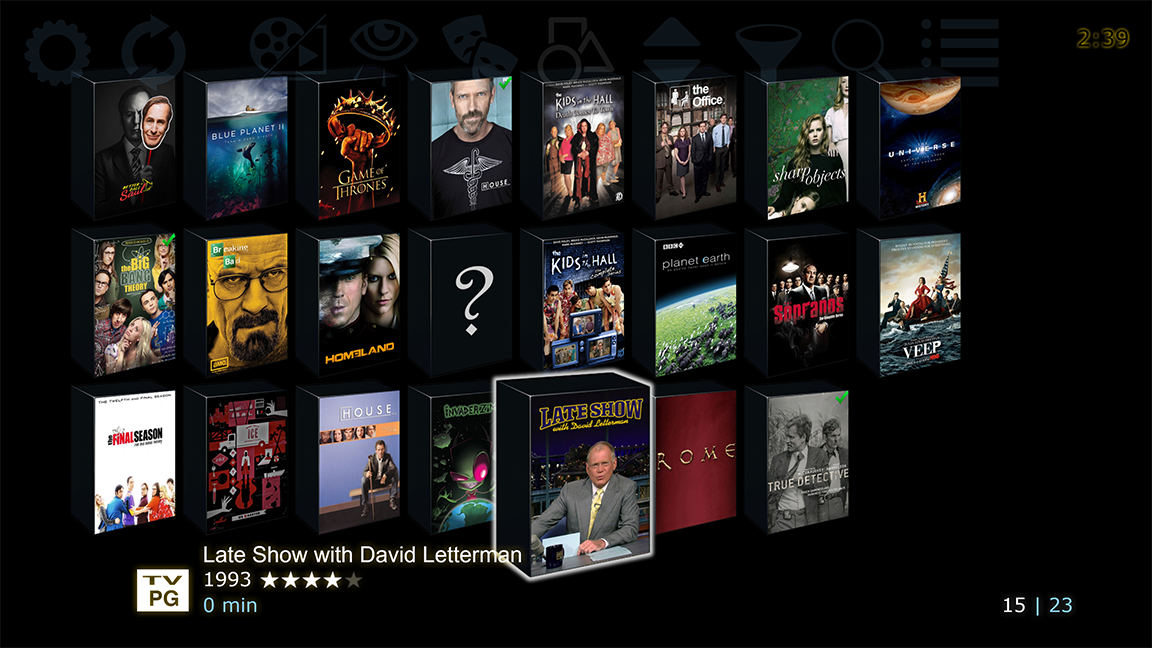

And lastly, the separate episodes as movies are now gone, and correctly show inside the TV Series:
I think that wraps up the changes and fixes. Let me know what you think.
