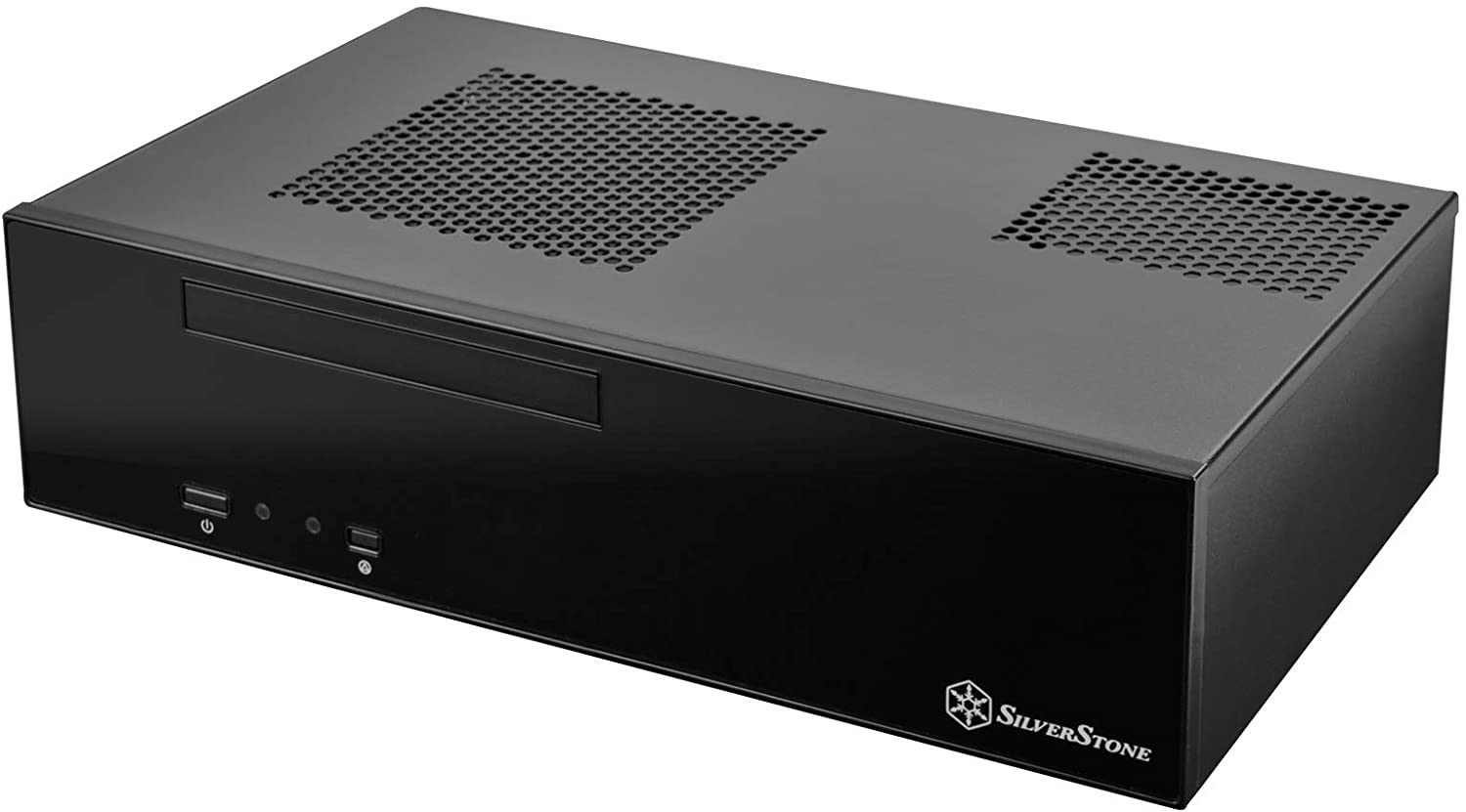

https://www.amazon.com/SilverStone-Tech ... 954&sr=8-7
The SilverStone ML09 takes Mini-ITX motherboards, a slim-tray optical drive, and has room for two half-height and one full height expansion card. It also takes the smaller SFX size power supplies - these are readily available but make sure you get the right length (the longer one won't fit), and match the power to your CPU+GPU requirements. I would definitely plan on getting a motherboard with a M.2 NVMe SSD slot, as avoiding a 2.5" or 3.5" storage drive will definitely help in a case like this.
But this might be a little small if you are going into this expecting to install a modern video card. The problem is that finding a single-slot card that will fit this case will definitely limit your options, so make sure you research this before choosing a case like this.
If you decide this case is too small, you probably want to step up to a Micro-ATX case.

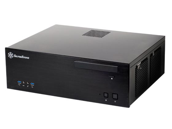

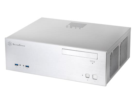

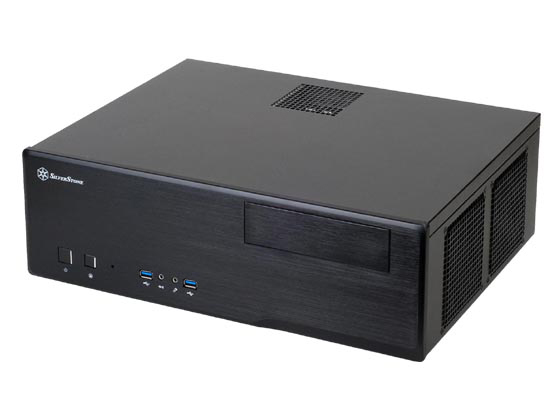

Silverstone's GD05 offers a full-size 5.25" drive bay, so that's pretty nice: https://www.silverstonetek.com/product. ... 41&area=en
And Silverstone's GD04 trims a few millimeters and offers a slim-tray slot, and is also available in silver: https://www.silverstonetek.com/product. ... 33&area=en
Probably the biggest thing you need to keep in mind with these cases in the CPU cooler. When an optical drive is installed, this limits what size (height) and shape CPU coolers will fit, as both of these cases have the drive above the CPU area.
