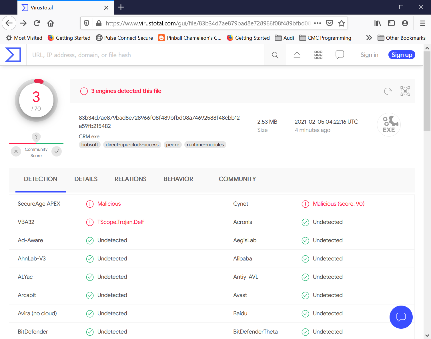

Also, one of my concerns was how this app would appear to virus scanners. So far, my own scanners haven't falsely flagged it, but I submitted it to VirusTotal.com, and it detected 3 engines. :cry: The SecureAge.APEX and Cynet false flags are pretty common, I get them a lot. But the VBA32 one is new, haven't seen that one before. Pretty amazing that 200 lines of code could be misconstrued so easily.

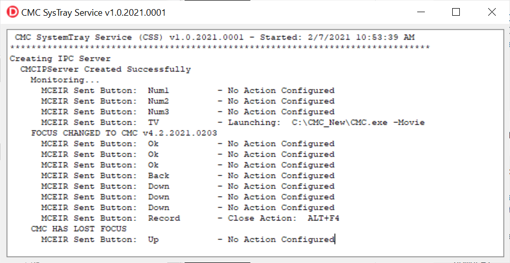

Another progress update - things are coming along swimmingly!
I now have a Windows Service communicating with a Desktop App. So far it's been perfectly stable and I haven't seen any button misses. Performance is still pretty much instantaneous - I can't discern any processing lag at all, and in general the remote feels much more responsive to launching CMC than the Registry method.
Here's a preview of the Desktop App (which will be turned into a System Tray icon), which allows you to monitor the button presses:
Notice that the configured button actions are executed, and the app can even determine when CMC gains or loses focus. This will be critical for the proper handling of CMC Hotkeys, which should only be issued if CMC has focus, not to other apps.
This is all with the HID option still enabled, so MCE Remote buttons configured in the Registry still obey their configuration, so essentially this app is letting you add actions to otherwise unconfigured buttons.
Reading between the lines, you might surmise that these capabilities hint at this app being able to have individually configured actions for different apps - and I agree! While I was very hesitant before, I'm now more open to the idea of having buttons custom configured for other apps. I'm still not sure I want to go down the path of disabling HID input for the remote and forcing my app to send all commands, but I see little harm in allowing my app send commands for otherwise unconfigured buttons. Baby steps...

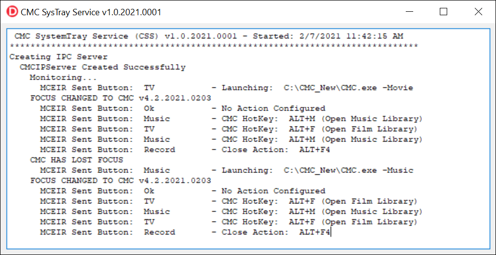

This is working better than I hoped!
The ability to determine when CMC has focus has allowed me to program different actions. In the screenshot below, when CMC is not running then TV launches CMC in Movie mode, and Music launches CMC in Music mode. Once CMC is running and has focus, those exact same buttons instead issue the built-in CMC Hotkey to switch between the Movie and Music libraries.
I should have done this years ago.... sorry guys.
