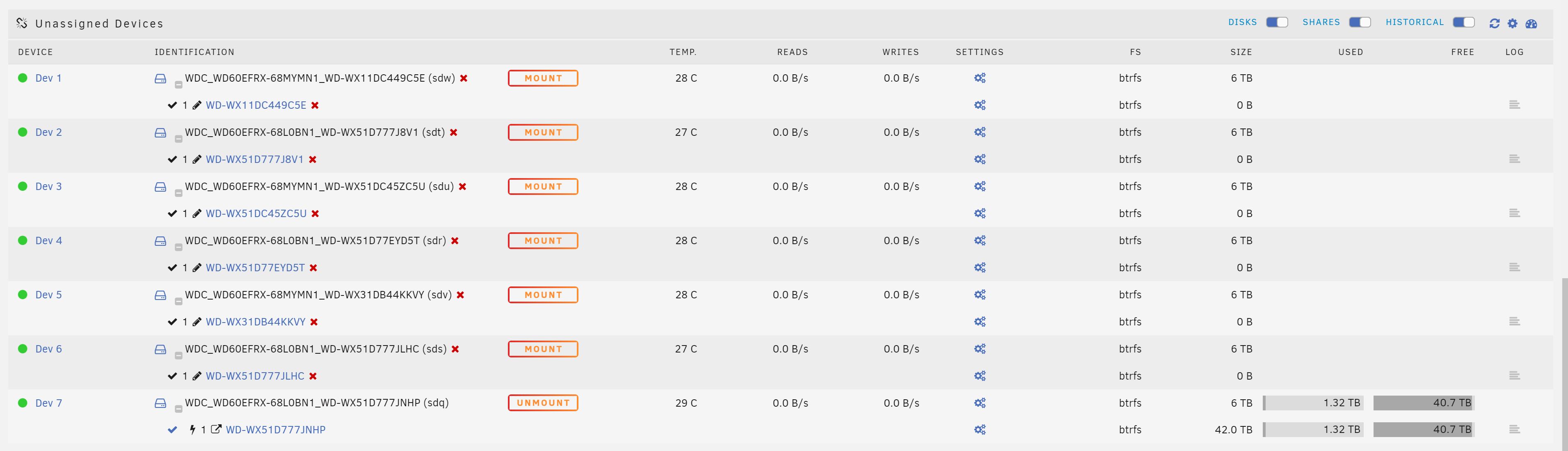

I did one last test after deleting the pool, following your suggestion/question, I tried to mount the first disk using UD, it does report the total size ofr the pool (used size/free size) correctly but it doesn't mount the other disks, so I don't think that a pool created by Unraid can be mounted with UD:
Mounting deleted pool.JPG (248.13 KiB) Viewed 23092 times
I'm stopping the experiments with this as I don't need the backup pool on Unraid anymore, but I'll keep an eye here in case your friend comes back with useful info, for future use.

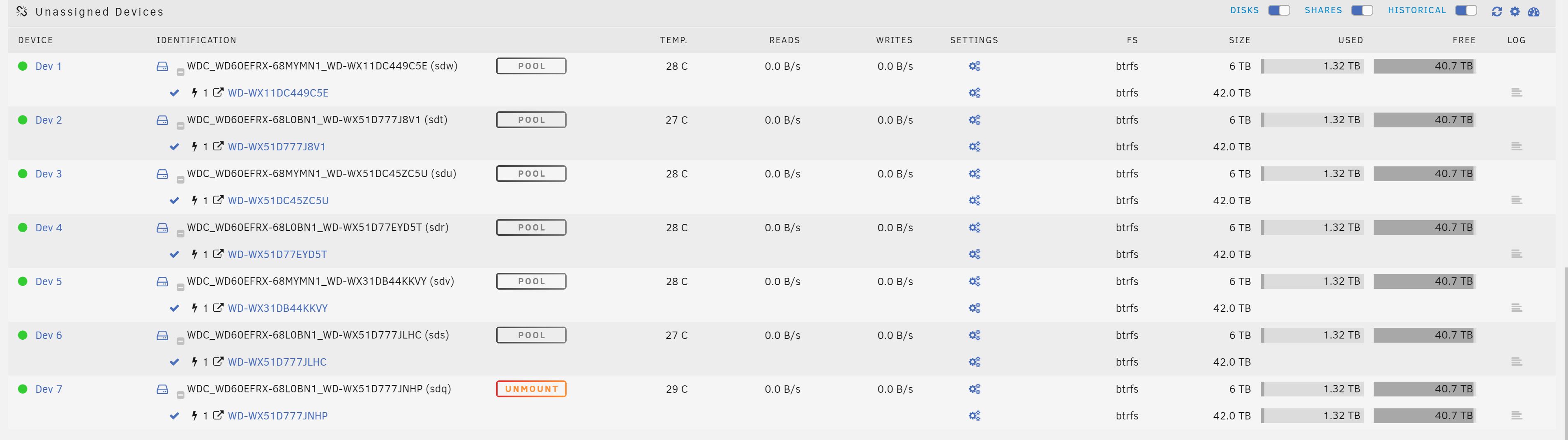

EDIT: I spoke too fast. I tried mounting the other disks manually, and they say "pool" once mounted. So it looks like this might work.
Other disks.JPG (260.08 KiB) Viewed 23084 times
So if the pool can be used like this, it means that the main difference is that you have to manually mount all the disks, vs UD mounting all the disks automatically when you mount the first one (as it is my understanding that this is the way it works for you currently).

Corrected wrong screenshot in previous post.

Following the above posts, I checked the content of the UD mounted deleted pool, and if I go to "disks" in MC, the backup share is present in any of the disks part of the pool, but the pool doesn't appear as a single pool.
Also if you unmount the first disk, all the other disk remain with "pool" greyed out, and there is no way to unmount them.
So using UD to use a pool created by Unraid doesn't seem to be a good idea...
