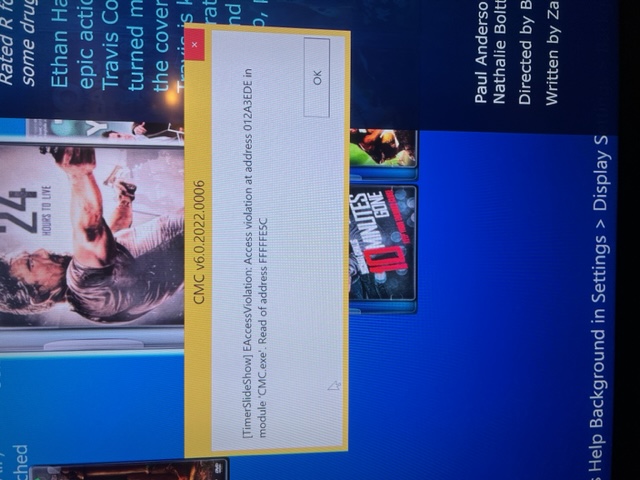

Of note: I am using CME/CMC on a flash drive on Windows 8.1 Media center, running the Beta version v6.0.2022.0006 Beta (because I had better results last time after reading the post you wrote for someone else to try).
Everything seems to be working as designed, export went perfect with no errors, sync has all movies and artwork with no errors. The only exception is that now I am receiving an access violation when viewing the movie covers. It appears to happen when left alone without touching anything. If I scroll over to another movie and leave it there the violation appears after approximately one minute. I went to settings and checked the movie screen saver start delay and it is set at 60s. Perhaps this is the violation. It also appeared on the settings display while I was typing this, but has not appeared again while sitting on the settings page. Viola, Changed the setting to 120s, and sure enough, changed movie selection, sat and waited and about 2 minutes the violation popped. There is no screen saver appearing, so not sure what is supposed to happen at that time setting, but I see no change. Maybe this would go away with the final version, or it is a path with windows 8.1 that won’t happen with windows 10/11, or maybe the other violations would come back. That is yet to be told with trials.
Had to take a hiatus to take care of other things, will attempt a spare computer running Windows 10/11 and see what that does, as well as running it from the hard drive. Not sure when I will get the spare up and running. My movies computers being on 8.1 is not a big factor at the moment since they are not used for anything else, I just know at some point I need to get them up to windows 10/11.

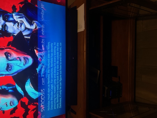

A new thing I found last night while watching movies is the synopsis in 8.1 Media Center. The word wrap now goes behind what I believe is the front/back covers, which are not displaying, causing the synopsis to be partly unreadable. I am going to take a look at that today and see what I can come up with. I am thinking it has to do with the CME export changing the covers, will let you know what I find out as I research it.

just added a new movie to MM and haven't exported or synced it, and the display is the same, so it's not CME/CMC doing it, it's something to do with MM or Media Center. Just wanted to alleviate that concern for you. Will play with settings in MM and see what I can come up with.

Your analysis regarding the Access Violation being related to the screensaver is correct. This is a bug that I fixed for v7.0.
In v6 I had added some new parental controls, to restrict access based upon custom Categories in My Movies. These restrictions affect not only what movies you can see, but what screensaver wallpapers are shown. I had some typos in v6 that caused the screensaver to block all wallpapers, and with nothing to show, the Access Violation pops up to complain.
Sorry about that. But at least it is already fixed for the next version.
robert5733 wrote: Wed Aug 09, 2023 2:02 pm A new thing I found last night while watching movies is the synopsis in 8.1 Media Center. The word wrap now goes behind what I believe is the front/back covers, which are not displaying, causing the synopsis to be partly unreadable. I am going to take a look at that today and see what I can come up with. I am thinking it has to do with the CME export changing the covers, will let you know what I find out as I research it.
If I'm understanding you correctly, you're saying that WMC 8.1 is not working correctly, and that you think the exports for CME are possibly to blame. While I won't say that's impossible, I believe it is highly unlikely. From what I know about My Movies in WMC is that it pulls the images from My Movies via the API in real time, and exporting data via CME doesn't affect that.
On the other hand, My Movies in WMC is getting worse, and Binnerup knows this, and is even saying that he's planning on pulling the WMC functionality out of the next version of My Movies completely. So if I had to guess, an update snuck into your Win 8.1 install and is the core issue behind WMC + MM not working right.

robert5733 wrote: Wed Aug 09, 2023 2:44 pm just added a new movie to MM and haven't exported or synced it, and the display is the same, so it's not CME/CMC doing it, it's something to do with MM or Media Center. Just wanted to alleviate that concern for you. Will play with settings in MM and see what I can come up with.
Definitely check on the Binnerup My Movies forum, this may be a known issue.
But like I just said, Binnerup is planning on killing the WMC support altogether, and even went so far as to tell users to start using CMC. :shock:
