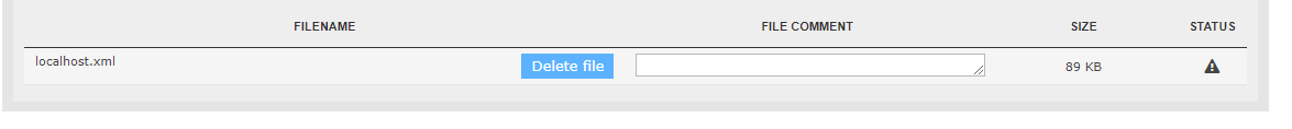

Another try at the XML file. I noticed that there is an exclamation triangle in the status flag.
