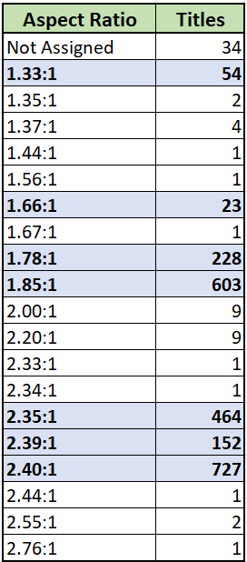

Out of curiosity, I checked my collection to see what Aspect Ratios are common:
I know your collection is bigger, but this should be fairly representative of a typical collection. Looks like there's about 7 main aspect ratios to worry about. And since you're limited to 10 lens memories, this aligns pretty well with those limitations.
The question would be how to handle the inbetweens. If you get a 2.33, 2.34 or 2.35, you probably want to just use your 2.35 setting. In the batch file, I can pass the value as a string and you could do a text match (i.e. if AR = "2.33" then do :AR235), or we can evaluate them as numbers. When evaluating numbers, we could say if AR > 2.3 and <= 2.38 then do :AR235, and if > 2.38 and <= 2.44 then do :AR240, something like that.
I think I like the number range evaluation better, that way regardless of what freak AR is configured for a movie, it will automatically fall into the best range for which you have configured a lens memory.
Does this sound good to you too?

The next step is for me to write a demo program that will call this batch file and pass an aspect ratio to it.
Note that the aspect ratio ranges I came up with were just a first pass, best guess effort. Obviously each user would adjust to their own setup and preferences.

First, re the variable A/R titles, this is a known issue. It's handled by madVR/Envy/Lumagen by selecting a fixed A/R that doesn't lose any content (you have other options) when they detect frequent A/R changes in the same title. This only works for instant A/R detection, not for the CMC implementation.
With the CMC implemtentation, we simply have to select the correct A/R in CM. for example, 1.78 for me (1.78 screen), or if someone had a scope screen, they would probably select 2.4, and their 2.40 installation mode would simply mask/crop the top and bottom of the imax shots, so that they look like 2.40 as well. Most variable A/R movies with iMax sequences are framed that way, so that you can lose the top and bottom without losing essential info, precisely for this reason (so that the film can be shown in non-iMax venues as well).
I agree that the batch files approach is the fastest/easiest/most flexible approach, that's why I suggested/recommended it to start with. I had linked to python source code, you might have missed my post. I don't think we need the complication of having to recode what jvccontrol.exe already does perfectly.
Re your batch file, it won't work, simply because the A/R in MyMovies CM are fixed. You can only choose in a list of 7 A/R, you can't enter the exact A/R, so your batch file doesn't have to manage that given that it will never get any A/R that isn't in the CM list.
Here they are:
2.40
2.35
2.20
1.85
1.78
1.66
1.33
This was done at the time, many years ago, based on the majority of A/R in the entire MyMovies database. I could ask Brian to add a few, especially 2.0 (Univisium) which is frequently used by Netflix/streaming as a compromise between 1.78 and 2.40. There is no significant difference between 2.39 and 2.40, and the info in discs isn't always reliable, so 2.40 is usually fine. That's usually the actual size of scope screens (though some are 2.37 to split the different between 2.35 and 2.40).

Manni wrote: Thu Nov 09, 2023 1:01 pm Re your batch file, it won't work, simply because the A/R in MyMovies CM are fixed. You can only choose in a list of 7 A/R, you can't enter the exact A/R, so your batch file doesn't have to manage that given that it will never get any A/R that isn't in the CM list.
Sorry, not to be rude here, but you are wrong. The logic does work (already tested on my end) and the data I presented in the chart is from my own My Movies collection. I can't say I know how the "now invalid" values made it in there, but most likely it is very old data from older My Movies versions that didn't restrict the values, and no one has cleaned it up. These are the values that are exported and passed to CMC as well. So failing to handle them will result an occasional processing failure.
I'm pretty sure you have the same in your collection to. Also know that this is not something you can double-check in the MMCM GUI, as the GUI code probably defaults or auto-correct these for display, even if they are incorrect in the DB and API export.

Manni wrote: Thu Nov 09, 2023 1:01 pm 2) As explained, get rid of all the greater than etc, currently you have only 7 fixed values to deal with (listed above)
Wrong. As explained, the data in MM is not near as clean as the GUI suggests.

Manni wrote: Thu Nov 09, 2023 1:22 pm Further to my last two posts, re the rogue A/R, I didn't know it was even possible.
If only that was the full extent of the madness. Don't even get me started on the data corruption bugs...
