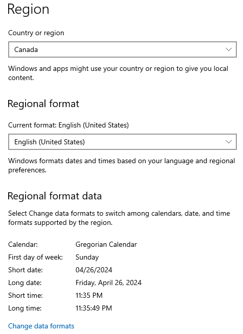

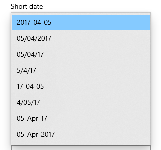

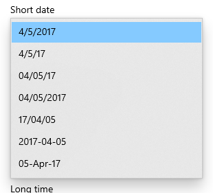

Did some experimenting and sure enough, the US and Canada have different date options by flipping around the Regional Settings back and forth!
US options: Canada options: PS - I did these tests before reading your full previous reply where you suggested I run some exports BEFORE screwing around with the Regional Settings. I will try to step through your instructions shortly; hopefully me toggling the regional settings around for my own test didn't screw up the results you're inquiring about.

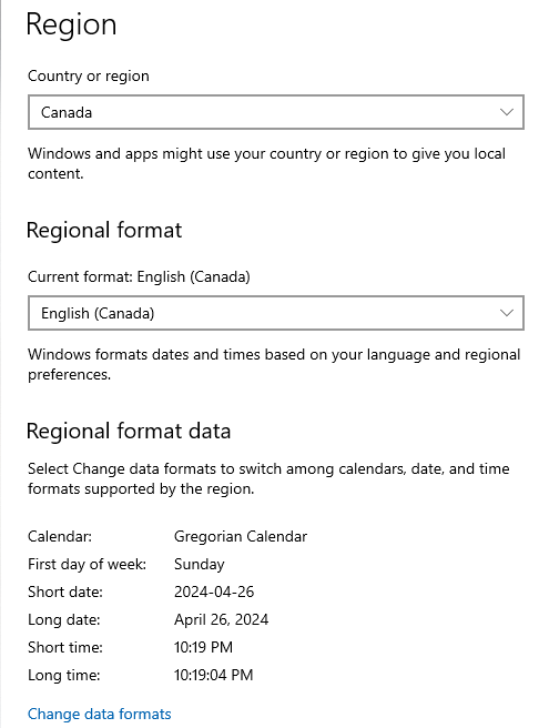

Yes. I did play around with my Regional Settings to see what changes, if any, would occur, but I ran those exports while my regional settings were back to what they originally were, as they show now:
Re: Movie Dates all 01/01/9999 ?
My best guess is that CCC is observing your PC's regional settings, so YYYY-MM-DD, while My Movies is ignoring them, so MM/DD/YYYY. I would have to do more research to confirm, but first impressions are probably spot on.
If that's happening, then that date format mismatch would explain why the disc release date isn't showing properly.
As to why it's not happening to more/all date fields... well, perhaps I missed this particular date in my translation logic. Or perhaps I'm grabbing the "display" version of the disc release date (no idea why Binnerup has the same date in two formats, but they do, and I don't see it on other fields), and that is failing the translation.
For now, I would say go ahead and change your region to US and the short date format to mm/dd/yyyy. Then run a full export. I'm pretty sure that will clean things up.

In the mean time, I've been looking at my code. I grab the Release Date from the XML, which from the sample you sent me yesterday looks like this:
<ReleaseDate>5-29-2011</ReleaseDate>
My code then identifies the month, day, and year fields by looking for the forward slash ("/"). If that fails (and in your case it does, because it's a dash separator not a slash), then it defaults to 01/01/9999, which is what you're seeing in CMC.
What's odd to me is that the My Movies date doesn't exactly follow your PC's short date format. If I'm looking at it correctly, your short date is YYYY-MM-DD (unless you accidentally changed it before you took the screenshot), and My Movies is outputting MM-DD-YYYY. It's almost like My Movies is grabbing the separator character, the dash, but using its own field order. Looking back at your Canada region short date options, MM-DD-YYYY isn't even an option.
I'm thinking the workaround here is that you simply need to select a short date format that utilizes slashes instead of dashes. The assumption here is that My Movies grabs the separator character to apply to its own date format.
On my side, for the next version of CCC & CMC, I have adjusted my code to work with dashes as well as slashes. This will affect all dates, not just the Disc Release Date.
I'm really hoping that My Movies is at least consistent in always outputtting MM-DD-YYYY or MM/DD/YYYY, since if they have any other variations then my code will still break. Binnerup should have either used a single, static date format, or always applied the PC's short date format, but not this crazy hybrid. Of course, this is just one example among hundreds or maybe thousands where I've had to create special logic to extract data reliably from My Movies...
