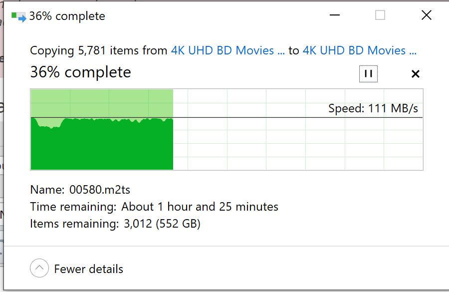

For some reason, I can now copy at full gigabit speed again from the Qnap to the Unraid server using my windows Ryzen:
Full speed.JPG (62.25 KiB) Viewed 9119 times
This is what I got in my initial tests. But for some reasons, it doesn't hold and sometimes hobbles the speed to 60MB/s.

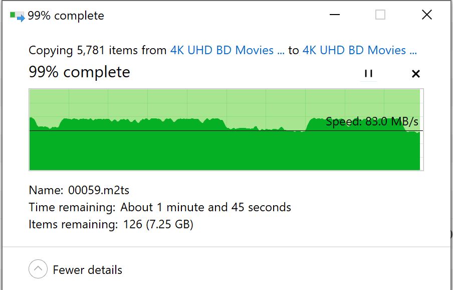

Even when it does, the connection is gigabit, but seems to be limited to half duplex. No idea what triggers this.
Edit: As you can see, the performance also fluctuates between 80MB/s and 112MB/s, for no obvious reason (nothing else running on either server):
Speed fluctuation.JPG (60.53 KiB) Viewed 9108 times
Now the plot thickens following the edits to my last post:
I've tried to resume the copy from the last batch that hung, and it hang on exactly the same file, in the same folder. So I tried to copy the folder to my local SSD on the Ryzen to rule out an issue in the source data, and it copied right away. So for now I've skipped this folder, and as you can see in the screenshot above, the copy is going happily at full speed. Once it's done, I'll try to copy the folder that caused the issue again.
