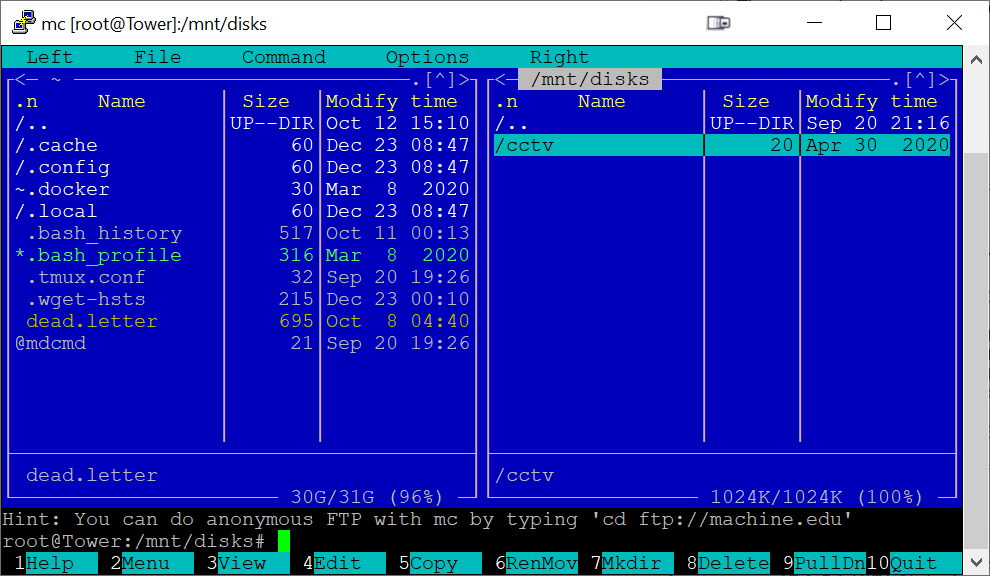

2) I can point to the local shares easily, but I can't select the SMB share that I've mounted with unassigned devices. It tells me the mount point is TS859_4K UHD BD Movies DL, but how do I get there with MC?

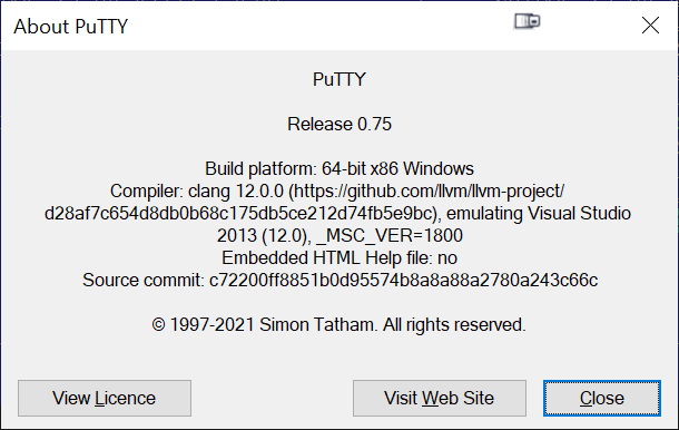

Manni wrote: Thu Dec 23, 2021 12:28 pm 1) The mouse doesn't seem to work (DOS was a nice evolution, I started with a ZX81, so I can survive)
I'm using Putty 0.75 on Win10. That gives me the mouse support.
Manni wrote: Thu Dec 23, 2021 12:28 pm 2) I can point to the local shares easily, but I can't select the SMB share that I've mounted with unassigned devices. It tells me the mount point is TS859_4K UHD BD Movies DL, but how do I get there with MC?
The path is /mnt/disks/, as shown below. /cctv is my only Unassigned Devices mounted disk:

Re MC, thanks, I'm using the latest 0.76 of Putty, so should be the same. I had looked into disks and remotes, but the folders were empty. I then realised that for some reason the SMB share was unmounted. I mounted it and it showed up in remotes. So all is good! I'll run a few tests and I'll let you know how it goes. Thanks again!
