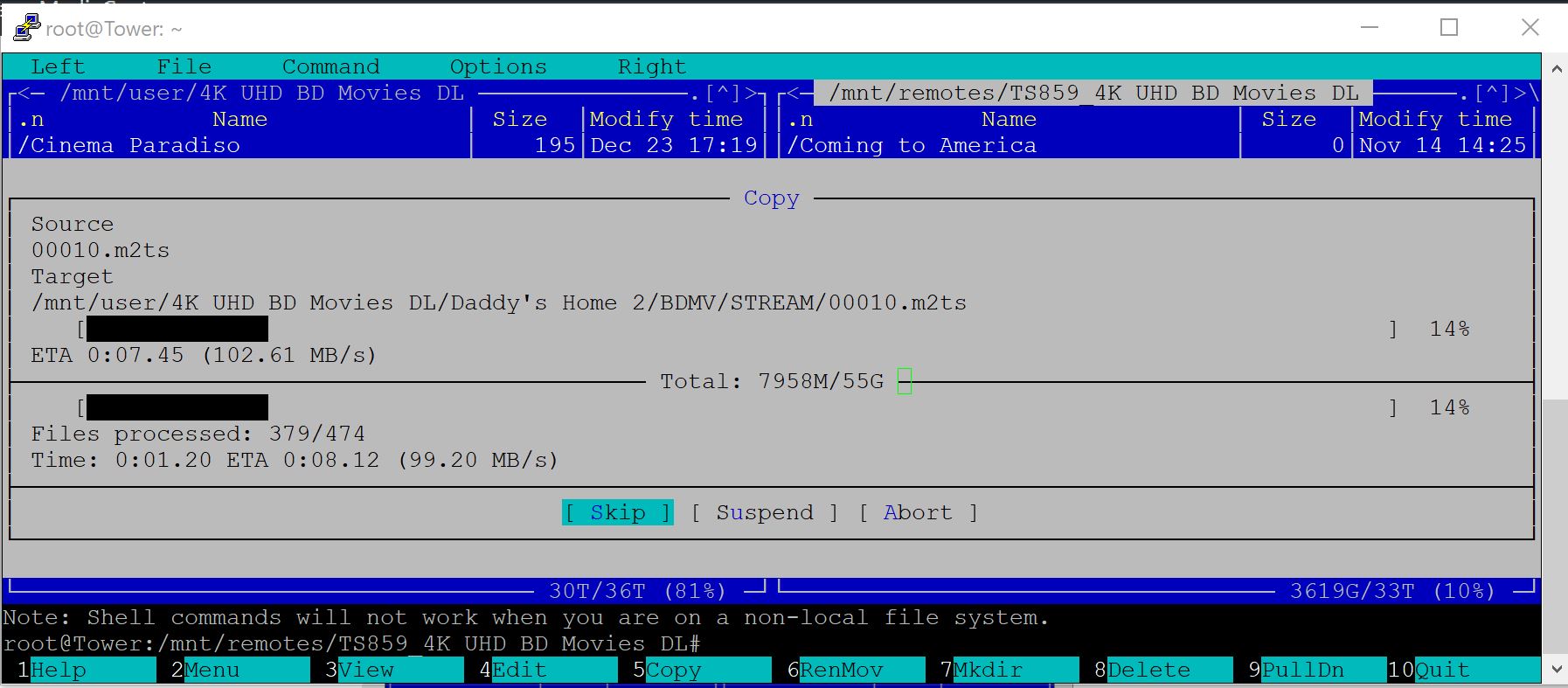

Did a test on a single folder, speed is a bit below the Windows client (when it works at full speed), 105 MB/s vs 112 MB/s, but it's a lot more convenient if I can do it in one go as it can just run 24/7 until it's done.
MC Speed.JPG (189.31 KiB) Viewed 6327 times
I'll start the copy of the whole share and I'll let you know how it goes.
EDIT: yes, as I said, no mouse isn't a dealbreaker, I'm used to the DOS interface, I used to use MC on DOS :)

Manni wrote: Thu Dec 23, 2021 1:18 pm 105 MB/s vs 112 MB/s
Well it should be 105 MB/s consistent, instead of fluctuation from 120 down to 60, so maybe it still wins the race.

Performance seems stable at 110 MB/s, so all is good for now.

For now, MC has moved gracefully to disk 3 and has started to fill it up. It's still moving data at a nice and steady 110MB/s, so it's definitely more performant than the Windows client, as the speed would fluctuate between 112MB/s and 80MB/s, and even down to 60MB/s if I paused the copy process.
