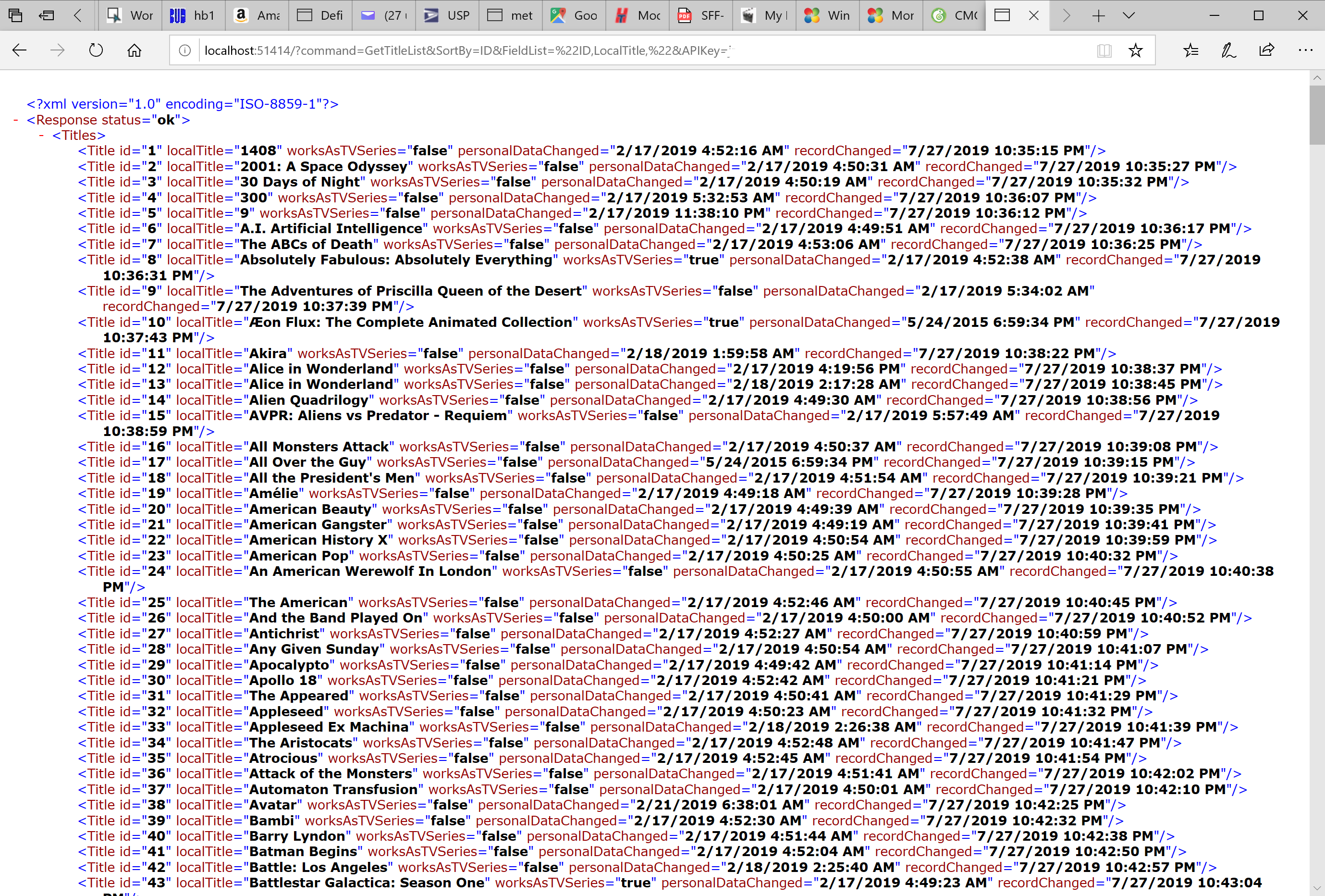

It's working on the client side, but not on my server essentials install. In my frustration, trying to install MyMovies on my server, I by mistake grabbed a older version of MyMovies 5.0.0.100 to be exact and installed on my pc for the client side software. It wasn't working because of the version mismatch. How did I discover my mistake? Easy. I happened to look at the version when I clicked on about when I was looking at my client installation. I then uninstalled it and grabbed the correct install file for the client. Guess what. The url works as expected and it came back with a response very quickly which doesn't surprise me since I only have about 500 movies which is not a big collection compared to some other users. Moving forward the solution for now is to install the client side of MM on my htpc for the time being. I can run CM and CME on my htpc. In my view this is not optimal, but workable for the near future. The ideal install for me would be to have CME run on my actual server.

Teddyboy wrote: Tue Jul 30, 2019 11:01 pm It wasn't working because of the version mismatch.
Great detective work. I'm not sure that issue would have occurred to me. I did briefly consider looking up the API command that returns the My Movies version and having you try that, and now I wish I had done so, as it might have got you to this realization quicker.
