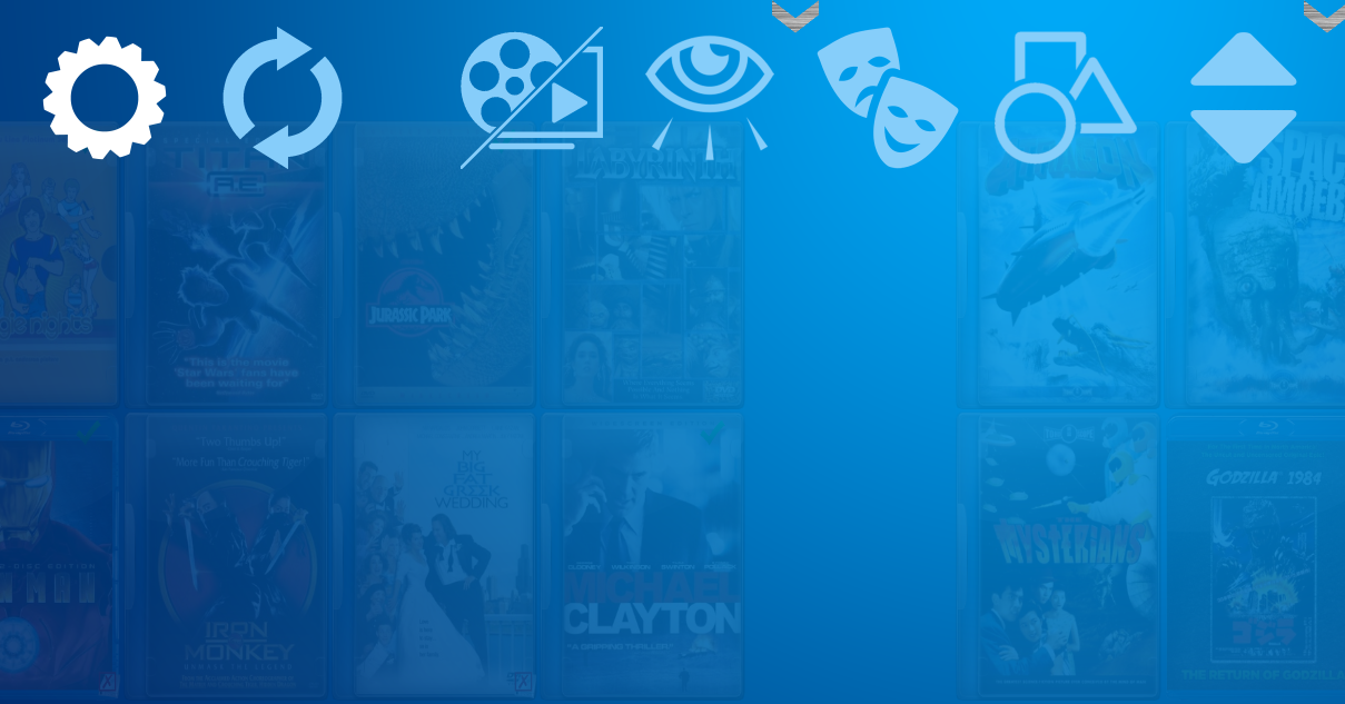

Okay so this is weird. I switch inputs and wake my HTPC to see that it has synced with CCC and has loaded all data and covers for my movies. It was still syncing because the sync icon was still turning and the little jpg icon was in visible in the middle of its. When CMC finished syncing there was no exclamation point in the middle of the sync icon. I still have connectivity to the CCC share, but I still get a timeout error when I test for CCC connectivity after it had finished syncing. The last sync date stamp was visible in the configuration page.
I closed CMC and restarted it. The sync icon had the exclamation point in the middle of the sync icon. I was able to smart sync, and it was able to complete the sync and the exclamation point disappeared. I still get a timeout error when I test for CCC connectivity. The CCC share is still connected as verified by the sync and when I test for it. When I went to the configuration page CMC, the last sync date stamp was blank. When I synced the date stamp appeared.
I closed restarted CMC one more time and the sync icon had the exclamation point in its middle. I was able to smart sync but I got a access violation. The sync did not complete and the exclamation point remained. I tried syncing again pressing the button quickly several times and it took several moments for it to catch up. I'm not able to get it to smart sync or do a full sync. It's trying to do a sync, but it's hard to tell as it gets stuck for several seconds.
Sometimes if I push buttons on the remote or mouse to fast, CMC will hang and get into a race condition then pull itself out of it.
It looks like might be some odd corner case lurking around causing issues.

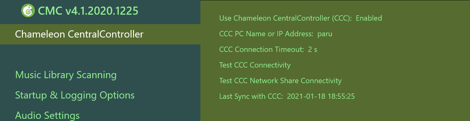

I checked the code, comparing the Connectivity Test procedure to the Sync procedure, and they were 99% identical. I only found one difference:
On the Sync, the Timeout is increased by 2 seconds beyond what is configured for the "CCC Connection Timeout". So if you have the timeout set to 2 seconds, then the Test uses 2 seconds, while the Sync uses 4 seconds.
So if your connection is slow to be established, that could explain why the Test is failing while the Sync is succeeding. I programmed it this way so that the Sync, which is more important than the Test, is more robust. For example, increasing the Timeout from 2 to 4 seconds might fix the Test, and bumps up the Sync to 6 seconds, making it even more robust.
From your screenshot, I see you currently have the default of 2 seconds configured, so definitely try increasing this value. Be sure to Save this change.
By the way, there is a downside to increasing it too high. When you start CMC, if the connection fails, the startup hangs for the entire duration of the configured Timeout. So if you configured 60 seconds, then when you start CMC, if the connection ends up failing then CMC hangs for 60 seconds on startup. Lower values make CMC more responsive in this scenario. There are times that the connection will fail for valid reasons (i.e. CCC is down, the CCC PC is down, the network connection is down, etc.), and you may find it frustrating to sit there for 60 seconds simply because you forgot to restart your CCC PC or something like that.
The 2 second default was just a good value based upon my own internal testing, but may not be appropriate for all users. Based upon what you've told me so far, I'd guess around 5 seconds might do the trick.
I'm not sure why this didn't work before. Perhaps something else changed too since you last tested increasing the timeout. Regardless, definitely try increasing it again, Saving the change, and see how that works out.Teddyboy wrote: Sun Jan 17, 2021 8:34 pm I've also tried different timeout values from the default 2 seconds. I went all the way up to 60 seconds, and it still timed out.

Well I put the timeout to 5 seconds and it works fine. Connection to the server and the database appears to be fine. I'm getting another problem now. Two issues. JRiver does not go into full screen nor does it quit when I press the button to quit it and go back to CMC. It's the same configuration that I've been using for a long time now. CMC should just put it into fullscreen mode. I'm getting access violations when I try to play a movie or a episode be it from a blue ray or DVD. It's not on every movie or TV series. It seems random, and I know that these titles play fine because I've viewed them in the past. Media corruption isn't the issue. One step forward two steps back.
