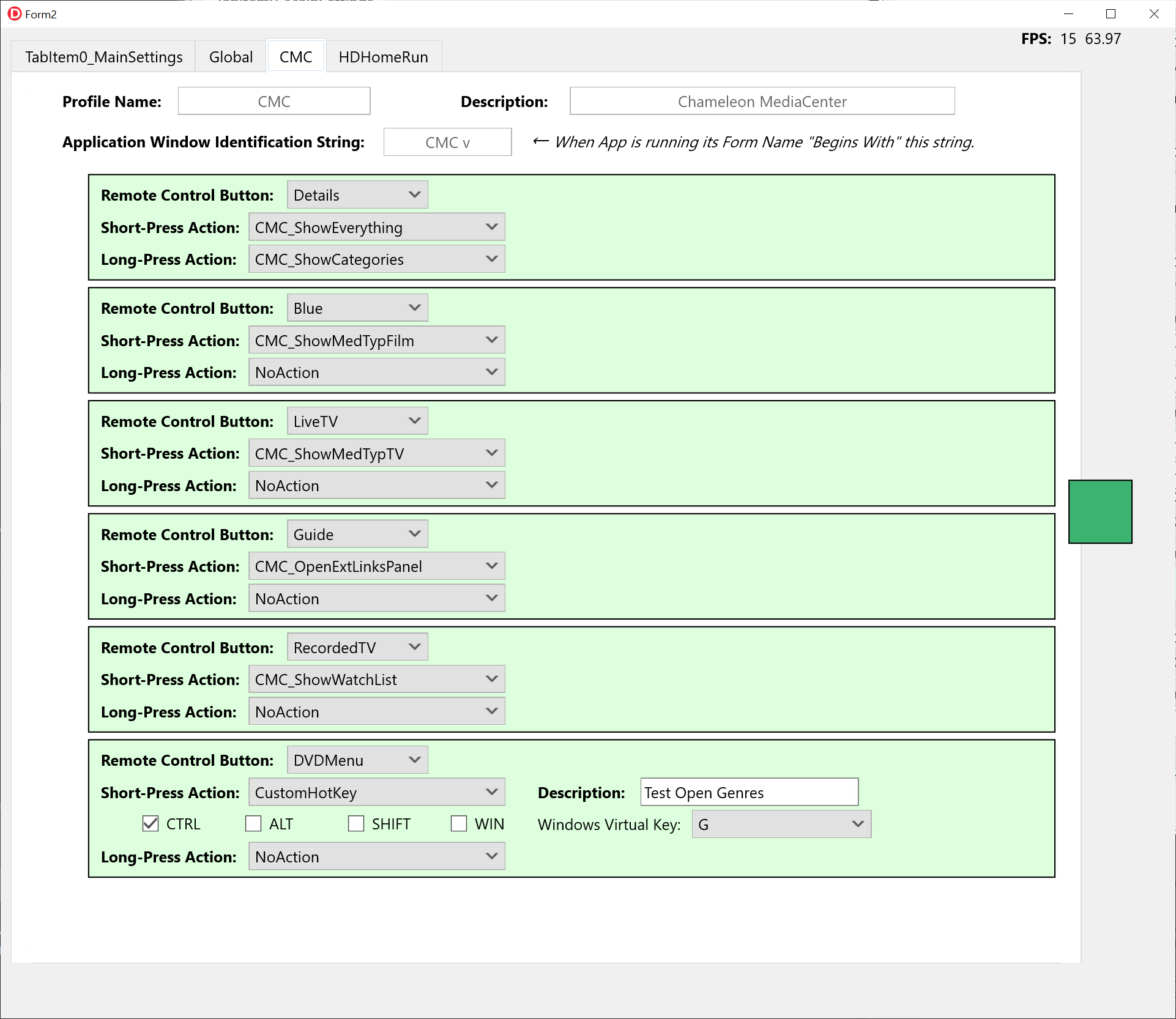

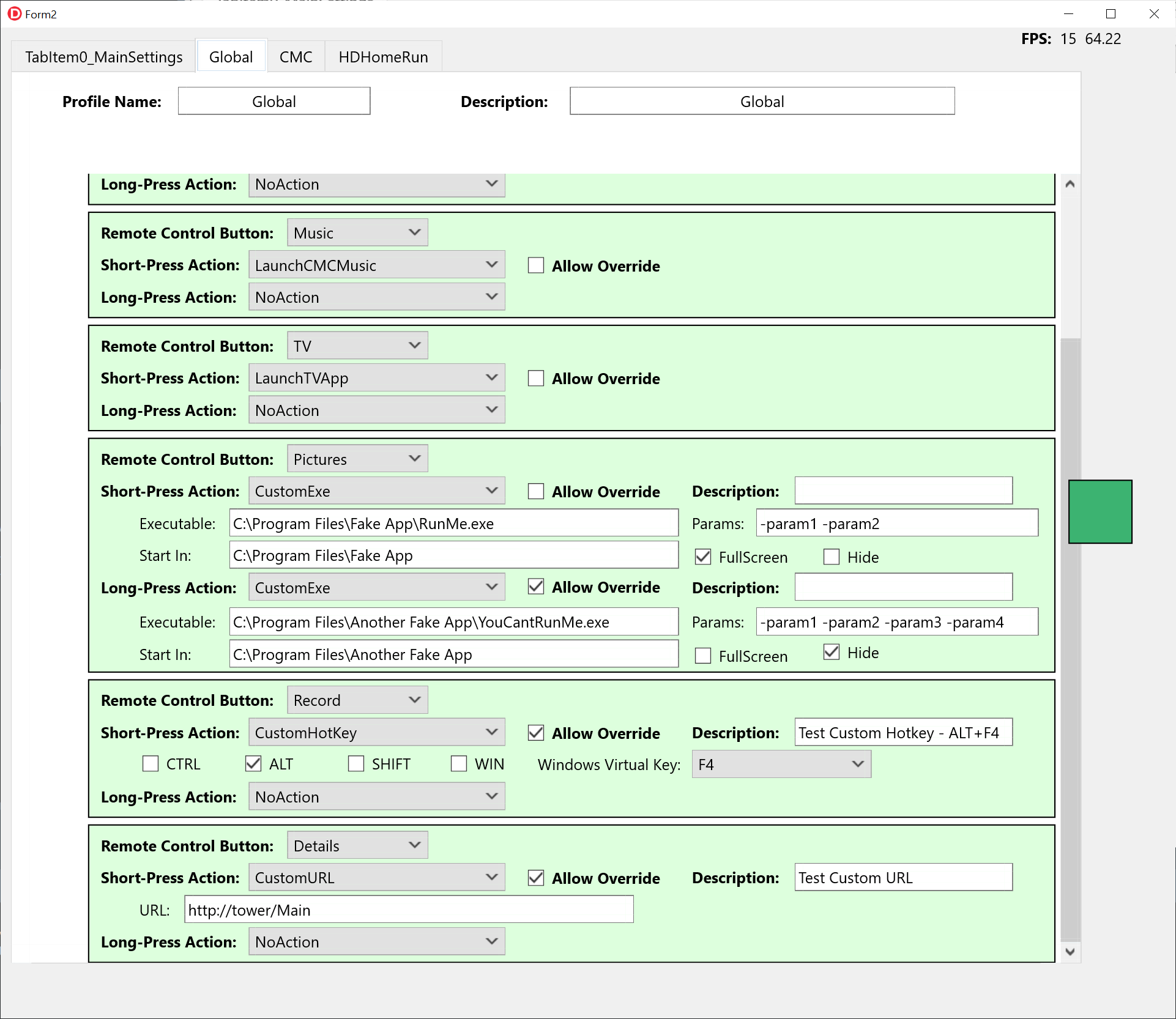

I've been working for a few days on designing the new remote control configuration options, and finally have it to a point that it mostly resembles how the final product will work. Before I get much further, I would appreciate feedback on the new configurator.
Here's a screenshot showing the "Global" tab. Across the top you can see there are more tabs for CMC and HDHomeRun - those look exactly the same as Global, except they don't have the "Allow Override" option that you see on the Global tab.
Beyond that, I won't tell you anything other than hopefully the picture speaks for itself.
There's obviously more design work to do, like Add/Delete buttons, plus sorting buttons, but otherwise what's inside each green panel is 95%+ complete, so I'm really just looking for commentary on the green panels themselves.
Here's the CMC tab too, which might give you more insight into the GUI, with the main difference being that most CMC actions are pre-defined instead of custom:
Feel free to ask questions - that's how I can evaluate what makes sense and what doesn't.

This looks good to me and I think that I understand how it should work. Can you use a customized link so the remote can control the lights in a room by either turning them off and on or dimming the lights. That would be great! I also read on the Mymovie.dk website that some time in the future you may consider providing Amazon Echo features which would be great. I would really love to see that feature too! I realize that it might be awhile and I will temper my expectations for now.
