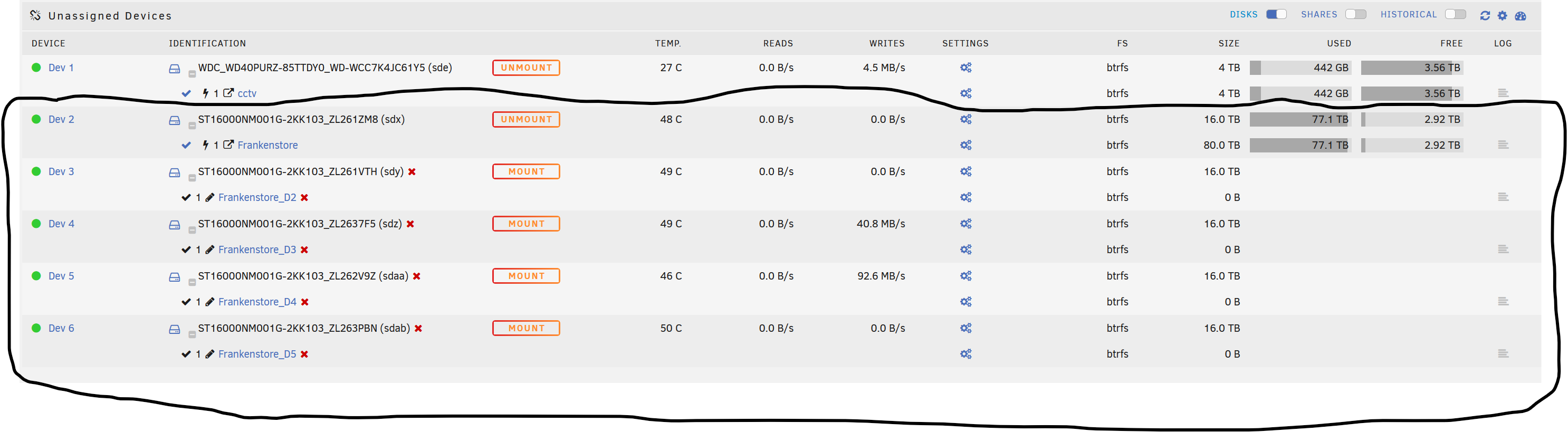

Manni wrote: Sat Apr 09, 2022 7:11 pm Following the above posts, I checked the content of the UD mounted deleted pool, and if I go to "disks" in MC, the backup share is present in any of the disks part of the pool, but the pool doesn't appear as a single pool.
Also if you unmount the first disk, all the other disk remain with "pool" greyed out, and there is no way to unmount them.
So using UD to use a pool created by Unraid doesn't seem to be a good idea...
Your first screenshot is the correct result (the one you thought wrong), except for best results you should have done the mount using the 1st device (maybe you did?). When you do this, you see the correct pool size on that device, all of the other drives show no space.
Your second screenshot is where you messed up. When you mounted the other drives, you essentially loaded multiple copies of the pool. That's wrong, and probably why you got the weird result above.
EDIT: For reference, here is my Frankenstore backup pool screenshot (from the 1st post) - note the drives show no space and the MOUNT button is usable but should be ignored on the extra drives:

As reported, I did mount the first drive. But the other drives, as per the first screenshot, were not mounted automatically, so didn't show any size or any indication that they were part of a pool. Hence it didn't look correct to me. When you described the correct behaviour, you said that mounting the first drive would mount all the others automatically. Did I get that wrong? This is still what you describe in your updated step-by-step. Hence why I tried mounting the other drives manually. Mounting the first drive also doesn't give access to a pool, only to the first drive. How do you get access to the pool name, as happens when the pool is mounted correctly?

I just updated my post above with the screenshot. I agree, it looks confusing in the GUI, as the extra drives just sit there looking unused. What matters is that the mounted partition shows the full amount of pool space. The Unraid Pools feature does a better job of displaying this info.
While this may be a moot point for you, I think it is important for others to understand how this works. You mount the first drive, and the others automount with it, but the GUI makes it look like nothing happened. This confused me too in the beginning years ago. You have to just trust that it's working, with the only indicator being the mounted partition's size being larger than the drive.
Because of the way btrfs works, the pool info is replicated on each drive, so technically you can mount any one of the drives to mount the pool. The recommendation to only mount the 1st drive is for more accurate size reporting. The stipulation to only mount a single drive is to prevent from mounting multiple copies of the same pool, since that pool definition exists on all drives. It would be nice if UD handled this a bit better, but since technically you can have multiple partitions/pools each drive, I can't fault the developer too much for the confusing way this works.
