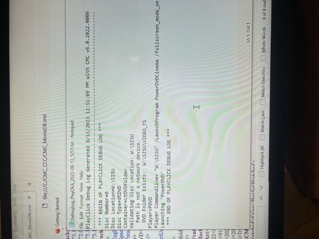

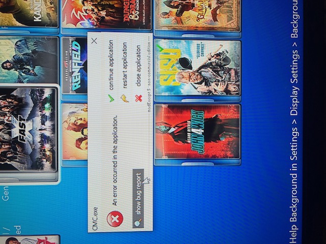

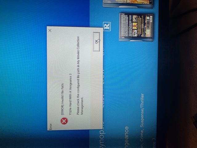

Perfect>>>>Not so fast…select a movie to play and….error…Invalid file path(attached 3 Debug logs that mention errors). Closed out everything and opened CMC_CME and played the same movie and no problems launching PDVD and playing the movie. The debug says “Path is not a network device” “Folder Does Not Exist” “Folder may be on a Mapped Drive - Attempting to Refresh” “Mapped Drive Refresh Failed - Disc Location Invalid”. I remember somewhere in your instructions, it says Binnerup states MM won’t work with mapped drives, but it works with CMC_CME just not CMC_CCC.

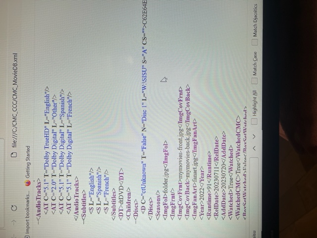

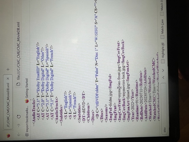

First thing I found is that if I close CCC and then open CMC_CCC I don't get the error "C:\CMC_CCC\CMC_MovieDB.xml". The process cannot access the file because it is being used by another process.” Still can't play a movie though, same error about path invalid
More digging has uncovered the possible problem. Played the movie in CMC_CME and got the debug logs to compare with CMC_CCC. The container in CCC is ctUnknown, whereas in CME it is ctDVDFolder
Here are the pics of the CMC_MovieDB.xml files for the same movie

Ironically, it is the Debug Logging that is causing that particular error. The file CMC_MovieDB.xml is in a human readable format, which can help with debugging, but it is a large file that can be slow to write. It is not needed for normal CMC usage, the smaller and much faster CMC_MovieDB.bin file is used instead. For this reason, I have CMC only create CMC_MovieDB.xml when Debug Logging is enabled, and solely for use by humans.
So by having Debug Logging enabled, CMC is writing to a large, slow file, and it is trying to do this from multiple code entry points at the same time. As CMC has become faster, this competing for file access rights has become more and more of a problem, so it's quite common now to see this error crop up.
Long story short, it totally doesn't matter. This file is only useful for debugging purposes, and these errors don't cause any harm, only a nuisance. And the solution is to turn off Debug Logging.

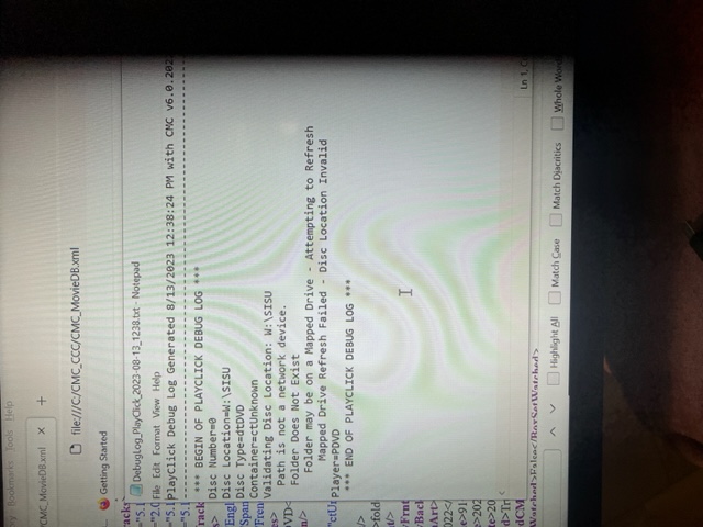

robert5733 wrote: Sun Aug 13, 2023 3:08 pm select a movie to play and….error…Invalid file path(attached 3 Debug logs that mention errors). Closed out everything and opened CMC_CME and played the same movie and no problems launching PDVD and playing the movie. The debug says “Path is not a network device” “Folder Does Not Exist” “Folder may be on a Mapped Drive - Attempting to Refresh” “Mapped Drive Refresh Failed - Disc Location Invalid”.
Unfortunately, this is a collection management issue - you have not been following Binnerup's guidelines for how to manage your collection.
Earlier we talked about the differences between CMC+CME and CMC+CCC, and one difference I neglected to mention is how file paths are treated between the two solutions.
With CMC+CME, you simply point CMC to a file path (mapped folder, network drive, local directory, all good no difference to CMC). CMC scans the folders, finds everything it can find that is playable, and builds your collection from scratch based upon what it found. And of course, it stores the file path to every playable file based upon its search results.
With CMC+CCC, CCC extracts the file path from My Movies and shares it with CMC. So now the file path in CMC is exactly what you configured in My Movies Collection Management. And while that should be a good thing, in your case it's now a problem.
robert5733 wrote: Sun Aug 13, 2023 3:08 pm I remember somewhere in your instructions, it says Binnerup states MM won’t work with mapped drives, but it works with CMC_CME just not CMC_CCC.
Yes, CMC works fine with mapped drives. It could care less if a drive is local or mapped or a network share. But the problem arises when the mapped drives of one PC are different than the mapped drives of another PC.
For example, on you My Movies Collection Management PC, you have a drive W mapped to some path, such that W:\SISU points to a playable title on your MMCM PC. But on your CMC PC, it doesn't have drive W mapped at all, or if it is mapped, it is mapped differently, pointing to somewhere else, so that W:\SISU isn't reachable. In this case, it's impossible for CMC to know how to fix this, so a playback error occurs.
This type of issue is the primary reason why Binnerup says mapped drives are unsupported, and I fully agree with his perspective. A mapped drive is nice as a human conveyance, a convenient way for you to quickly access a network resource. But for a multi-PC application like My Movies and CMC, this is now a hindrance.
If you perfectly replicate your mapped drives on each and every PC, this issue should be mitigated. But honestly, the right solution is to not use mapped drives at all with My Movies.
robert5733 wrote: Sun Aug 13, 2023 4:12 pm More digging has uncovered the possible problem. Played the movie in CMC_CME and got the debug logs to compare with CMC_CCC. The container in CCC is ctUnknown, whereas in CME it is ctDVDFolder
No, this is not the issue, and this is working as designed. In CMC+CME, when CMC scans each folder it determines if the media is a DVD, Blu-ray, 4K UHD, or some type of encoded media, and this media type info is stored in CMC's DB for future use.
In CMC+CCC, the My Movies API doesn't provide the same level of detail as to what format the media exists (and what little detail My Movies does provide is often incorrect anyway). So ALL media from My Movies to CCC is flagged as Unknown.
At that point, I had a choice to make - I could either have CCC scan every folder to determine what media type exists there, which would wake up all your sleeping servers/drives adding unnecessary wear and tear and energy consumption, OR I could have CMC scan the folder only on playback. I chose the latter option, because it was the most efficient and it happens fast enough that you don't even notice it occurring.
But that can only happen if the media folder is reachable. Had it been reachable, CMC would have replaced ctUnknown with ctDVDFolder or ctISO or ct4KUHD or whatever else it found, and then chose the right playback options, all in real-time. So the problem above remains, the mapped drive path is incorrect, a side-effect of which is that CMC can't determine the container type.
So, ultimately you have two options. One is to fix your filepaths in MMCM to not use mapped drives, but rather point directly to server(s) network paths - I recommend this!! The other is to add the exact same mapped drives to each and every PC.
This second option, adding mapped drives, seems like a ton less work and will produce quicker results, but in this case you may a secondary issue that is about to bubble up, and again the issue would be with your filepaths in My Movies. Hopefully it's not an issue at all, but some users incorrectly map their movies by pointing at the inside subdirectories like VIDEO_TS. For example, good and bad below:
  • \\Server\MovieName\Disc1 <--GOOD
  • \\Server\MovieName\Disc1\VIDEO_TS <--BAD
I have no way of knowing if you incorrectly mapped any titles using the wrong approach above, but if (and that's a big IF) you did, then simply adding a mapped drive won't fix the underlying problem with bad filepaths in My Movies. So you'll have to determine this for yourself, but if you have this issue, then you'll have to fix in MMCM.

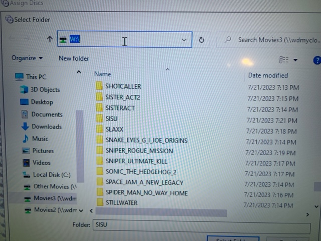

I am using a NAS storage drive, with what will be my server PC mapped to it now. I only have the one computer running MMCM CMC CME CCC right now, will add another later with just CMC. I have a structure for mapping each drive with w: x: and y:, All computers are mapped alike to avoid confusion with These programs.
Pauven wrote: Mon Aug 14, 2023 12:43 pm This second option, adding mapped drives, seems like a ton less work and will produce quicker results, but in this case you may a secondary issue that is about to bubble up, and again the issue would be with your filepaths in My Movies. Hopefully it's not an issue at all, but some users incorrectly map their movies by pointing at the inside subdirectories like VIDEO_TS. For example, good and bad below:

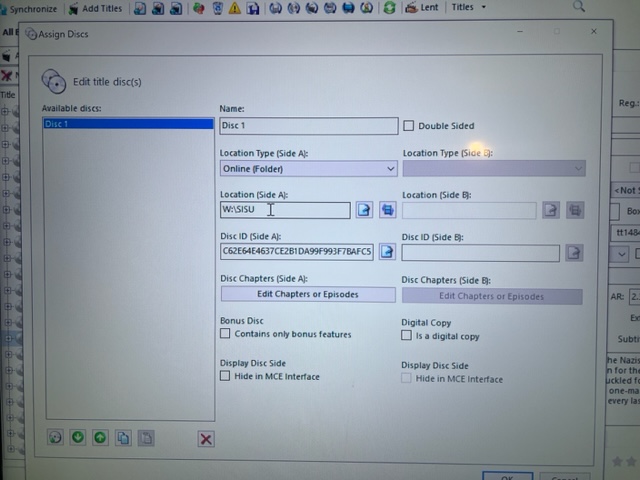

I am going to work with SISU since that is what I already showed logs for.
This is the disc path assigned in MM W:\SISU
path assigned mymovies.jpg (93.09 KiB) Viewed 12939 times
By clicking location type (Side A) for the path we see a location choice for W:\SISU
path choosing movie in mymovies.jpg (137.07 KiB) Viewed 12939 times

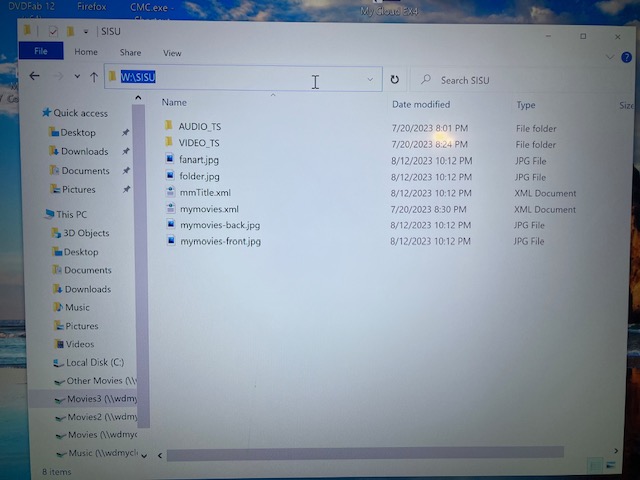

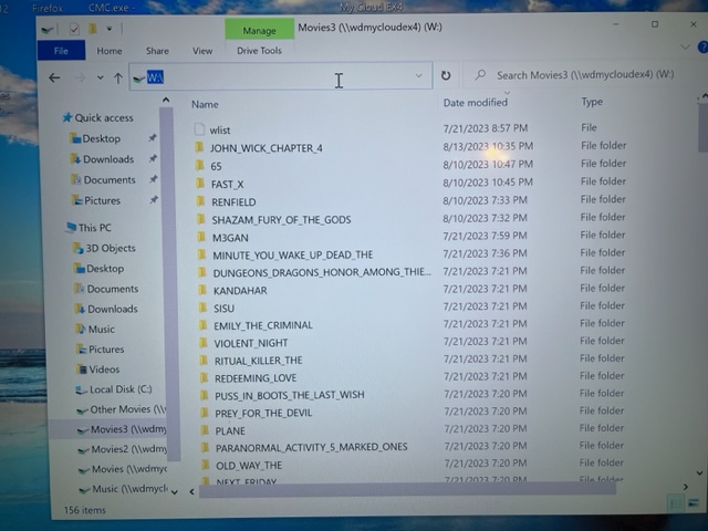

In file explorer we can see W:\SISU as seen in MM assignment
path with w chosen.jpg (135.31 KiB) Viewed 12939 times

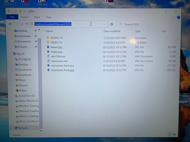

and then the contents of W:\SISU
path with SISU contents.jpg (87.71 KiB) Viewed 12939 times
The actual server path not mapped is seen here
path for actual server.jpg (90.85 KiB) Viewed 12939 times
