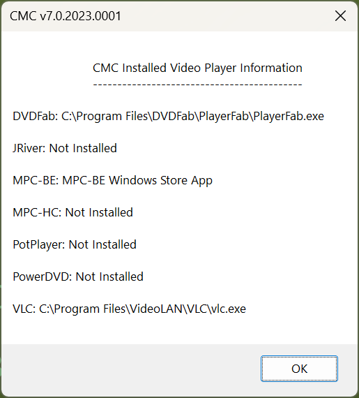

Look closely at that error message. It reads: Unable to run "" <--notice the empty double-quotes, it's trying to run nothing. That's one of my planned enhancements for v7, to make this error more understandable, as it's easy to miss the importance of those quotes.
So in this case, it is not finding the path to the player. I'm assuming this is JRiver MC 31, yes? I know you tried to make 31 work as 30, did you undo those changes?

Don't forget that you can go to Settings > Licensing & About CMC > Show Video Player Info:
It's helpful to see what CMC detects.

yes I reverted all the edits, reinstalled mc31, still not working.
I made the attempt on my laptop I think, not on the HTPC, so I dont think it's relevant.
you are correct, jRiver 31 is NOT detected in the licensing info. have you tried to instal V31 to check if cmc 7 detects it?

I uninstalled / reinstalled mc31 (again), working fine now. :)
