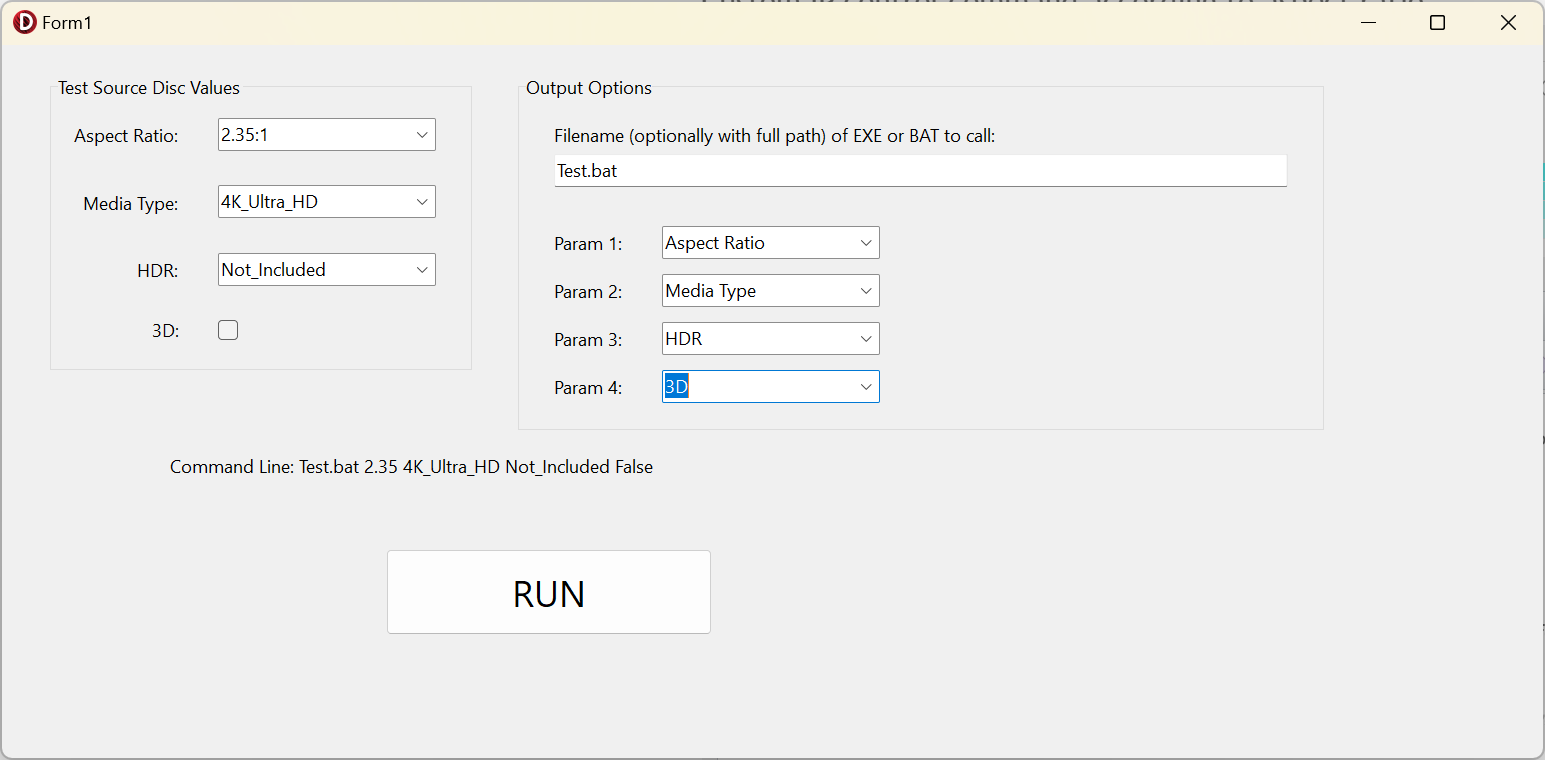

And here's the testing tool: DOWNLOAD
Essentially, this tool allows you to simulate how data would come from CMC. You can specify the disc values for Aspect Ratio, Disc Type, HDR and 3D. The values you can choose from come from My Movies, including values you would think are bad/non-existent.
NULL is a placeholder for null/blank values if they exist in MM, and since you can't really pass a blank on a command line as a param, I would text replace with the word NULL so you can interact with it in your batch file.
If the exe/bat is in the same folder, you don't need a full path, otherwise provide the full path to the file you want to run.
You can also choose what params you want to pass (in any order you want), up to 4 different params. The batch file I developed only has support for 1 param, Aspect Ratio, so this tool allows enough configurability to support whatever you want to do in the batch file.
Also, consider how this tool works - you choose from a set of values, in whatever order you want, to pass as parameters to an exe or batch file. None of this is specific to JVC, it's generic enough that you can call any bat/exe, and pass different vars in different orders. Add into this a trigger (i.e. on CMC Start, Playback Start, Playback End, CMC Close) and this is essentially feature complete code, just would need to integrate it into CMC with a healthy dose of polishing compound.
To expand upon this, instead of just those 4 parameter values, I could add dozens or hundreds of values from MM/CMC that could be exported. That way, when you want to do "something" external to CMC, but with CMC data and based upon a CMC event, you could configure an action using this to do whatever you want, not just change your JVC projector's lens settings.

Done some testing, as always you've over-delivered :)
The batch file works great, I've made a few changes:
- added support for 2.00 and 2.20 A/Rs
- added the aspect ratio corresponding to each command in the comments (those are valid just for me)
- corrected a comment that mentionned raw: in your example
- added support for 3D picture mode with 3D content, switching back to 2D otherwise.
- made a slight change to the limit between 2.35 and 2.40
- added a pause to prevent commands from being lost, the pause option in the utility is pointless, apparently it pauses before the command according to the doc, plus you have to use a /w switch to call the batch file. As expected, I needed 5 seconds but it might be more for some users.
Here is my modified test file:
